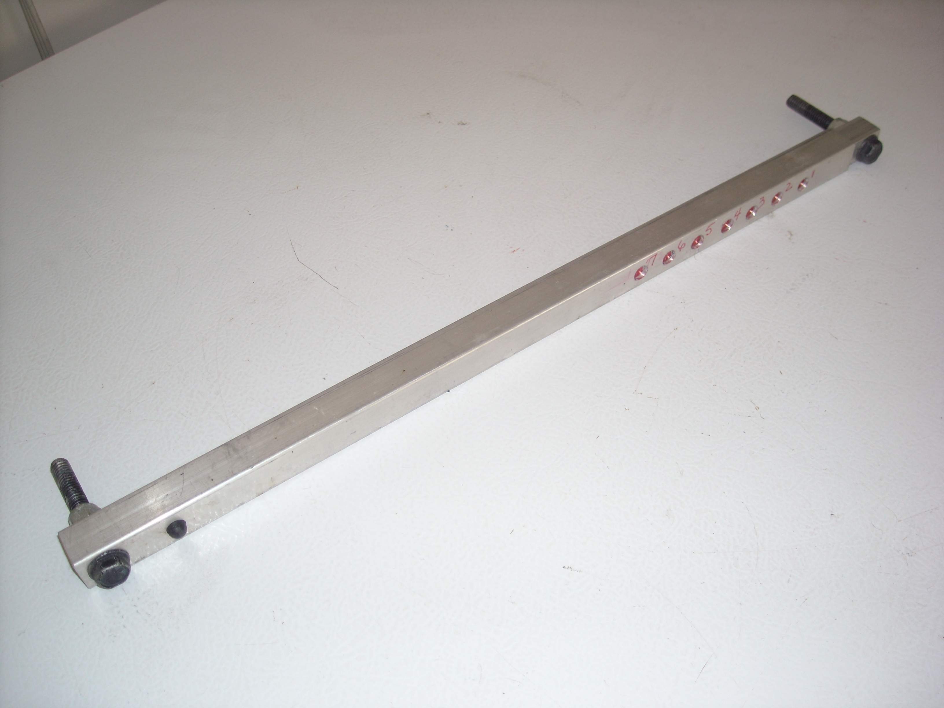

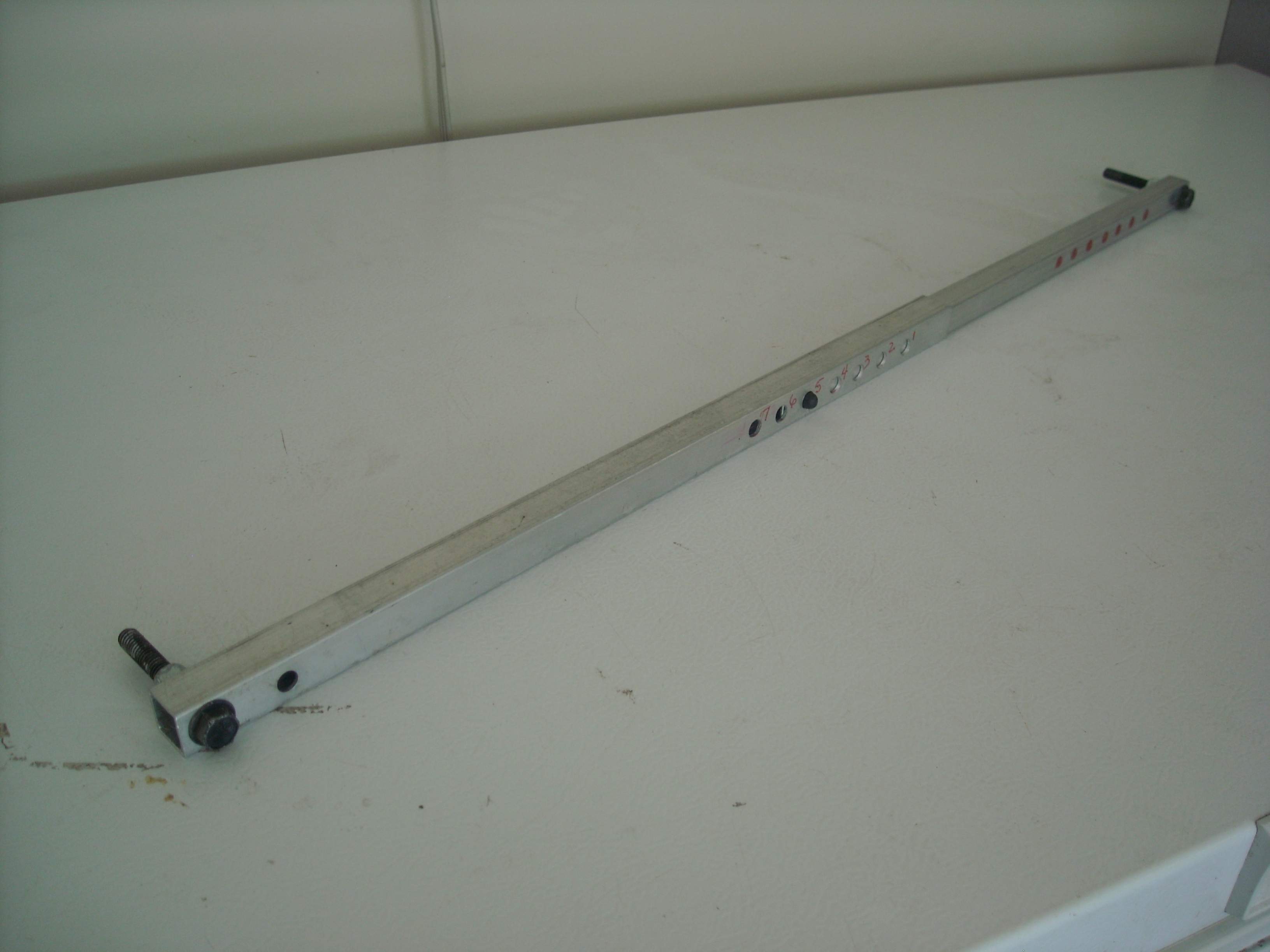

I am not sure what you mean by this statement. :confused: I have the Pat's and have been VERY happy with them. I think you will need some method to hold the 3 point's lift arms in place as you connect to the implement(s). PEC has a "spreader bar" to sell you....or you can use a length of 1" plastic pipe to spread the links as stated here earlier....and you can get by without....but its a hassle without some means to position the links when hooking up.
I just made my own telescoping tube setup as shown below. Just remember to remove and stow it away after your hooked up. The bolts at the ends will fit into the holes found on the PEC.
