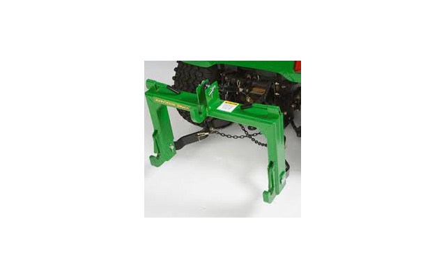

Today I went to pick up FluidFilm to JD dealer when I saw
John Deer Quick Coupler - KIT, QUICK COUPLER CAT 1
LVB25976
Which looks like Pat's Easy Change but it is a single piece so you do not need the stabilizing bar, and seems to be very well build and makes more sense than Pat's. The price was $357 which is very close.
Anybody has experience with it.?
I know the green will crash with the orange but...... I can always spray it ;-)

It's called a quick hitch and there are many brands and many price ranges (Deere probably being on the high side). You can get an orange one pretty easily if you look at other brands. Tractor Supply, Northern Tool, Agri Supply, etc sell them as well. Certain implements need to be modified to use a quick hitch, unlike the Pat's system.

Thxs s219.
The JD accepts 30" implements and extend the arms 4".
The hooks where the implements seats is very wide to accept different sizes and it comes with attachment that you can add to the implement to provide the correct diameter. Because is a single and very sturdy (at least is what it looks) I though can make the 3P stronger (imho) besides making the attachment easier.
But like you said if Pat's works with everything it may be the best way to go.
