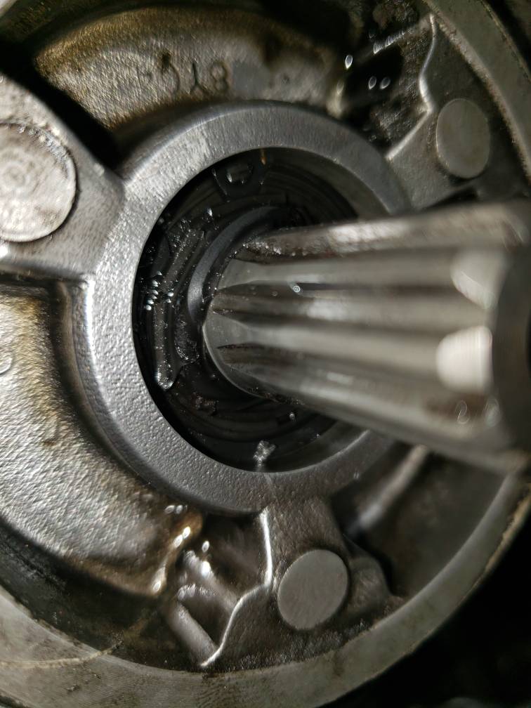

I would at least pull the pump appart while you have it off. The shaft seals are a low pressure seal, maybe a couple hundred psi max, any failure of the seals that separate the gear section from the case will cause the shaft seal to fail.
Its almost a guarantee that the pump that actually attaches to the engine is the culprit (typically this is the implement pump) if the rear pump fails it will usually result in an external leak or a performance problem.
Here's a picture of a shaft seal that failed due to the high pressure gear section seal failing. Had i just replaced the seal, it would have blown out again as soon as I activated anything in the hydrulic circuit. 1162804326.jpeg

Thanks for for your suggestions and the picture. Looking at that pic as you say, that is sure appears to be caused by excess pressure from some cause. If I see anything like that I will just go ahead and order a pump probably. The diagram for my pump does not clearly show any other circular seals. There is one part that looks like some kind of odd shaped part that is called a seal. I am tearing down today, shaft seals due at noon.
   / Path of hydraulic fluid to engine crank case. #10

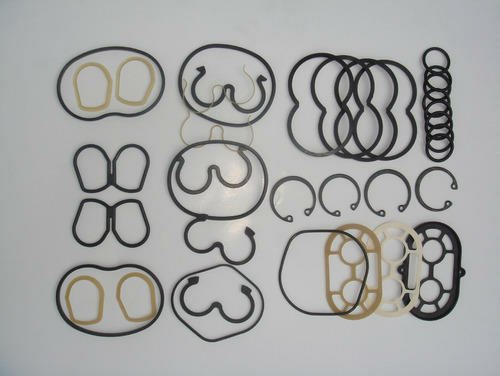

Most likely that odd shaped seal is what isolates the gear section from the case. The pump in that picture had that seal fail, it was made out of a urethane material and had hardened and started to disintegrate.
These are examples of some of the different internal seals. (The pump I showed used the seals on the far left for example).hydraulic-pump-seal-kit-500x500.jpeg
