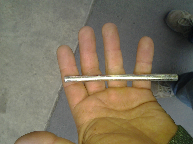

   / Patch or Plug??? #7
I had a tire shop both plug and patch a tire after he pulled this out of it. Its about 1/4 inch diameter....and came out of my honda car tire.
