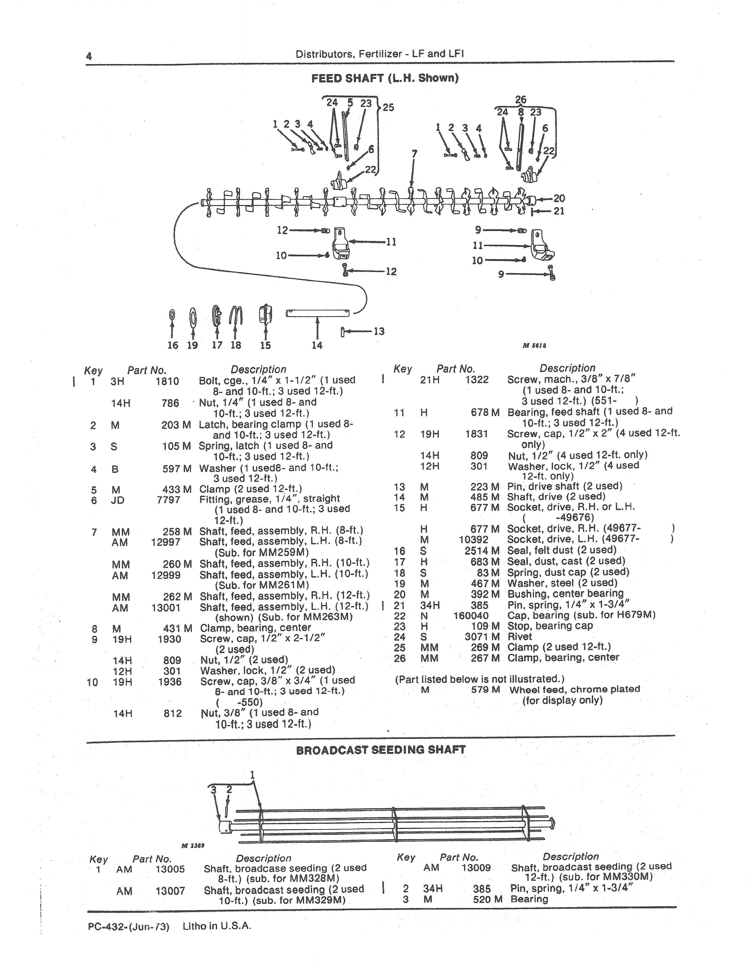

mixing seeds usaly does not work well, as the small heaver seeds will work there way to the bottom and not stay mixed, thus one nearly needs (depending on the seed) three boxes and seed cups, one for the very small seeds like alfalfa and switch grass, some larger smooth type of seeds, in a regular grain box, and the fluffy seeds, broam, blue grama, blue stem and Indian grass, and others that are similar, need some thing different, I use a old drop fertilizer spreader, (I made a seed basket, have heard they work on with the fertilizer feed, but never tried, it, I copied the basket from the John Deere, manual that goes with mine, or a special drill with fingered seed cups and agitator mixer
I use the drop spreader in front of a grain drill with the small seed box, on it pull both at once,

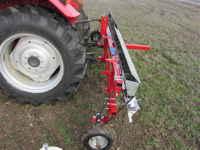

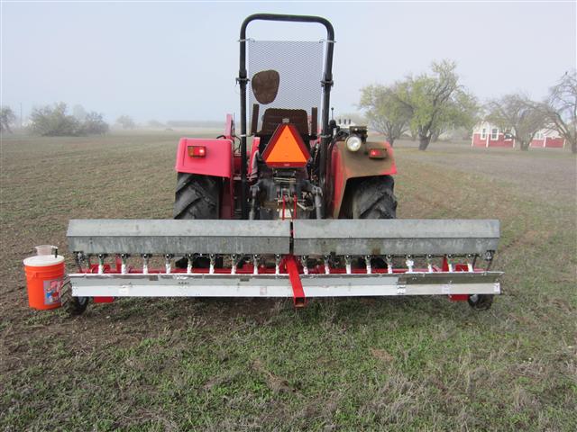

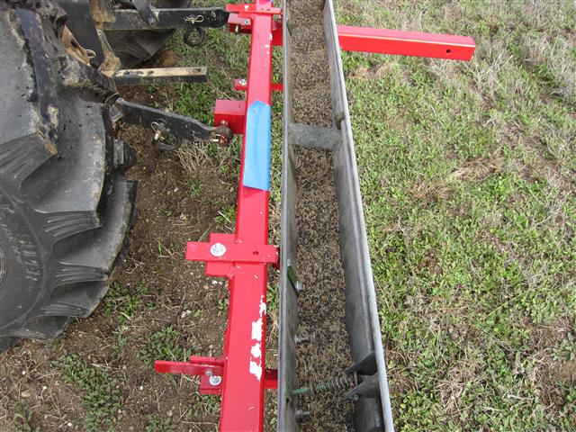

Several years ago I build a drop seeder out of a pair of 5-ft wide grass boxes that I salvaged from an old Minneapolis Moline P3-6 grain drill.
The grass boxes have 20 drops which direct the seed to a 10-ft wide two-bounce seed chute that distributes the seed evenly perpendicular to the direction of motion. There's a chain drive mechanism to operate the seed cups in the grass boxes. Use it to reseed my seven acre hayfield with cover crops.
Hope this helps.

the seed basket is basically a shaft and some round spacers with rods on it to push the seed over the openings page out of the JD manual on the spreader, I guess they call it different than a seed basket, they call it a "Seed Broadcasting shaft".
I could no longer find any of them in stock any where, so I made mine copying the fertilizer shaft for a basic idea and size,
