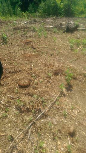

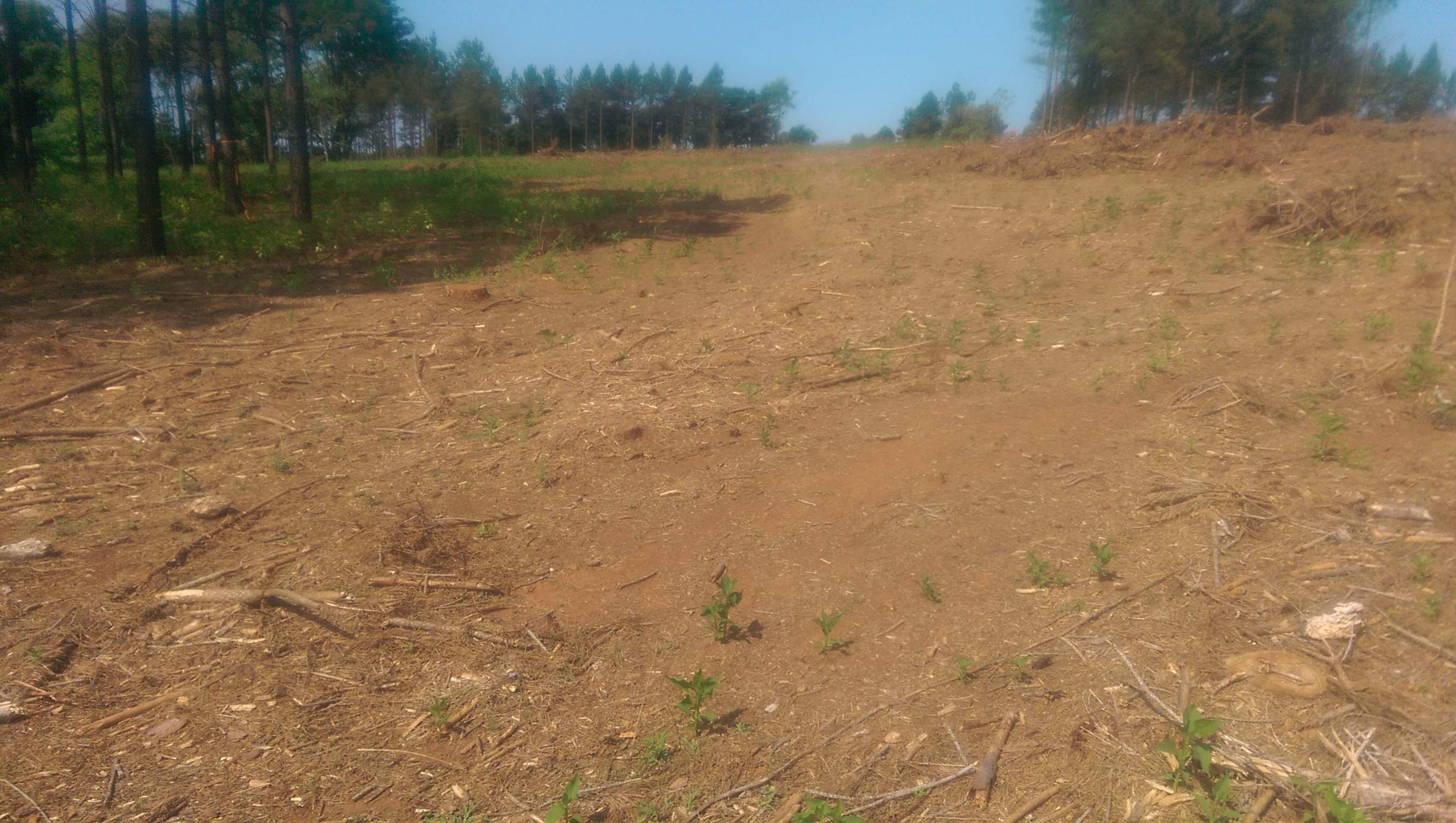

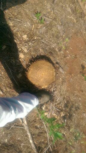

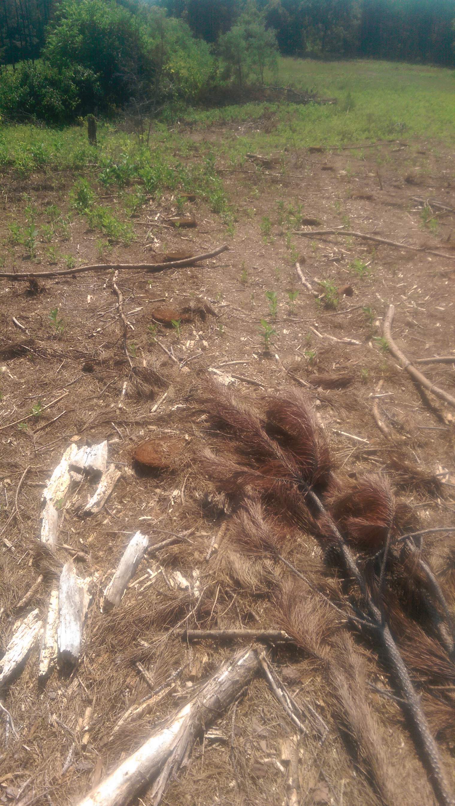

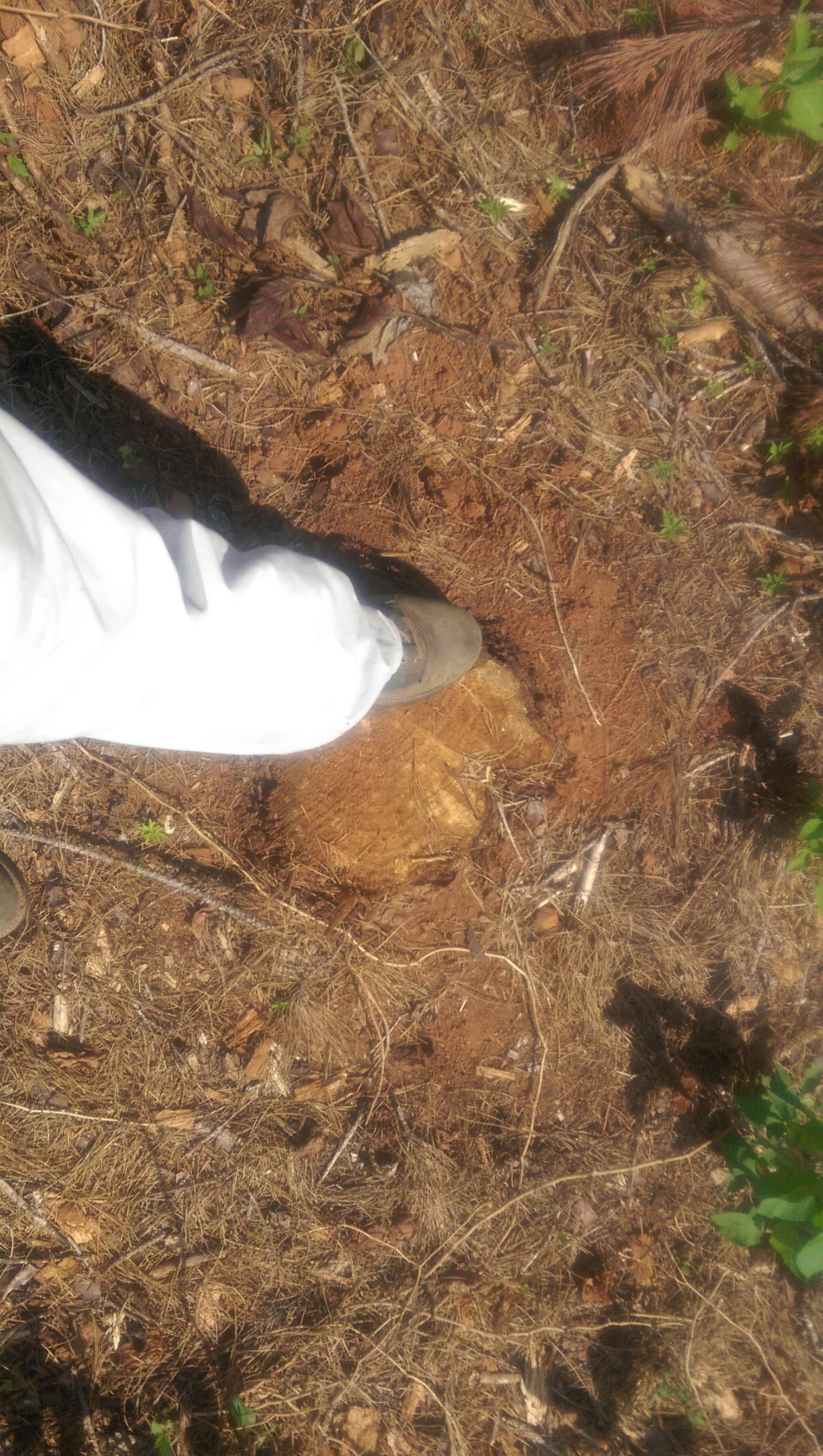

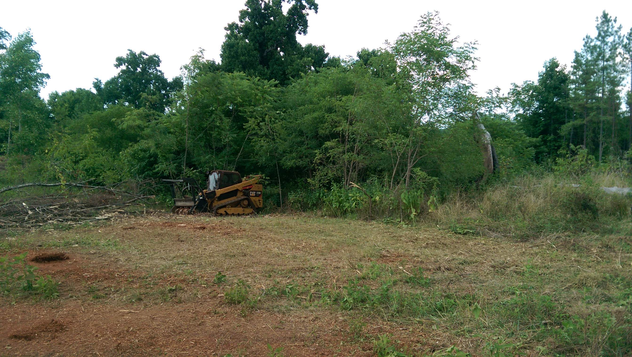

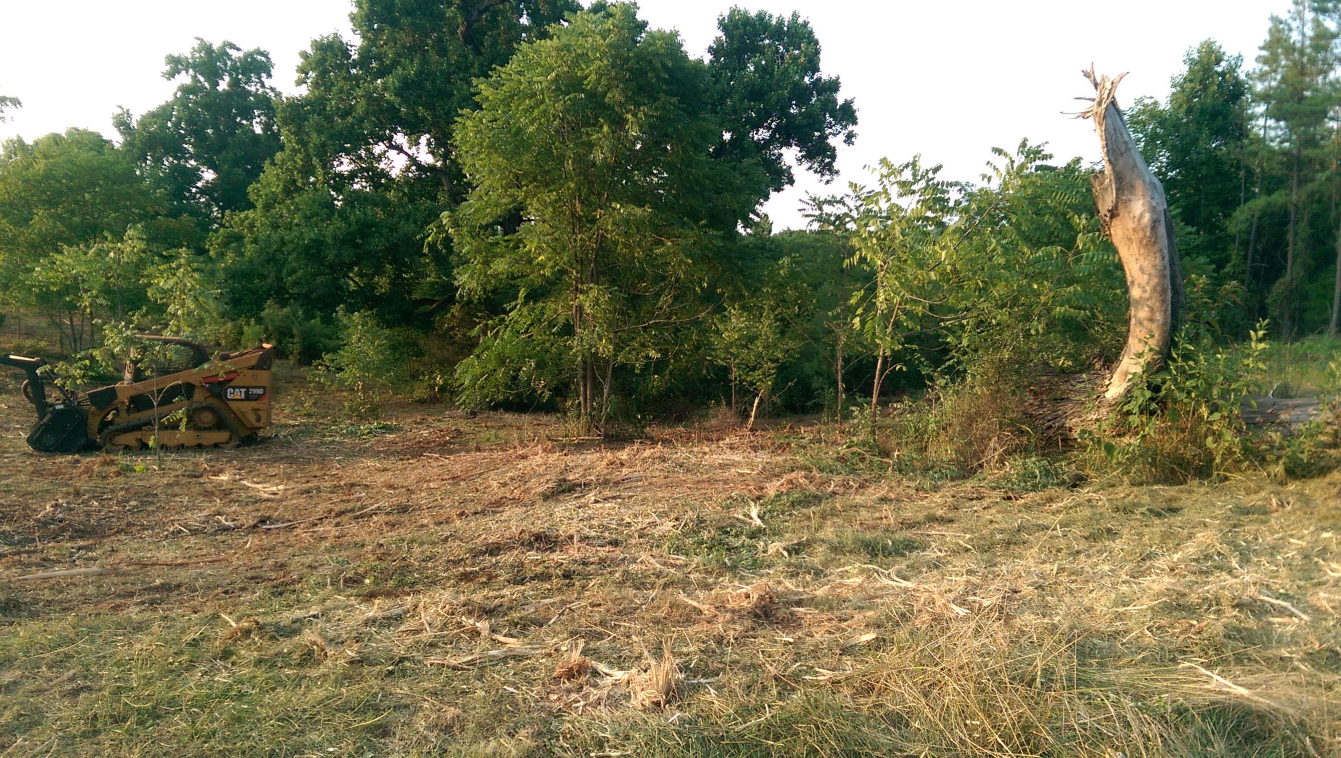

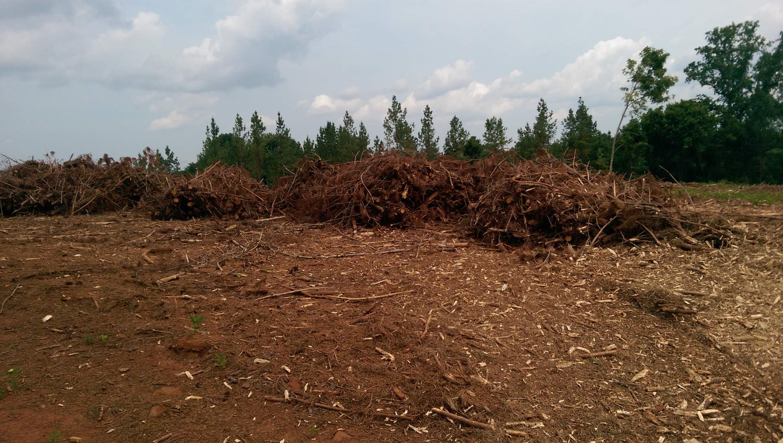

Here are the pics of the site. Almost no slash except for one long windrow of the tops and branches. All stumps are literally 2 inches tall. At most 3 inches. Some are so flat with the ground they don't need anything. The pine was planted 25 yrs ago all in rows. They want the stumps level not super worried about debris. They just want to be able to drive a fertilizer truck and a seed truck through fairly easy. They are going to plant this fall and they know its not going to be perfect. They have a few years to get the pasture correct. Total of about 15 acres of stumps. They want to do this all as organically as possible.

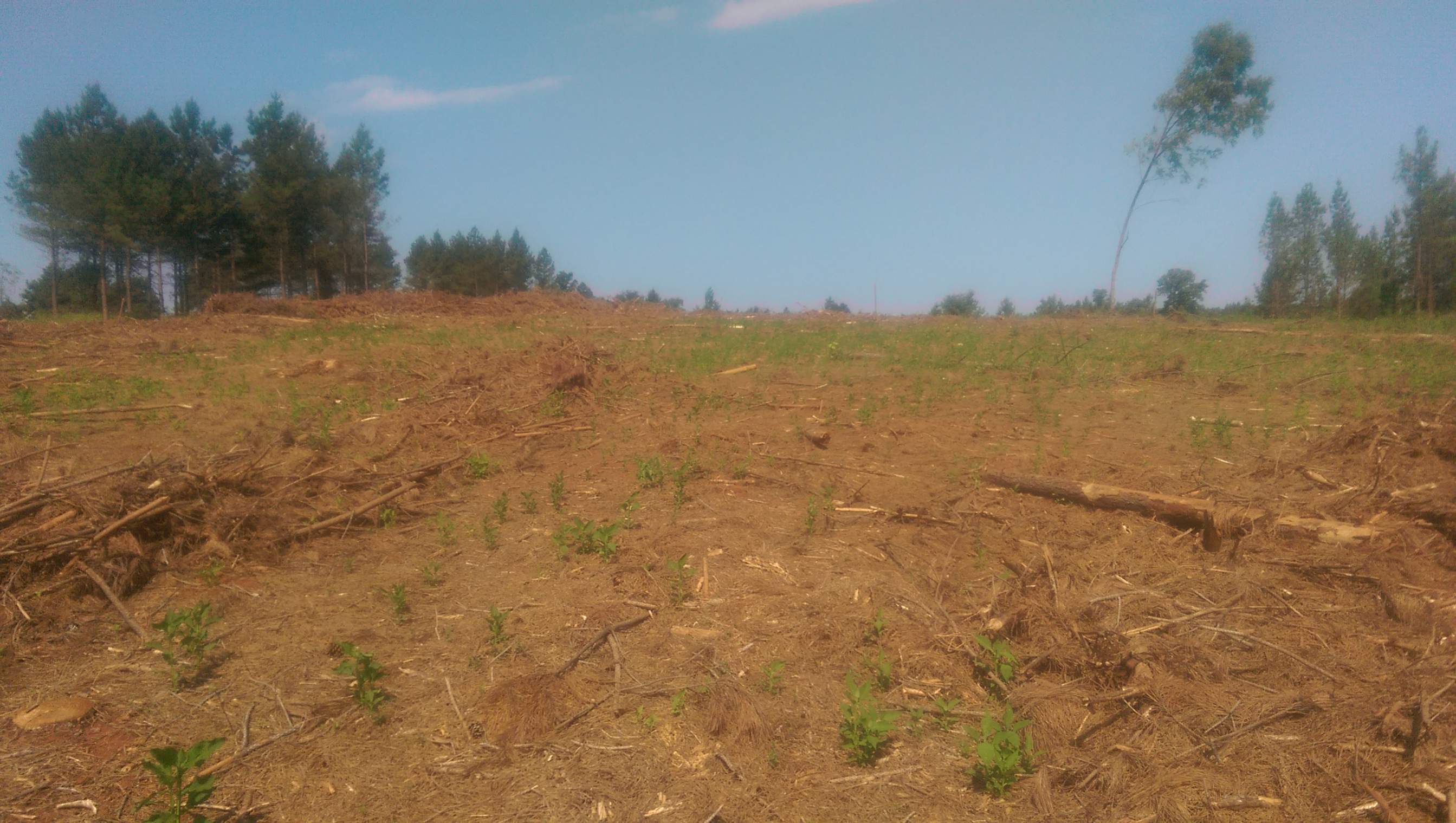

another pic of the stumps in a row

   / Pasture Renovation #8
I have cleaned up pine plantations like this using our mulcher and stumpgrinder. Usually I grind the stumps first just down 4" below ground level and can do about 100 stumps per hour. Then run over the whole job with the mulcher . Down here in Oz hardwood stumps if ground below surface level then left buried will not resprout so could be the same up where you blokes are.
#9
Tony, That is a good idea that I never thought of. The CAT store has a stump grinder for my 299. I could use that and probably with it being pine that was just cut I could rip through them pretty quickly and not put my mulcher through the abuse. Then back drag all the debris with my mulcher smoothing it out and cleaning it up some. Sounds like my best option so far. Thank you!
