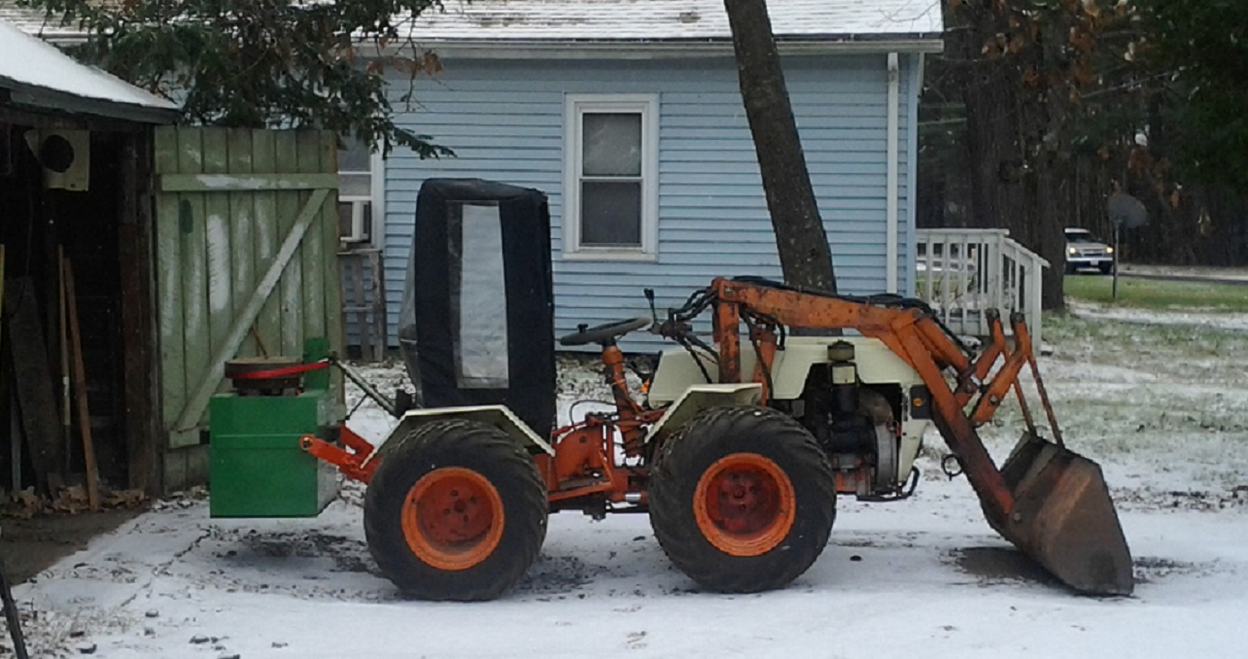

Pasquali 993 w/FEL, Economy2414 w/FEL
I've got a Pasquali 993 with the 30hp Ruggerini 2cyl, it uses old-school alternator with separate voltage regulator. Noticed after installing some aux. lights, that it was not charging the battery. Put load-meter on it, & at 2500rpm had 13.3vdc & 4.3 amp-output, at max rpm of 3000 had only 13.7vdc @ 5 amps. Saw in an old PDF manual that it should be 14.8vdc & 18 amp output @ 3000rpm. But the manual is very-vague as to whether to go after the voltage-regulator or the stator-windings/de-magged rotor.

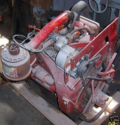

I will keep you in mind when spring comes around. I HAD to add auxillary lights, cause with the stock headlights & FEL, all you do is light-up the back of the bucket. So I mounted some 35w fog lights up high on my "cozy-cab" so I could see what's going on up front & a small backup light off the seat bracket for the 3pt.
I was thinking I might be able to fit a small 35amp alternator under the front-grill & drive the alternator off the pulley behind the hydraulic pump, (I believe it was the optional tach-drive pulley). That would give me more than enough amperage to keep things happy, that's if I can get it to fit without any serious modifications.

This is a picture found on eBay a few years ago...not mine at all. They made the setup a bit more complicated with the idler pulley so that they could continue to use the tachometer. I would bet the tach drive...like most... did not work anyway. I would be concerned that there is not enough RPM to run properly with such a small drive pulley.
