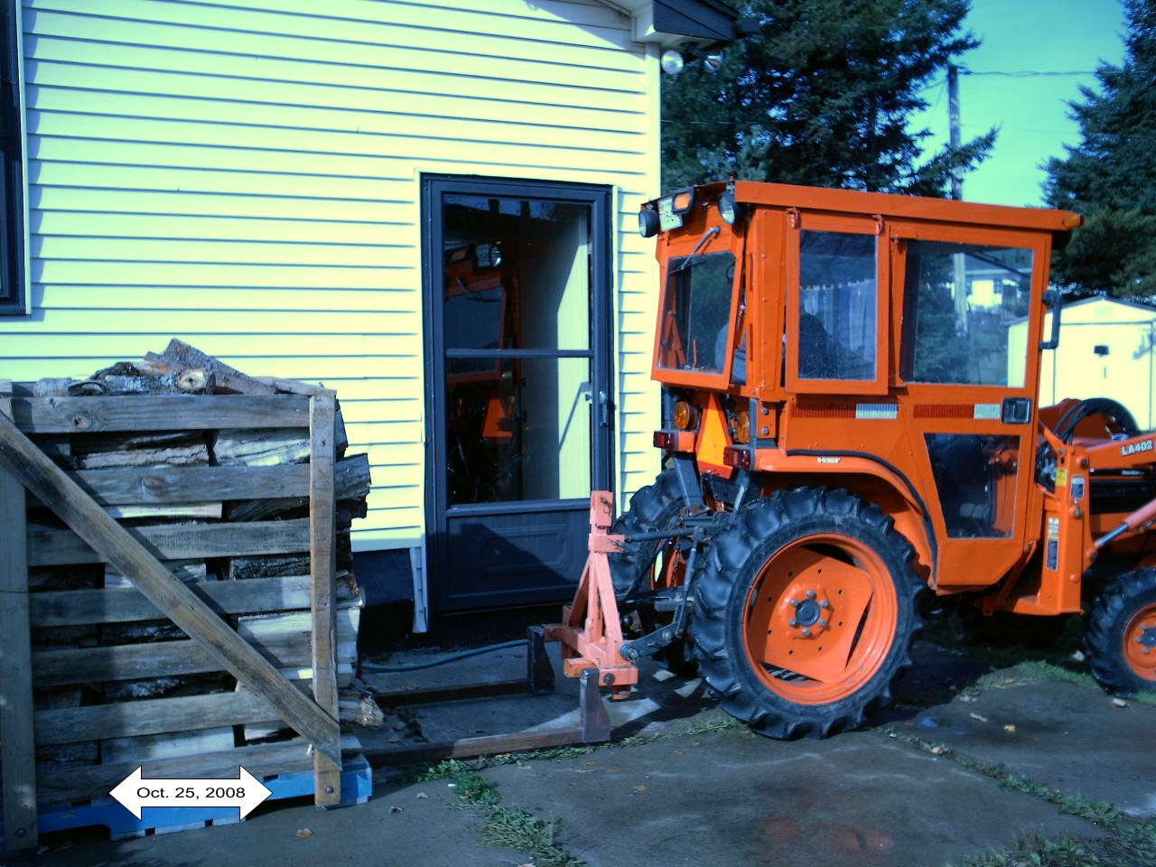

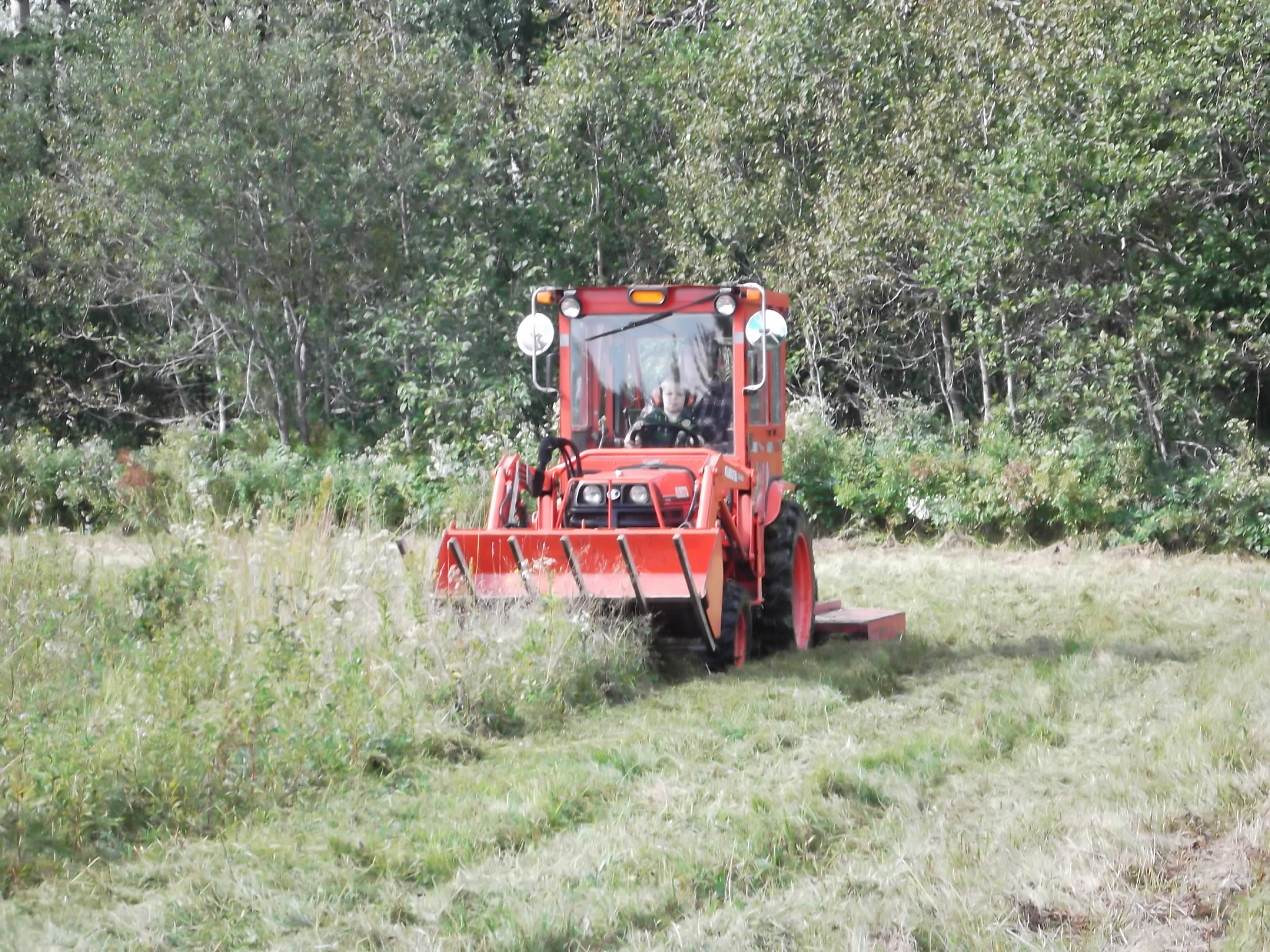

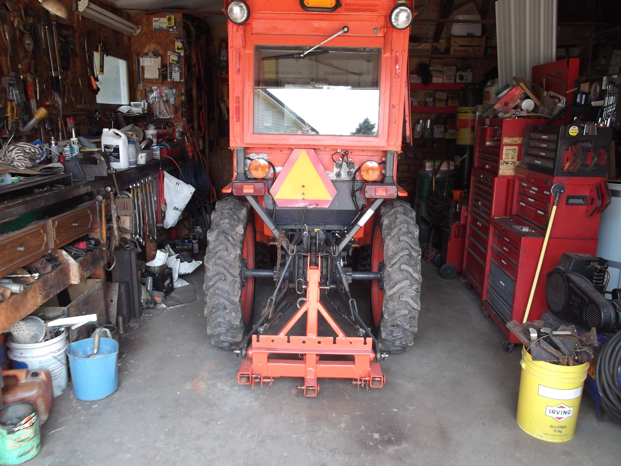

I built the cab on my B7800 eleven years ago. Like Chim, I built my own removable hinges, but using angle iron and 1/2" bolts. (Chim has a better idea with the pipes.) I used door latches same as in Chim's link, but I got them at Parts for Trucks (they have branches all over NB and NS). A lot of parts I stripped from a Mercury Topaz car that was being scrapped: front windshield wiper and switch which allows automatic park (I modified the wiper linkage and wiper arm), fuse panel, cab headliner and dome light, weather seals, etc. I had no space to put a scavenged wiper motor and linkage at the rear window, so it pained me greatly to buy a packaged compact unit for a Curtis cab. That was the most expensive single item in the whole build (about $180 IIRC). I got it at a local agricultural aftermarket supplier.
I recommend laminated safety glass all around. Tempered glass will shatter if hit, laminated will crack. I used laminated at the front and rear and plexiglass on the sides. The plexi scratches easily and gets foggy in time. I have since replaced two plexi side windows with laminated glass, and will eventually have laminated all around. I got the front and rear laminated safety glass eleven years ago for $40 through a friend who worked at a glass warehouse. (They cut them from damaged sheets.) Since he has moved to another job, I got the two replacement side windows from Apple Auto Glass, cost about $125.

Here are three pictures I have posted here before. I may have some better ones, but they are on another computer I don't have access to right now.
Years ago I had posted some pictures from the build on the picture gallery here on TBN, but when the site got upgraded some years ago they disappeared.
