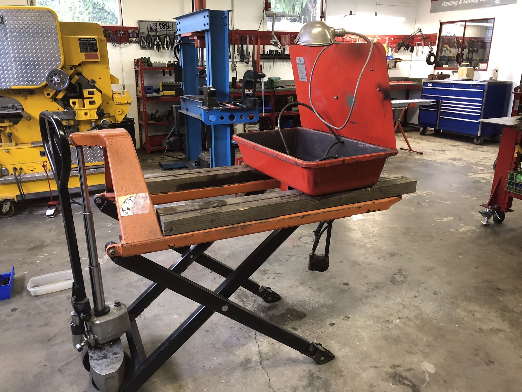

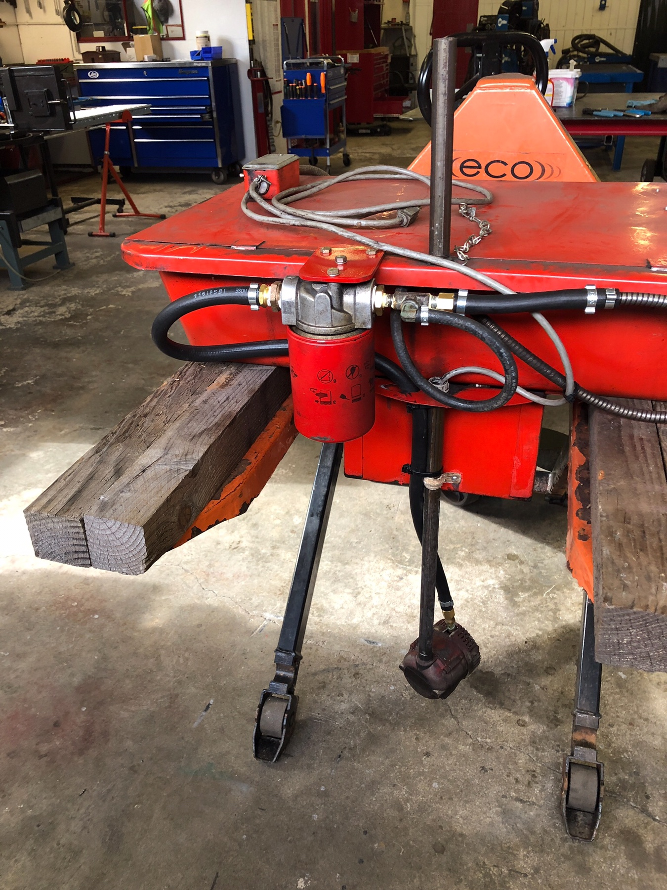

I’ve used oil based solvents in my tank for over 30 years.
A couple of weeks ago (no one can call me impulsive) I finally added a remote filtering system to (hopefully) extend the cleaning life of the solvent.
   / Parts Cleaner...what does everybody use
View attachment 573486View attachment 573487
Nice setup ! Is that the original pump or did you get a pump for oil based solvents ? What is the filter system you made
   / Parts Cleaner...what does everybody use #4
Everything about the tank including the pump is OEM. The only thing upgraded is that filtration system.
I had the remote mount filter setup salvaged off a hydraulic system years ago. They are readily available online and at automotive retailers. Usually around $30. Get one that accepts standard off the shelf Ford-GM etc engine oil filters to keep replacement cost down.
The only other items you will need are appropriate fittings and oil resistant hose. HTH
