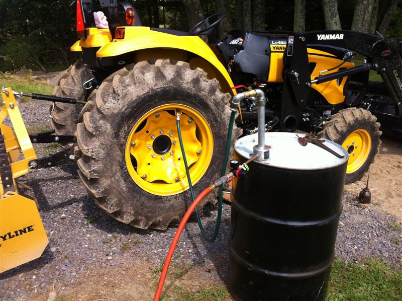

Are there any corrosion problems with partially loading tires with a methanol/water mix? I know with Calcium you shouldn't and Rim Guard you can.
I was thinking about going the methanol route because I have a partial barrel leftover from when I was making biodiesel, I figure it would be a good way to get rid of it. I'm both unsure that I need to fill the rims or that I have enough methanol fill them at the proper ratio.

No, shouldn't be a problem. When properly loaded the tire should only be about 3/4 full. I've seen many, many tubeless tractor tires broken-down at our Co-op that are loaded with methanol that the rims looked brand new inside still (including mine).
   / Partially loading tires with methanol/H20 #3
ditto what skip said. .. and remember.. you just have to have enough methanol inthere to prevent solid freezeup.. slushy is fine..

I got it done yesterday, it turns out I had enough methanol to fill both tires with a 30% solution. That should get me to -15 degrees, I hope it doesn't get any colder!
I used a pneumatic barrel pump from Harbor freight that moves the fluid by pressurizing the drum to 8 psi, and a hose adapter from TSC to get the fluid into the tire. It was a little slow for 47 gallons per tire but it did the job. :thumbsup:

It will feel like an entirely different tractor with the loaded tires.
At least it did when I got mine filled.
