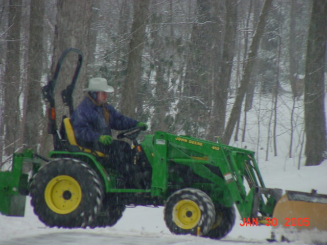

Everything works as expected, no troubles at all. Here is a pic in the latest snow we had, only about 2". Last week we had 7" and it worked great for that also.

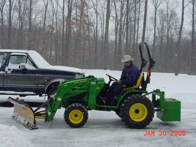

Another action shot...

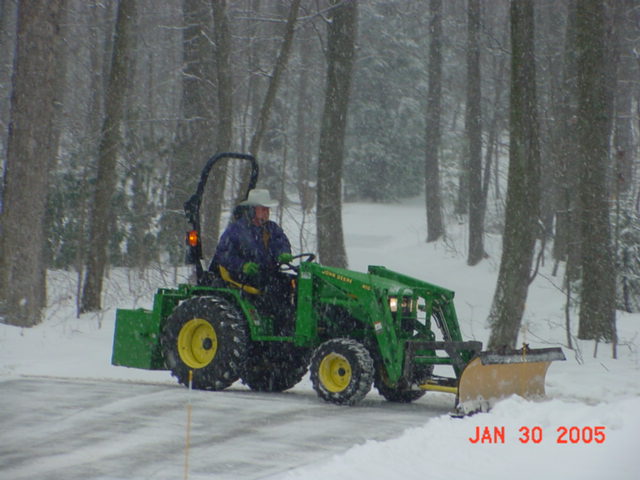

One More...

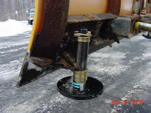

Here is a shot of my updated skid shoe setup, I was not happy with the original design. Now I can use standard Western replacement shoes. There are available at TSC for $16.50.
