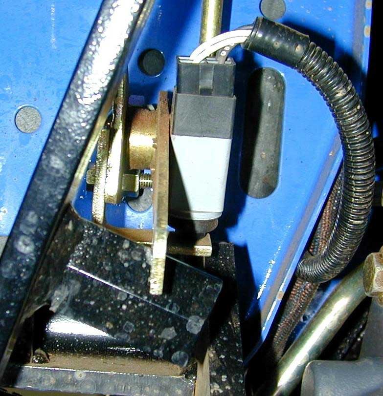

I got a chance to spend a while laying on my back looking up at the brake pedal linkage and the parking lock arrangement.
What I saw seems to be the root of the occasional unlocking some of us have seen.
The locking lever is parallel with the centerline of the tractor ( front to back ). The brake linkage, however, angles away from the centerline about 20 degrees or so. When the parking brake is engaged, only the corner of the tooth engages the bar stock welded to the brake linkage.
I'm going to look into heating up this toothed part and rotaing in the match the angle of the pedal. You can't turn the whole assembly because the handle linkage and switches will be out of whack.
If anyone gets a chance...crawl under and look up and see if you see the same angle conflict.
TBNers....re-engineering tractors one piece at a time !!!!

Here is the angle mine is at. So far no problems with it coming unlocked. Knock on wood...

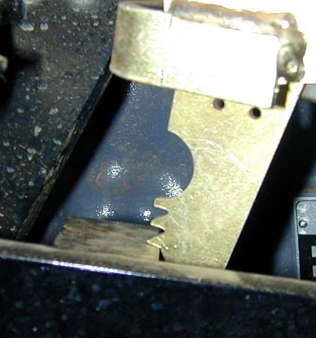

From the side view you can see the tooth is completely engaging the bar stock. Does yours not have this much contact to it?

Mine doesn't seem to engage quite as well as yours. In fact, the chamfered steel welded to the brake pedal has a bit of a divot chewed out of it where the link engages it.
There is quite a bit of slop in all the lingage points and I have to believe that the accuracy spec on that brake pedal weld-on isn't the tightest.
I'm gonna put a twist in my toothed link and align it with the brake thingy. I figure if it doesn't work, I'll have to either flatten it or just buy a new part. I think its wothwhile for the security of a proper lock-up on the brake.

As I posted previously, the pedal pawl pivot bracket needs to be adjusted to the rear. It is not necessary to bend the pawl itself. A minor adjustment of the bracket where it is mounted to the floorboard will allow the pawl to fully engage the rack on the pedal. The posted photos show full engagement which is proper.
