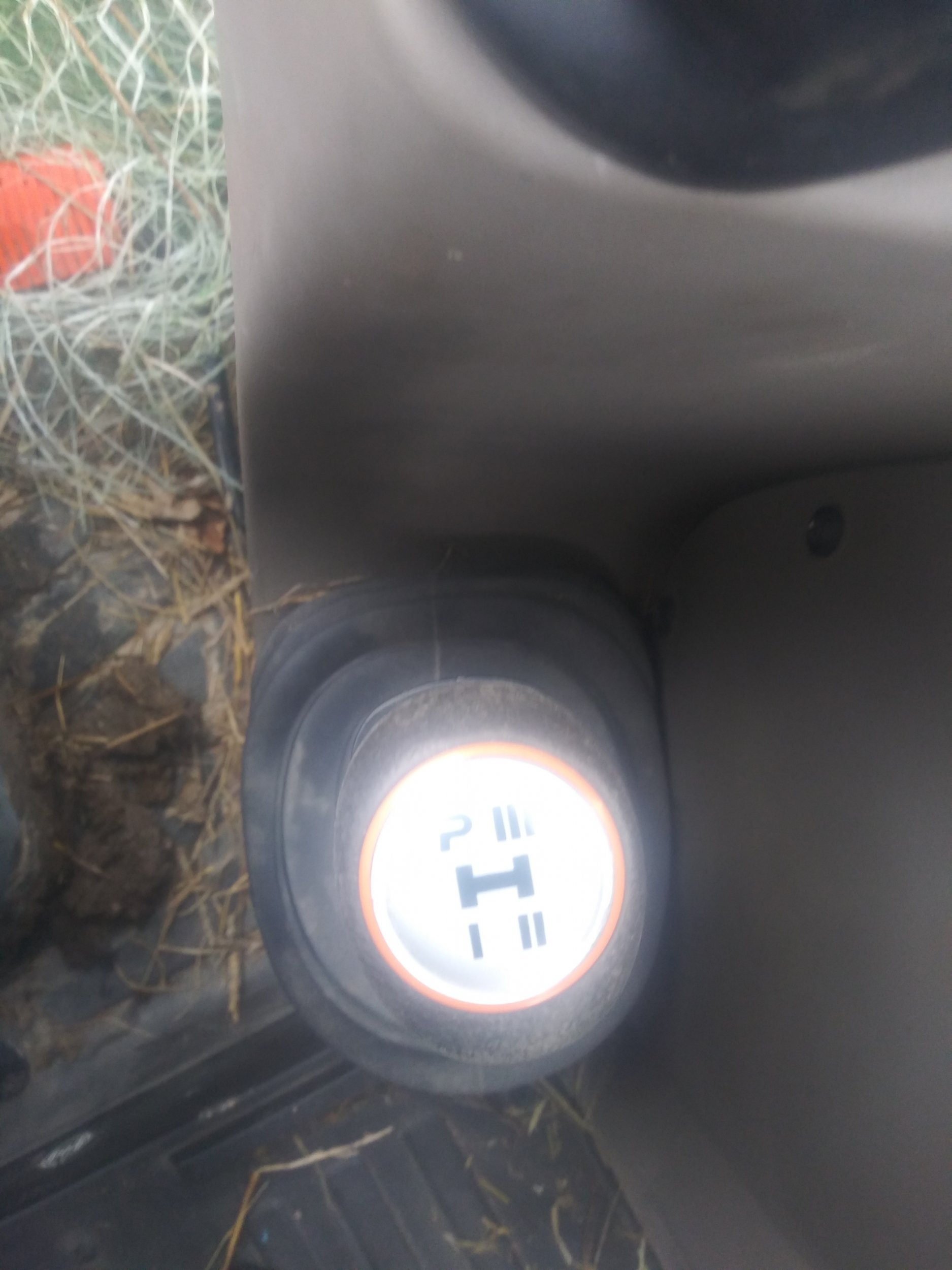

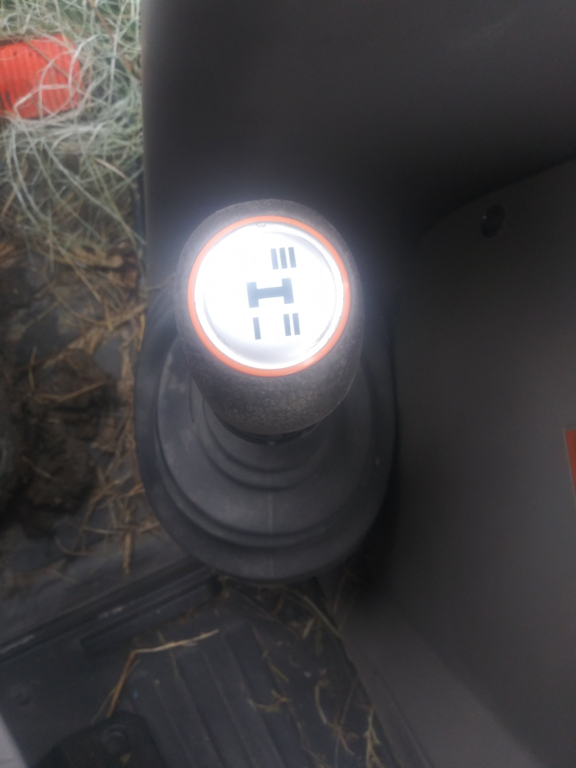

Hi everyone i have a question about the parking brake on a case ih 75c but im sure some other farmall series will be the same and possibly the same problem. depending on where i stop i am not able to put it in park or once in a while into 2nd range without moving it some anyone else have that problem and know a fix thanks rick

Here is what my shifter with parking brake looks like

Looking at the parts diagram, I see that it uses cables on the shifters. I would lean towards the cable for the range shifter needs some adjusting as Park and II are both on the upper side.

That's actually good. The binding would be easily noticible if the problem was caused by drivetrain windup in 4wd.
So from your description I'm inclined to think that "Tractor Tec" has the best idea with his adjustment of the shifting cables.
But even adjusted perfectly it can still be normal for range shifting to need some jiggling of the lever coupled with a bit of motion and some nudging to get the gears to engage smoothly. Range gears are not synchronized, so they have to physically line up in order to slide into engagement.
Probably not a problem. Get it adjusted someday if you run across a good experienced tech. Until then, I'd say you are treating it right.
