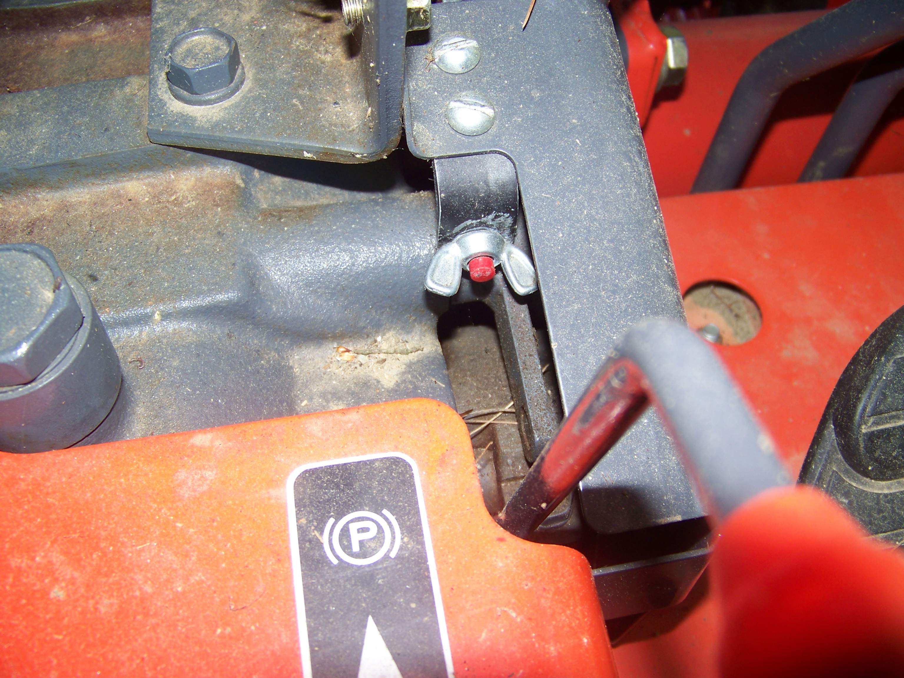

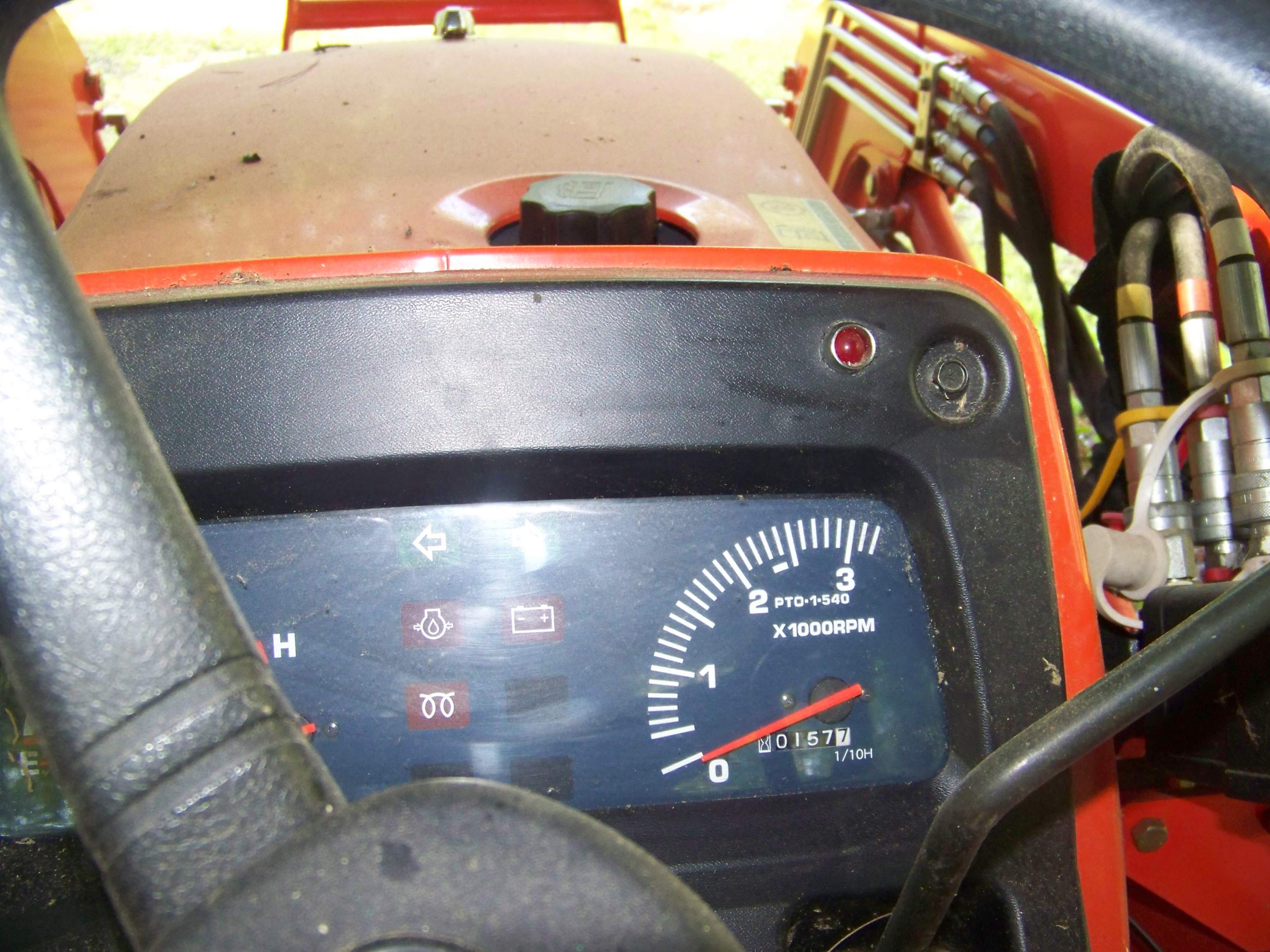

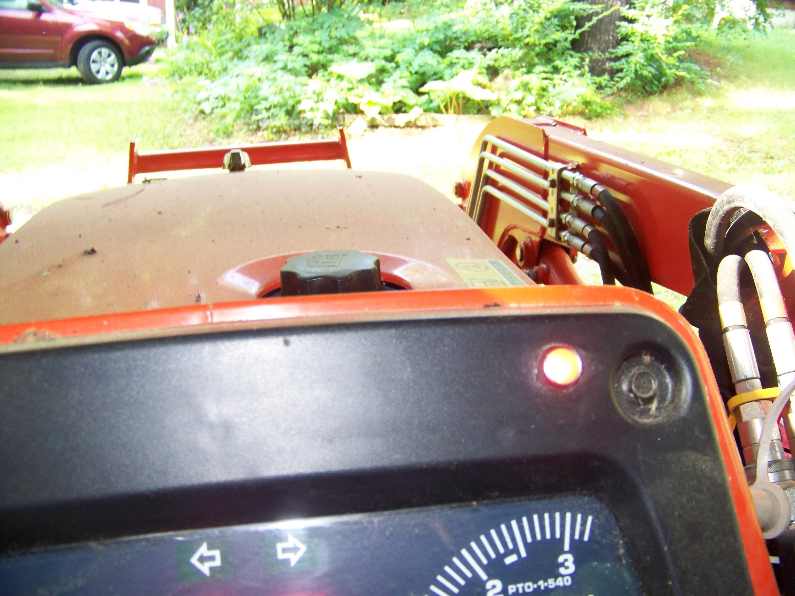

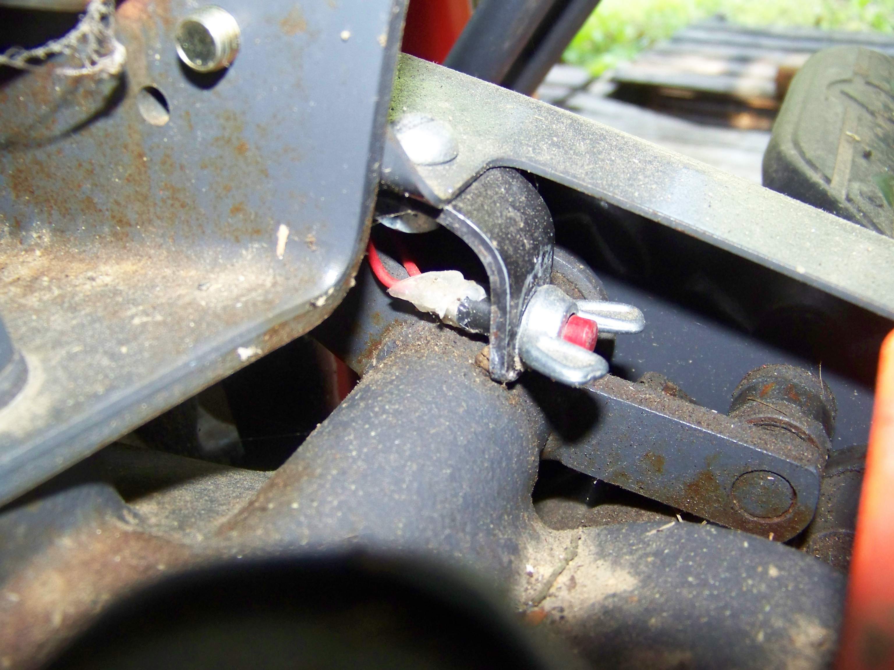

   / Parking brake for L2800DT #7
I put an indicator light in the black trim panel above the guages, and used a threaded momentary on switch and made a small bracket for it.
   / Parking brake for L2800DT #10
Charlie, was there a specific reason to use the wing nut?
