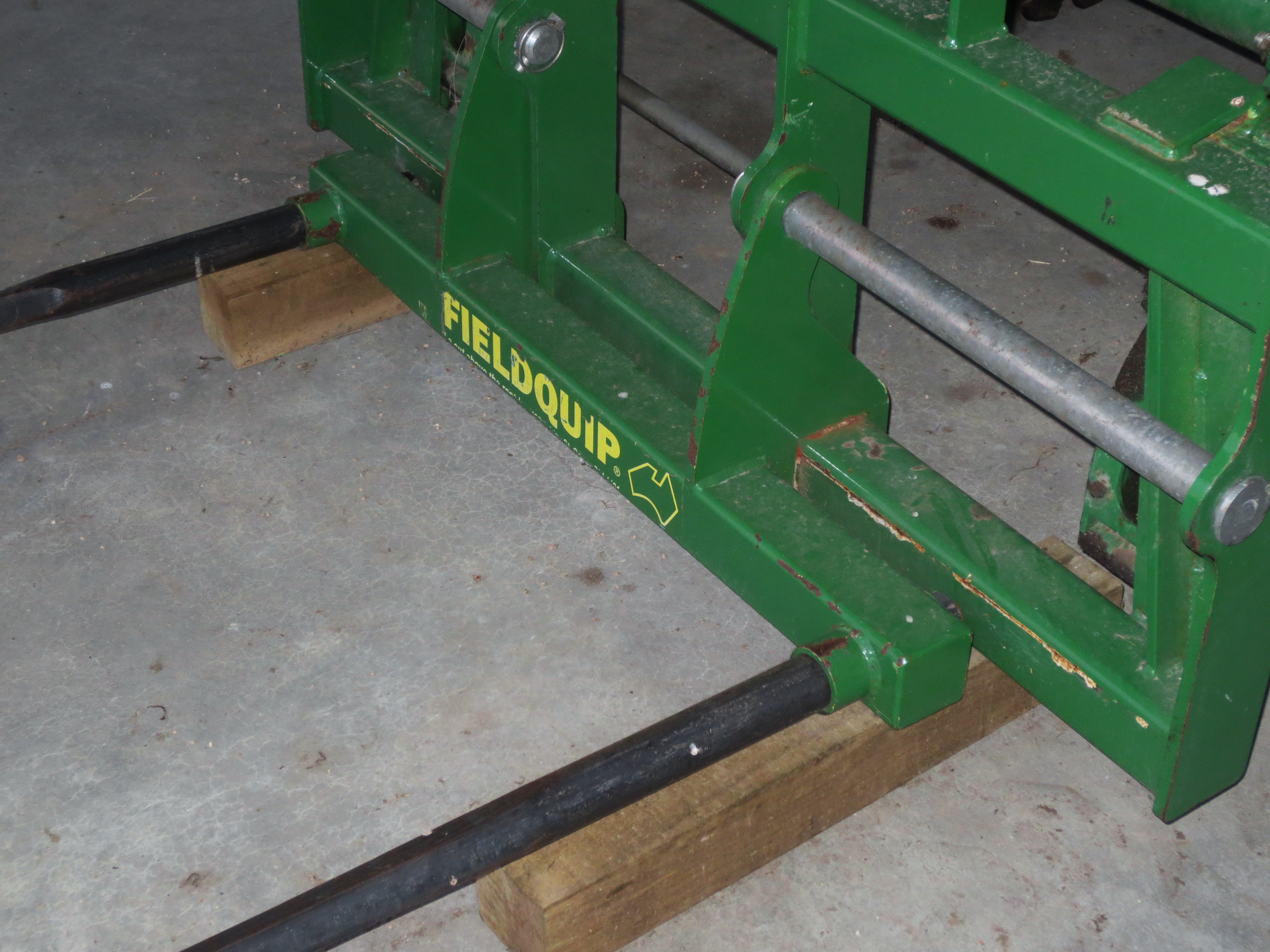

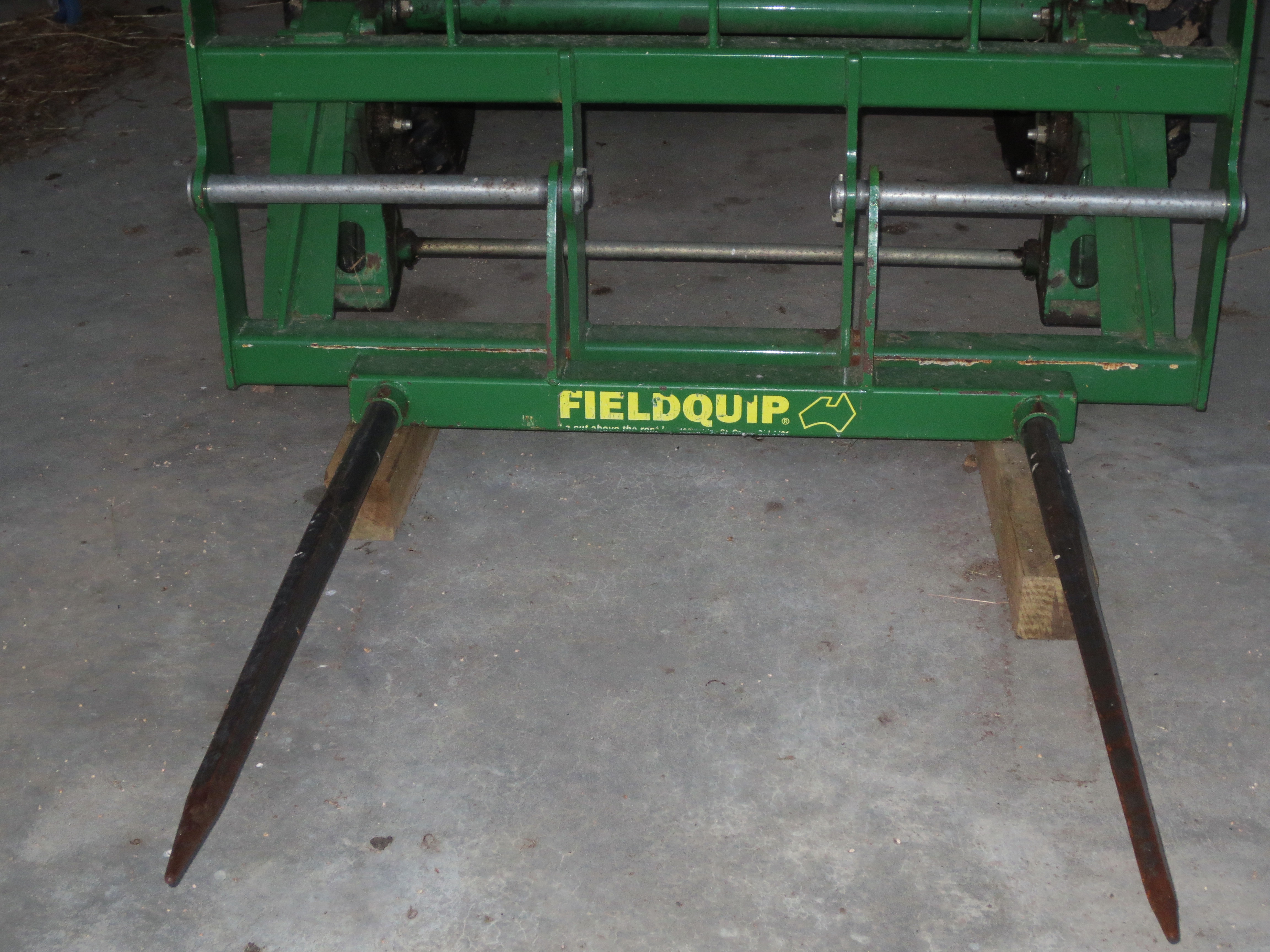

I'm with N2DFire. I have a combination/swap-able bale-spike/pallet-fork for my FEL. They are easily interchangeable, although I'm the opposite and my spikes are mostly 'on'.
There are several designs out there.
