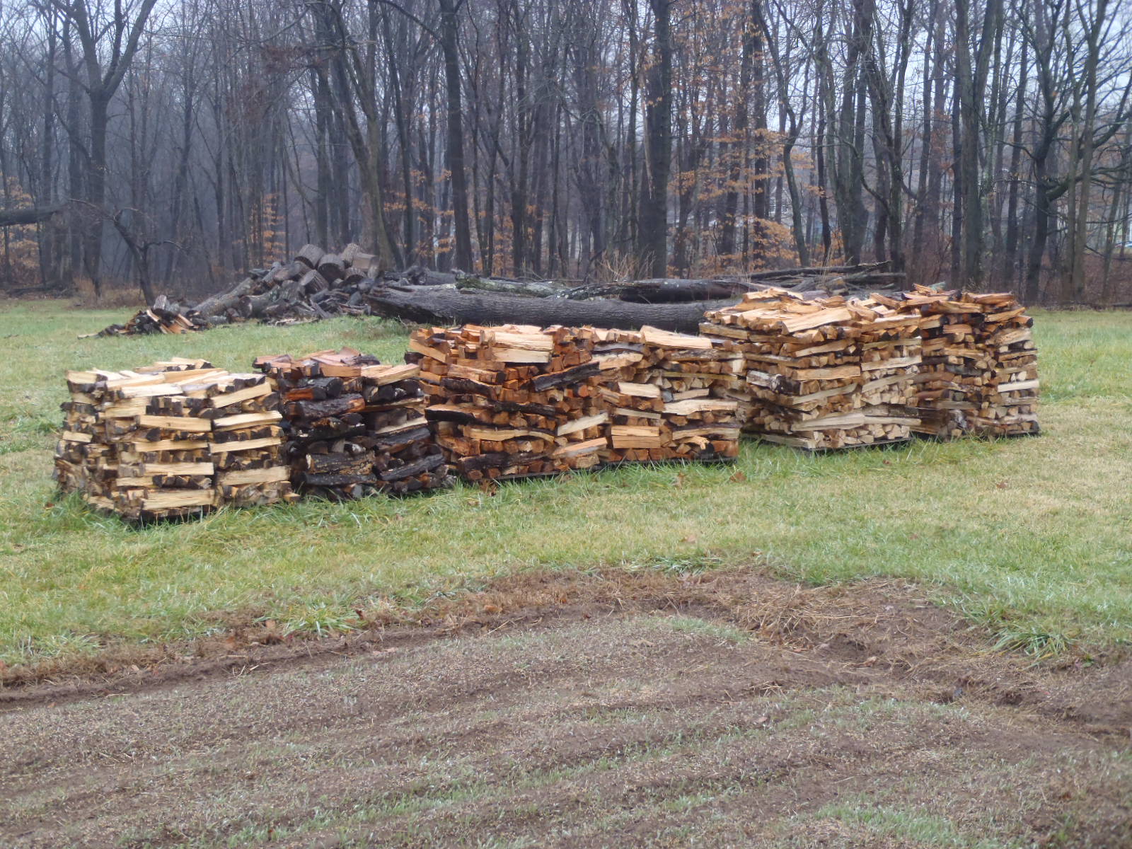

No need to sell your tractor. Top and tilt (T&T) will transform your 3pt hitch. I use forks on the rear of my tractor all the time and with the T&T there's no hassle. The only real limitation is lift height, but if you don't need to unload pallets from a truck or stack pallets, who cares? In addition, T&T will make a box blade or rear blade a much more productive implement.
I season my firewood on pallets. When I need more for the stove I bring another pallet over to the house. Works great.
