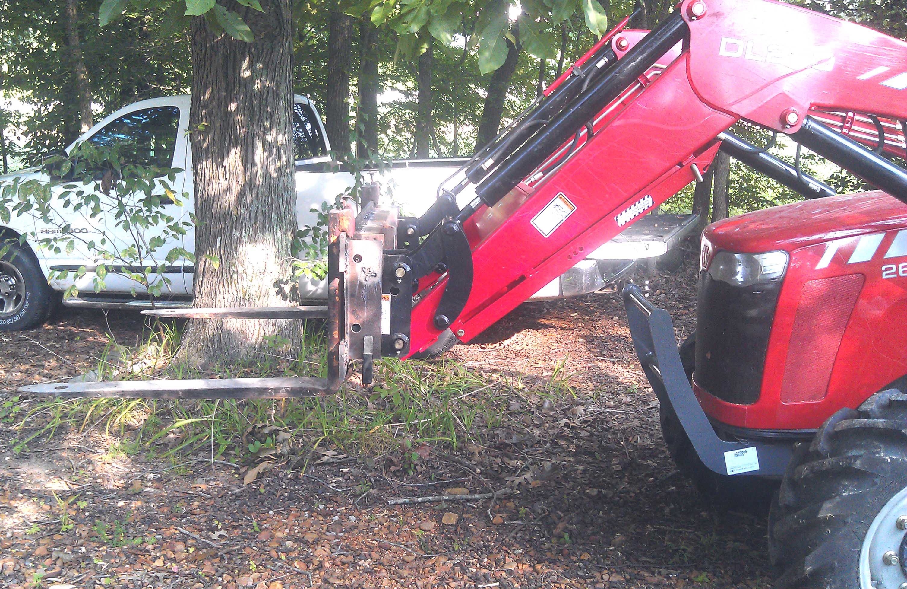

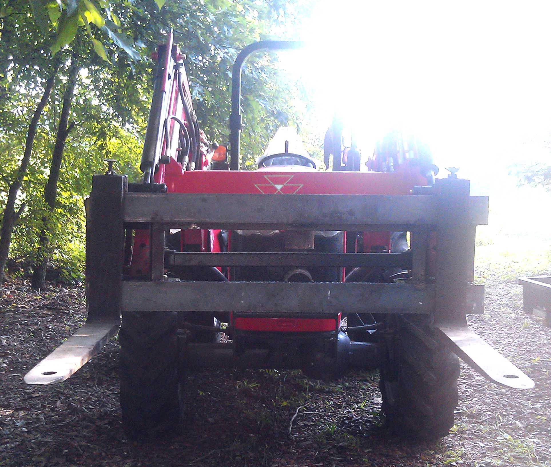

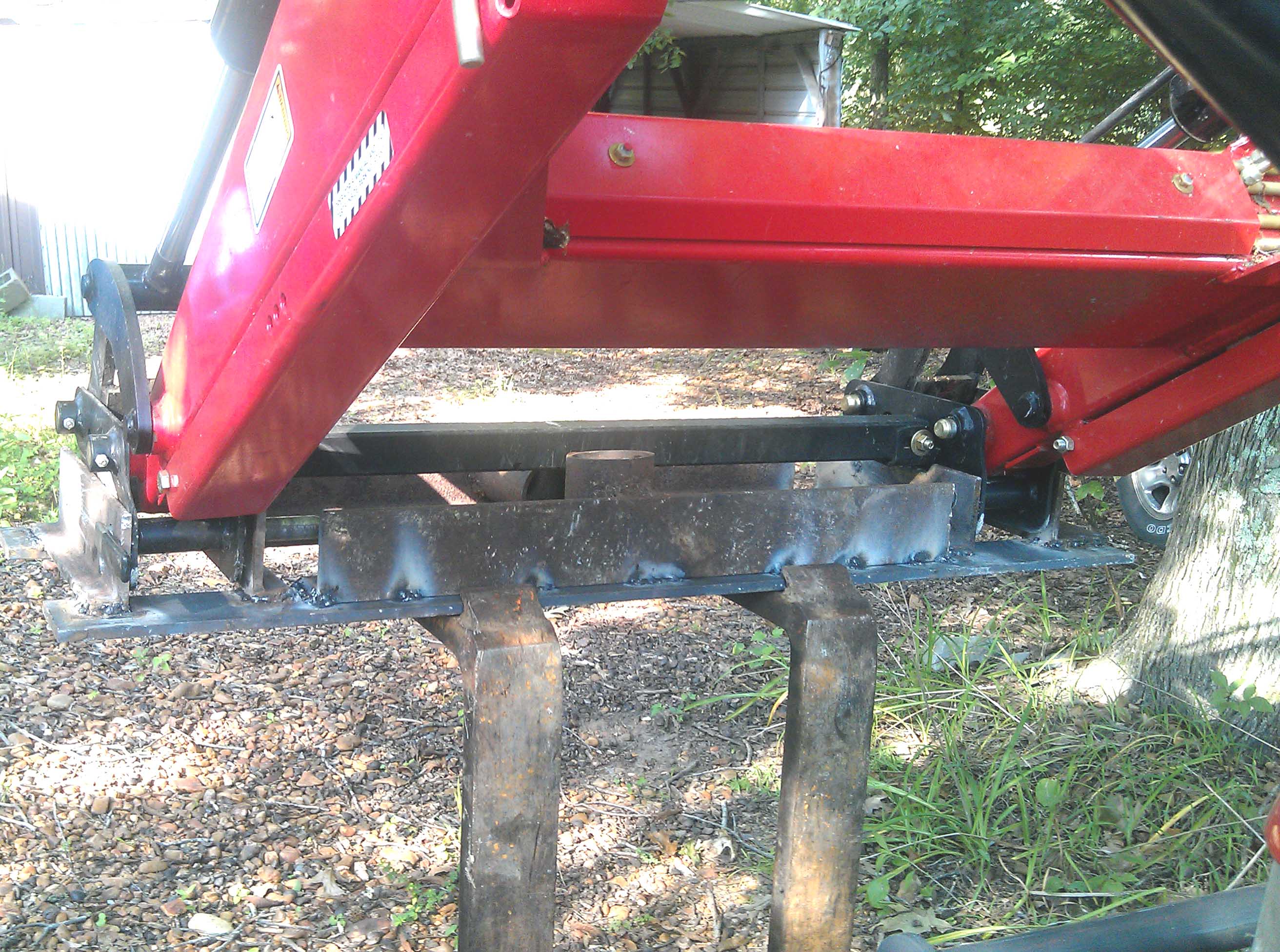

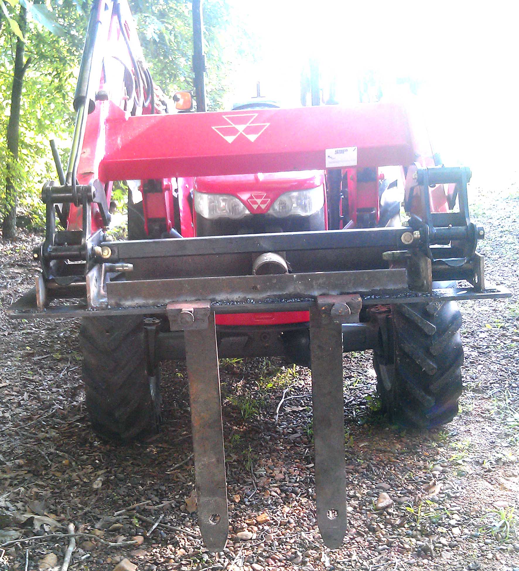

Not pretty but finally got the pallet forks finished. Have been contemplating them for a while. Bought the forks about a year ago. Used 3/8"X4" angle, 1/2"x5" flat steel, 1"dia round stock (for upper pins), a set of used tow-motor forks and several welding rods.

Nothing a little paint won't fix. They look good!

look nice...but you might add a small roll cage like unit around the rear skid plate to prevent anything from rolling over the plate and hitting tractor.
   / Pallet forks #9
Nice job. Saving money over buying and ending up with a very useful tool is always good.
   / Pallet forks
U are right and its on my todo list.
