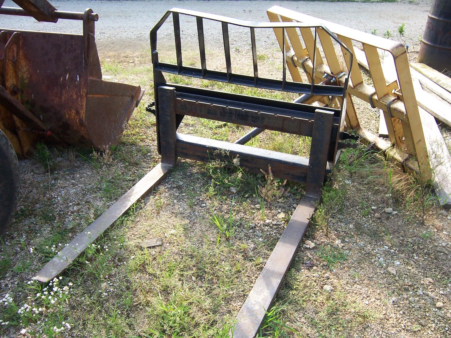

Will this set of John Deere pallet forks with whatever type of QA it has work with my Bobcat CT335 QA plate and lock on?
Seller says it will work with skid steer and I believe the CT335 uses the same plate as the skid steer.

It is not obvious to me that those forks are skid steer QA.
I would have to see a picture of the back of the forks to be certain, by my SS QA forks have holes in bottom back bar for the QA pins to lock into.

thyey do not appear to be QA forks from the front, but who knows.....

Not sure it they are QA or not but they definatally look like they were made for a SS given the step on both sides.

I'm working on getting a backside photo.

That really looks a regular skid steer fork with side step and will work with your CT335... but will be certain if you can have the back picture taken and post here as others already said.
I talked to the guy today and he said the mount has the hook plate at the top and the hole for the QA pins at the bottom just like a BC quick mount needs. I will have to take a ride up and check them out for myself.
