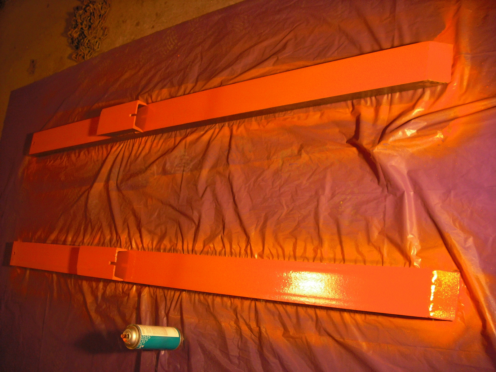

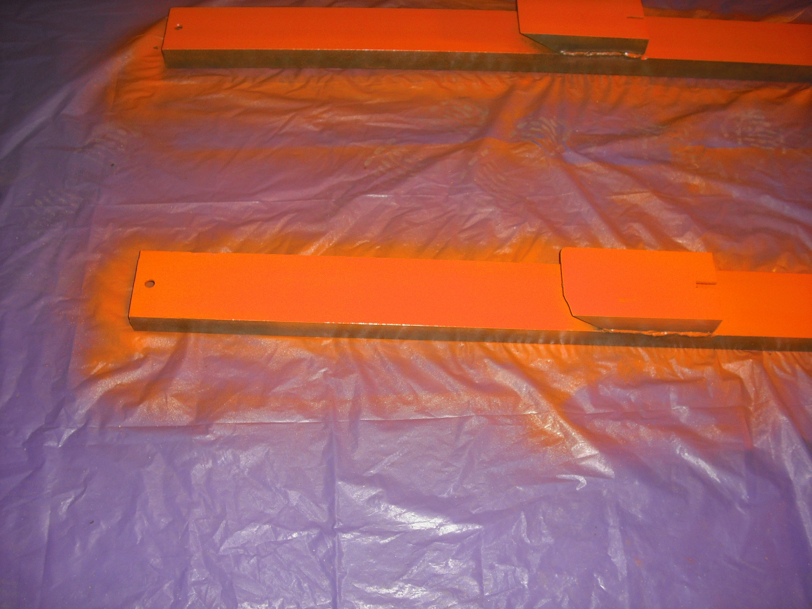

Here's my first attempt at pallet forks. I tried to take different ideas I could see out there and combine.
I went with the chain approach. I'm anxious to see how they work.
The steel is C-Channel from pallet racking (ironic isn't it). I think the wall is thick enough and should hold up to anything my loader can lift.
They extend approximately 45 inches from the bucket.
I'm into it for (exluding welding rod and cutting discs) for approximately $50.
I paid $15 for 10 foot long sections of the steel and used two of them with quite a bit left over for other projects. I spent $20 in 12 foot of chain.

I think your wife is going to be upset with you using her sheets as a dropcloth.:D Looks good. How about some pics of them on the tractor?

Thanks, actually it was the shower curtain :)
Raining today, I'll get them on this weekend then I'll post a picture of them in action.
