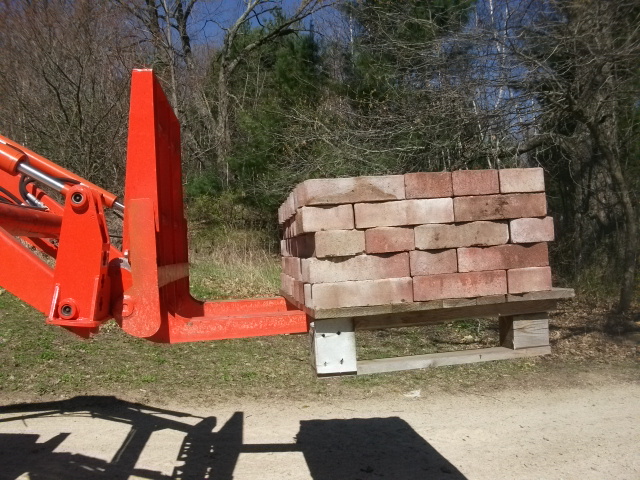

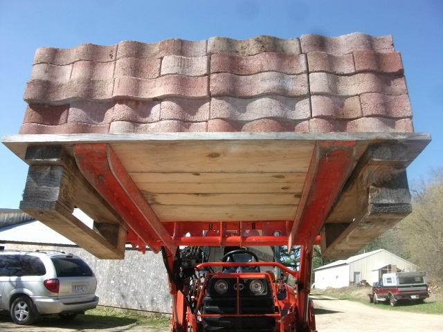

I would have to agree, The forks I use weigh 110#. The loader is an LA402. The pallet full of pavers (5 rows of 20) in the photos weighed 850#. I weighed a brick to calculate, 8.5# a piece. I put them out to the end of the forks as a test. It did begin to stall as I got more than 5' off the ground but for what I was doing it was fine. That just told me I was near the limit of my loader. I don't dig with my forks as they are designed to lift. I have PLENTY of other stuff that does that. :D
Those are IMHO very appropriately sized and built forks for something like a Kioti CK35 or smaller tractor like anything in the Kubota B series etc. Much superior to bucket clamp ons too.
Folks need to be realistic about what you are going to be able to lift and size the implement accordingly regardless of any latent skidsteer envy. Even the 50hp CUTs do not really lift as much as a typical skidsteer for which the heavier duty 48 inch forks are designed.
