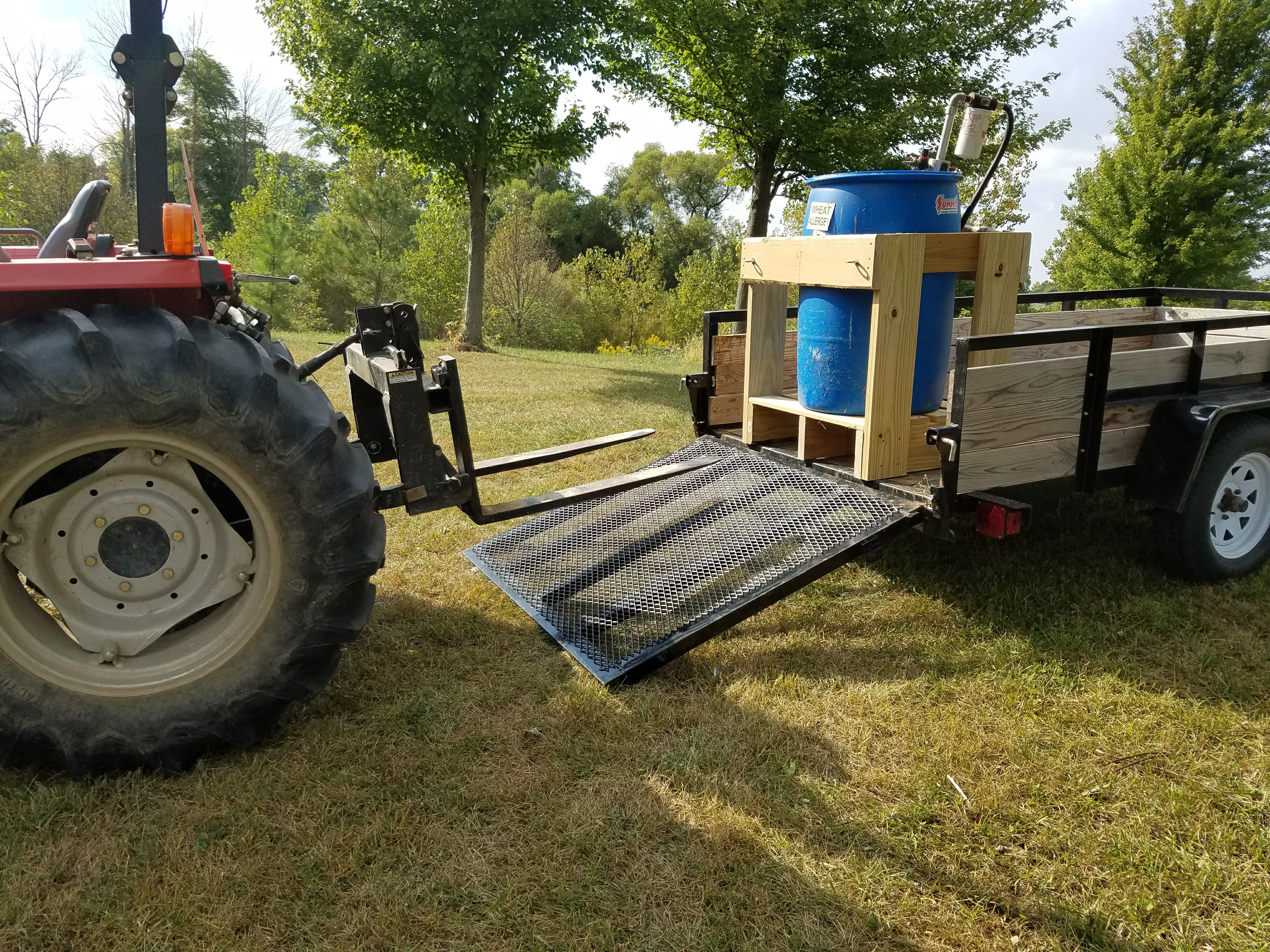

I have an MF1250. I can lift about 800 lbs in the bucket, but wanted to move heavier things like pallets of roofing or scrap car chassis. I decided I wanted light weight forks for the 3 point. Mostly I move a pallet with barrel of diesel.
I bought the cheapest forks I could from the clearance rack at StoreFront NetForks.com Online Store, $147.23 with free shipping. Welded two 4" square tubes to them ($60 from Fort Wayne | Metal Supermarkets - Steel, Aluminum, Stainless, Hot-Rolled, Cold-Rolled, Alloy, Carbon, Galvanized, Brass, Bronze, Copper), a bracket that came off an old mower for the top link and two bolts for the bottom pins. Works great and is light enough for me to move around by hand.
It was my first welding project and seems to be holding just fine.

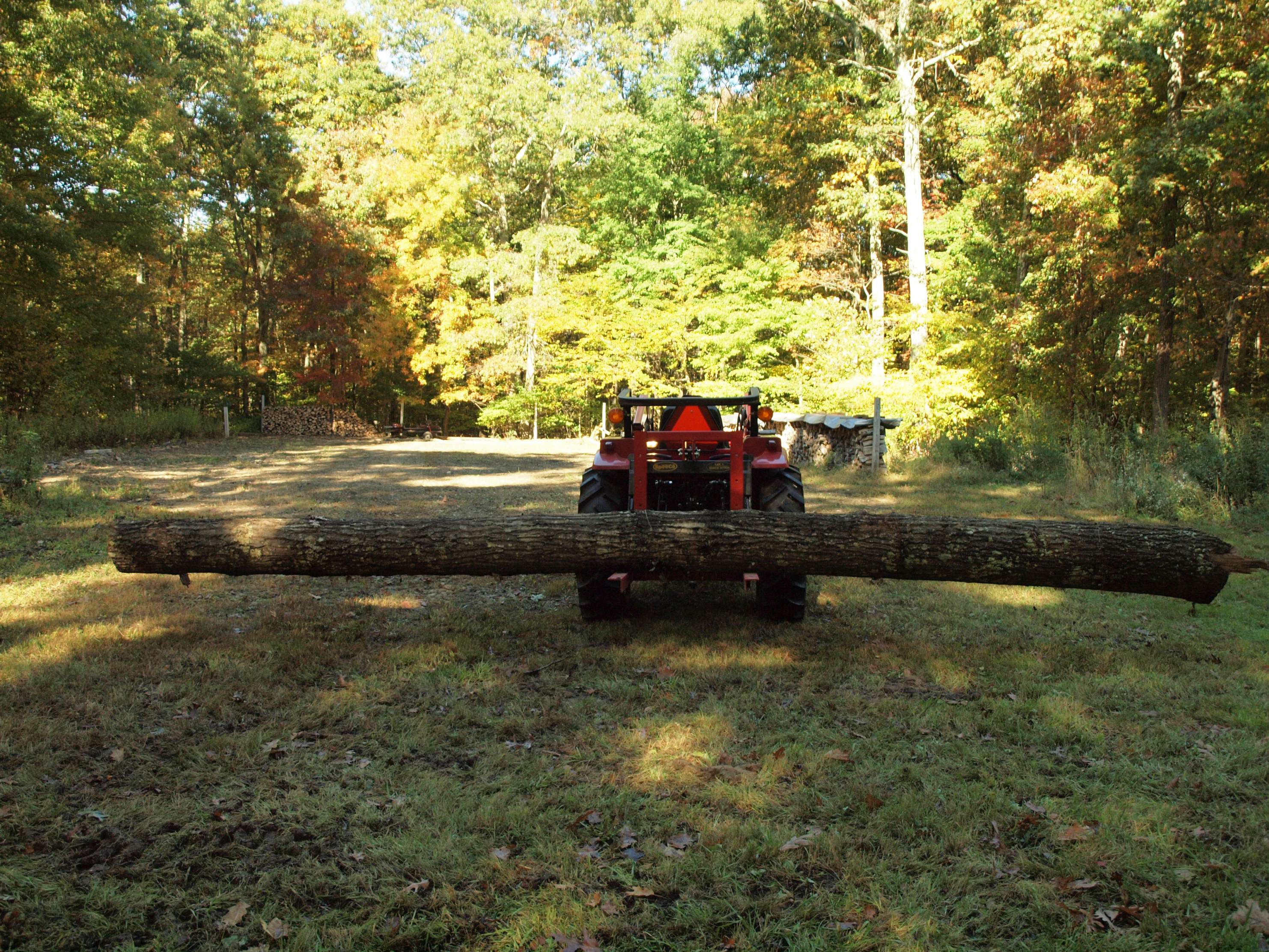

You lucked out there pal. They do not seem to have these in clearance anymore. I bought one of those Tractor Supply carrier 1000 lb capacity forks and proceeded to beef them up with welded metal and gussets. They picked up an a 1700 lb stem with just a bit of a creak.
Your picture got "forbidden".
