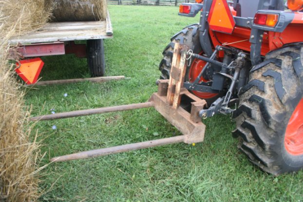

You might be able to build your own. Here is a picture of my home made forks/spears. It cost me $25.00. It's not pretty but does come in handy. They are made from used bale spears and some scrap steel. I use them to move round bales, skids, tree branches etc.

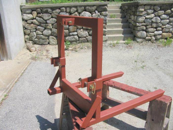

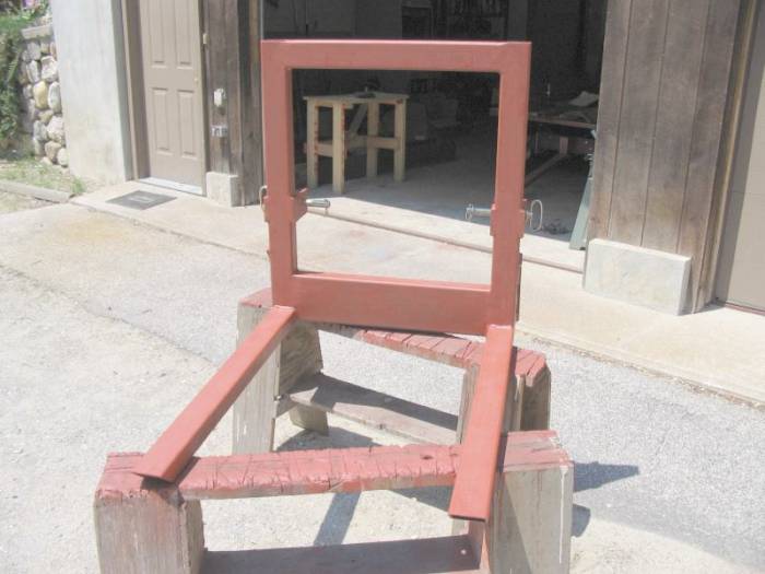

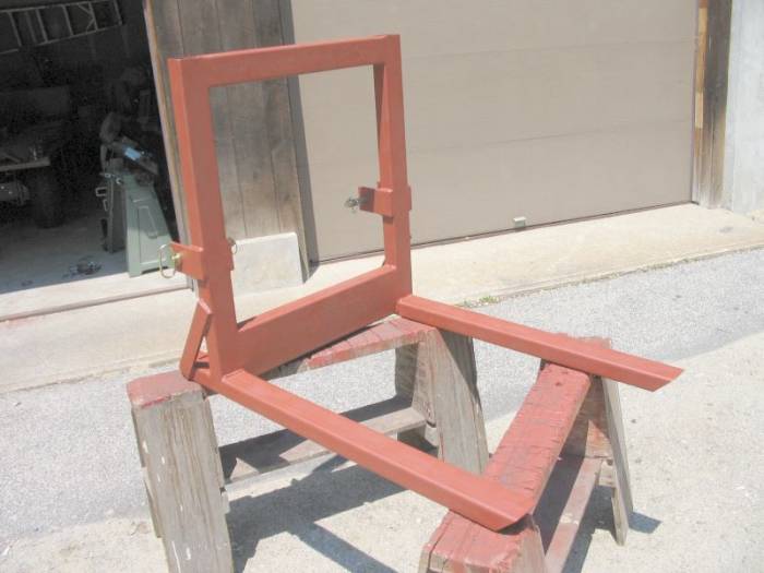

   / Pallet Forks For Rear 3 Pt Hitch #10
Those are commonly referred to as a carry-all. Usually the max weight that they will support is 750-900 lbs.
I built a rather heavy duty carry-all for another member and he regularly uses it to haul 1500+ lbs of cut wood.
