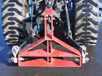

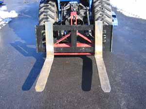

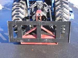

What I found was that the ones made by other people are REALLY expensive. So I made my own. Actually I designed them and my neighbor welded them up for me. I was able to scrounge an old set of fork lift forks and I used an "A" frame from a Howse Sub-Soiler/Middle Buster unit.
For about $500 to $600 you can buy a good set of adjustable forks already made to work on your 3pt hitch.
For about $165 you can buy a Howse combo unit. For another $100 or so, you can usually find an old set of fork lift forks. For a 6 pack and a few $$'s for some steel, you can get someone to weld a simple frame to mount the forks onto the Howse "A" frame. My unit mounts onto the "A" frame with 1 top link pin that cost me another $4.50. Total invested would probably be under $300 (in my case I got the forks for free, so my actual cost was about $200). The best part is that I have 4 tools instead of one since there was no modification to the Howse unit, it still functions as 1) a trailer hitch, 2) a sub-soiler, 3) a middle buster . . . and by flipping it backwards and mounting the black fork frame to it with the top link pin to hold it in place, it becomes 4) a set of pallet forks.
BTW, The nice thing about 3pt pallet forks is that your lift capacity on a 3pt hitch is higer than on a FEL so you can lift and transport more weight. Of course you can't lift it very high. But I've been able to unload pallets of mulch from a trailer by driving up the trailer ramps and lifting them off. I did find that a pallet of concrete blocks is too heavy to lift, but I can lift several layers of block and tansport them.
Here is a link to my modular set up: Home Made Pallet Forks
   / pallet forks for 3pt hitch??? #5
Here is a picture of the Howse A frame mounted on the tractor. This is actually mounted backwards. When used as intended with the sub-soiler or middle buster blades installed, the part that is facing the tractor is actually facing away from the tractor. The reason it is reveresed is that I needed a flat surface to attach the fork frame onto.

Here is a picture with the fork frame that I designed added to the Howse A frame.

Here is a photo that shows the pallet forks added to the unit.
Because this this modular, it is also nice for storage as the forks and frame pieces tuck away against a wall taking up very little space. Also each component can be lifted up and carried so you can have your lovely wife carry it over and attach it to the back of your tractor while you give her directions on what to do.
