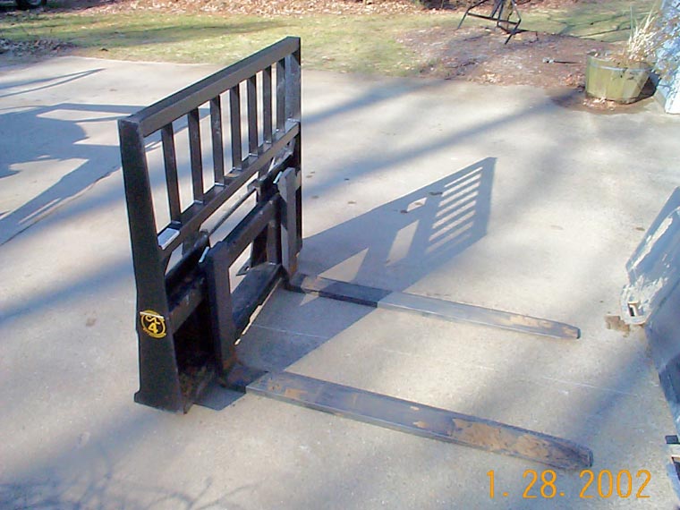

Gerald, the forks I have are by Construction Attachments . I think they are great, I have put them through quite a lot and have not had any problems. I would highly recommend them. Mine are the model CAL-48.
I have attached a picture of my forks off the tractor.

Ron, you are correct if you are only going to lift pallets with the forks. My FEL only has a lift rating of 800-900 pounds and these forks weigh in at a little over 400 pounds (which cuts my lift capacity dramatically). There are times that I would prefer to have some lighter duty forks for when I only want to lift something heavy up in the air. The reason I got these heavy duty forks was because both my dealer and I knew that most of my work with these forks would be for chores other than lifting pallets (ripping out stumps,etc.)
If you go up and read the two threads I posted earlier about stumps you will see the kind of forces I have applied to these forks using leverage. I wouldn't want anything lighter duty for those kinds of chores. Also the lighter duty forks use tubing instead of forged forks. That makes the forks much thicker so it is not as easy to get under items to pick them up.
