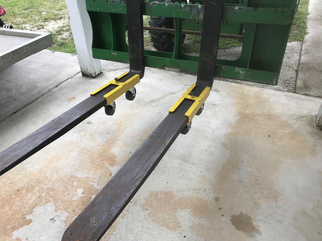

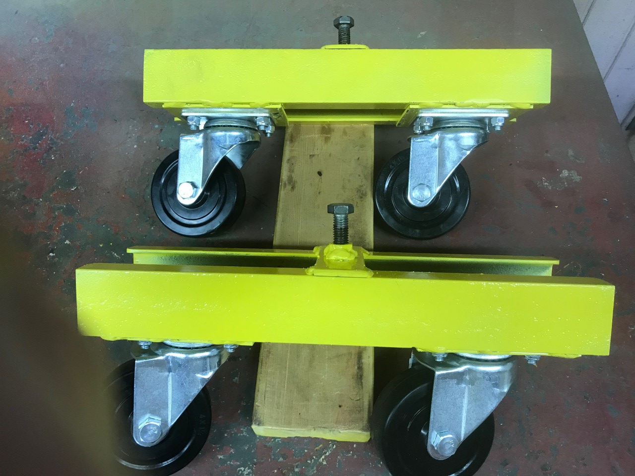

Building I store the pallet forks and other implements has a single garage door, so when they sit in the opening restricts access. Tried placing them in a heavy pallet with big casters, but was too cumbersome to move.
Made these up from material on hand, casters from HF, and cleared the door jam.

Simple....I like it!
   / Pallet Fork Rollers #3
Cool. I use a furniture dolly that fits the width from fork to fork. You need to put it on with the SSQA plate on top of the dolly or it wants to tip. Is yours tippy at all having the wheels set farther from the plate?
Not tippy, well balanced with the channels pushed back to support the weight, rolls around easily. This set of forks are made by Horst Mfg. purchased through my Deere Dealer.

These are pretty slick, hiflyer. I reckon you could sell a pair of those for oh, $70 or $80? Start with some thin gauge c-channel and you only need to weld once bar across the top for the set screw. You could tack weld a small piece of bar/tube onto the bolt to make it easy to hand tighten/loosen without any tools.
