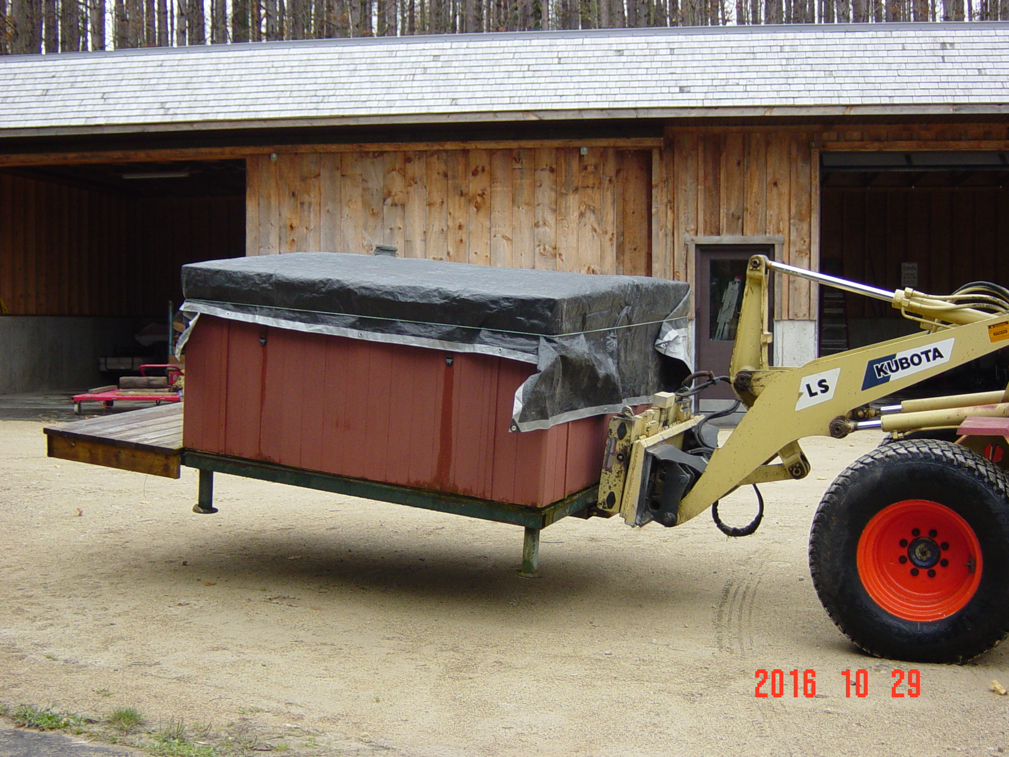

I make them just a bit narrower than the widest position for some margin of error. BUT, now that I think about it. I have hydraulically adjustable forks, and if I made them the maximum distance, I could just spread them out all the way and know I am good. Same would apply even moreimportantly to manually adjustable forks.

I never noticed, but in the background, there is another thing with fork pockets. A dolley to hold my 3ph ditch bank mower. The pockets were just pieces of angle and whatnot, but pockets should always be a tube for best safety.
