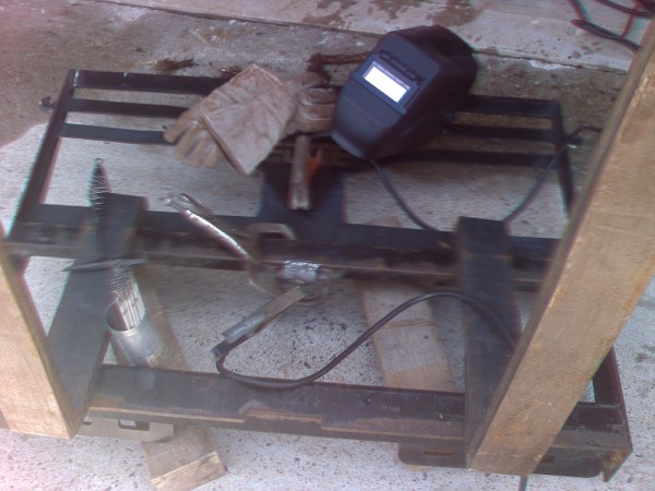

This is not a fancy mod but one I put right to use after completing it.

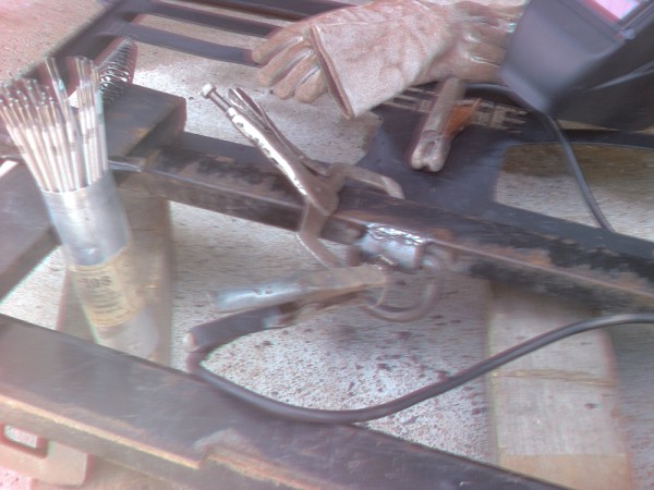

One of my most favorite attachments is my QA pallet forks. I use them for moving "stuff" around & usually put them on when lifting heavy things as I can get the lift point back close to the loaded bucket pivit point where max lifting capacity is available. In the past I"ve wrapped a chain around the fork frame.. On a recent trip to TSC I found a 15,000# weld on "D" ring which got me to thinking about how handy it'd be to have on the forks so I did not have to wrap the chains around the frame any more.
I welded it to the bottom of the upper tube - attached are the photos.

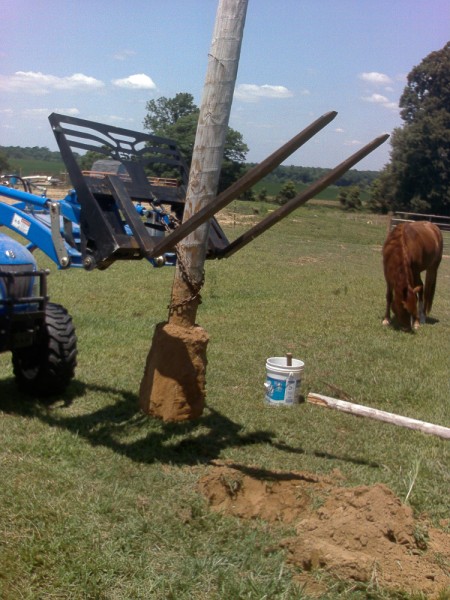

The "D" ring has proved to be a much easier place to hook a chain to. Attached shows us relocating a concreted post to a new gate area.

I don't know if you can see it but I've also cut down 2ea 1/4" chain grab hooks & welded them to the sides of the fork frame. I use them to carry things like buckets & also they are a good place to hook a light chain to when stabilizing a awkward load.
