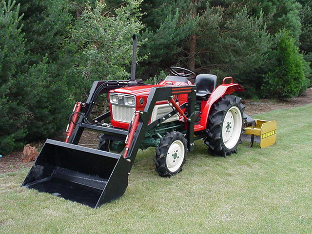

Ket,
I have painted all three of my Yanmars and each one has taken me about five solid 12 hour days to paint. I disassembled all of the sheet metal from the frame and removed all dirt and feathered all scratches. This seemed to take forever. there seems to be grease soaked dirt everywhere that needs to be removed for a proper paint job. If your going to avoid overspray, like I did, this means more disassembly. Now I know that I probably went too far when I painted all of the plastic parts like headlight bezels, knobs, and dash parts which took time, but when I got started each time, I was SURE that I would be done in two days. Here are a couple of tips for a speeding up the process. #1 Soak all rusted bolts and hardware in an acid metal primer like Jasco Prep and Prime overnight. The next day heavily rusted parts will be free of all rust and ready to prime. #2 Don't remove all the old paint whenever possible. Old paint is the best primer. #3 Anywhere there is a scratch to bare metal is a location for hidden oil or grease to affect the finished paint. Sand the scratch to bare metal and prime. #4 Lacquer thinner is a great solvent to remove hidden grease and oil. Use a vapor mask! # Have fun! Painting a tractor is a fun and rewarding project.
Thanks,
Cameron

   / painting yanmars #9
Cameron....Wow! That method certainly gets my vote. Now I've got something to shoot for when planning my next paint job.
