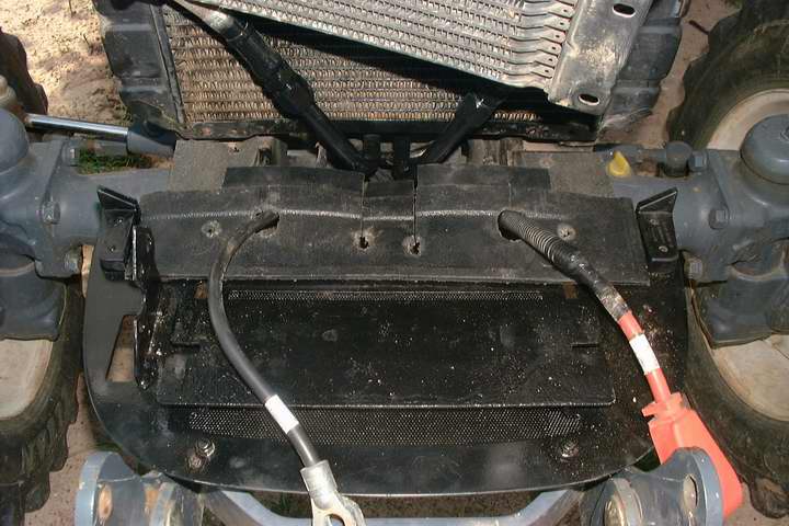

This is my second go-round with battery leak damage on my TC40D and I'd like to be done with it. The tractor has been down for two weeks with a hydraulic steering leak caused by leaking acid and I've been removing parts too badly corroded to replace including battery plate and bolts. A mechanic from a dealer is returning this week with new hydraulic fittings and lines plus oil cooler pipes and other parts (some is warrantee work). I allready bought an Optimum sealed battery. There is bad paint damage on top of the front axle and peeling on the chasis near where the supersteer arms fasten.
I sponged affected parts with baking soda water but this corrosion is rough and scaly so I'm wondering if I need to grind, sand or just spray on the NH Gray paint right out of the can. These areas will be real tricky to work on after the new plate is installed. I'm trying to include a picture but this system is fighting me.

I'd use a wire wheel on a drill to remove the scale and rust, clean the areas, prime and paint.

I agree with MikePA. Wire brush, scrape, chip, grind or whatever you need to do to remove the crusty buildup then neutralize with baking soda / water mix. any pitting can be filled with liquid steel putty then sanded, primed and repainted.

Once you install an Optima battery further damage from acid will end. Wire wheel, prime & paint.

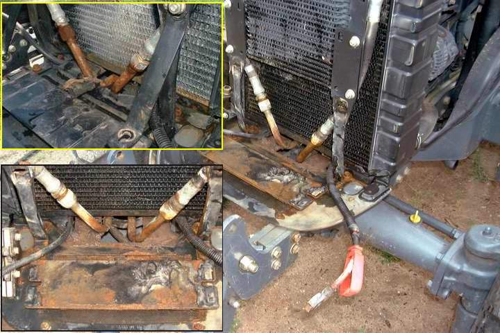

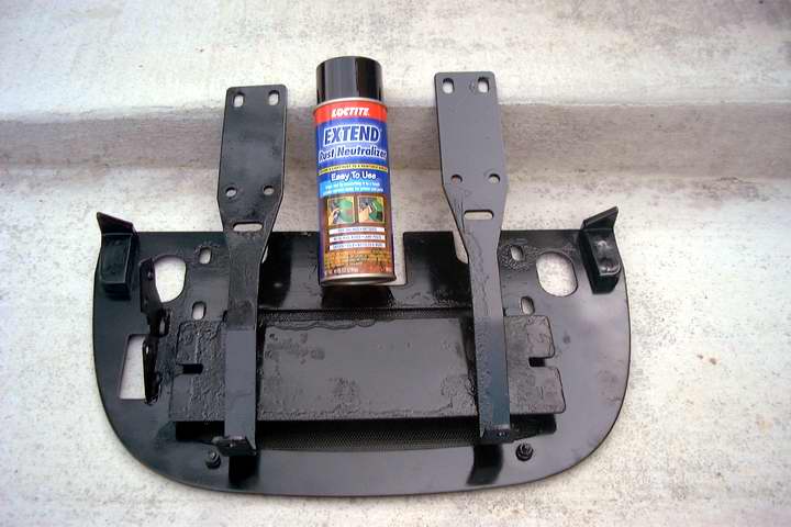

If you want to go a little extra on the heavily rusted areas, there is a Loctite product called "Extend" that will neutralize the rust and convert it so it will not come back beneath your new primer and paint. Here are a few pictures of my repair and battery shelf.
When you get the paint finished, you will want to use oem foam or creat something to seal the front area to keep dirt and debris from getting into your radiator. That area relies on the grill to filter out large particles and keep the radiator clean.
