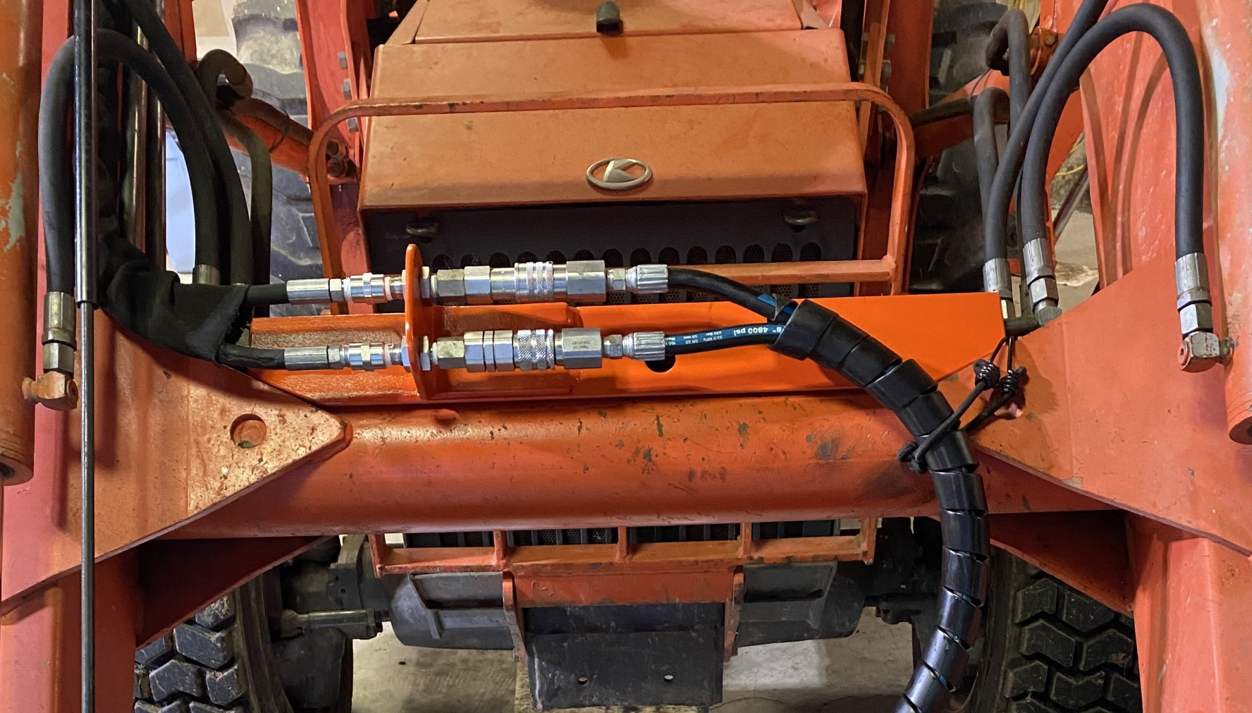

I built a bracket/line guard for my L48 3rd function hoses and used the "new" Kubota paint. Though the paint on the machine is somewhat faded, I think the new color looks appropriate.
