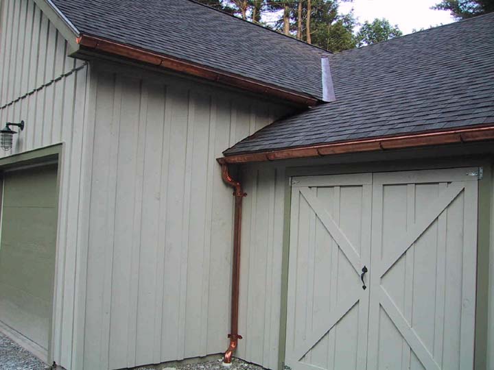

My house is also board & batten, with rough side out. It was previously stained very dark brown. I just stained it with a light gray opaque stain made by Cabots. The attached picture shows the results. I'm very pleased.

Nice pic of the barn and stain job bellweather, but what is the story behind the rusted gutters and drain spout? This looks like a fairly new building. Did these gutters prematurely rust due to defective workmanship?
Bob
