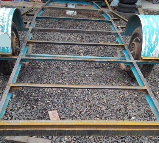

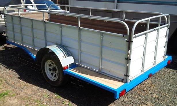

When I stripped, reworked, and repainted my old trailer, I used a Rodda paint 74904(Clear gloss base) " Maintenance paint". It is a brush on self-priming gloss enamel, in the blue color I liked. They can mix the paint in many colors.
Being an enamel paint, the brush lines faded away into the paint. It looks to have been sprayed on. The brush on enamel leaves a heavy coat and it is as tough as nails once cured out. But it will take several days to cure since it goes on so thick.(It is always damp and not so warm here in the P.N.W.)
The trailer was old and very pitted in places. However the new steel I added for the deck support, and the ones to hold in the deck boards, plus the new rear bumper, have held up just as well as the paint on the old steel. Which was mostly stripped down to steel, then cleaned with de-greaser(lots of Acetone)
The first Pic below was taken just after I had added the new cross beams(every other one). Prior to that there were 2x4s in there. Also the deck board boarders.
The second Pic is the final product after I fabricated the new bumper, fabricated the sides, and put the deck boards in. I did not repaint the fenders since they are Galvanized and I have yet to find a paint that will stick to it.
This trailer was a free camper I converted. It is 5'x12' inside..
Anyway, I LOVE the paint! It is now 5 years young and holding up very well!

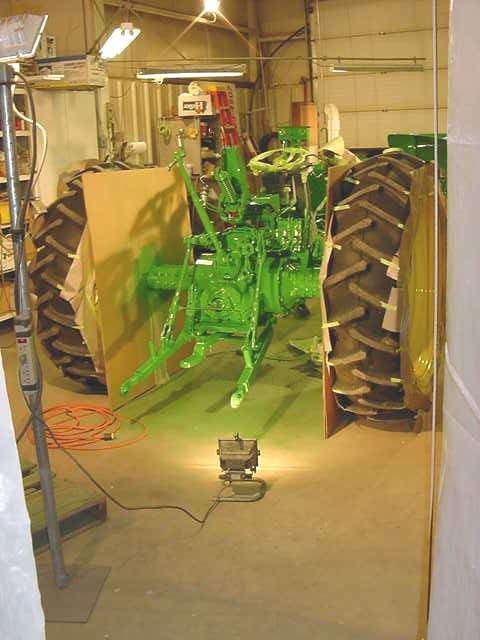

No one really fusses over perfection walking by but the 1 thing sticks out is overspray. Mask off. If you are going to paint regular get a paper machine and 6 inch and 18 inch rolls. On tractors I font get it on the rubber, even a quick hit of 3/4 around the tie rod rubbers is noticeable.

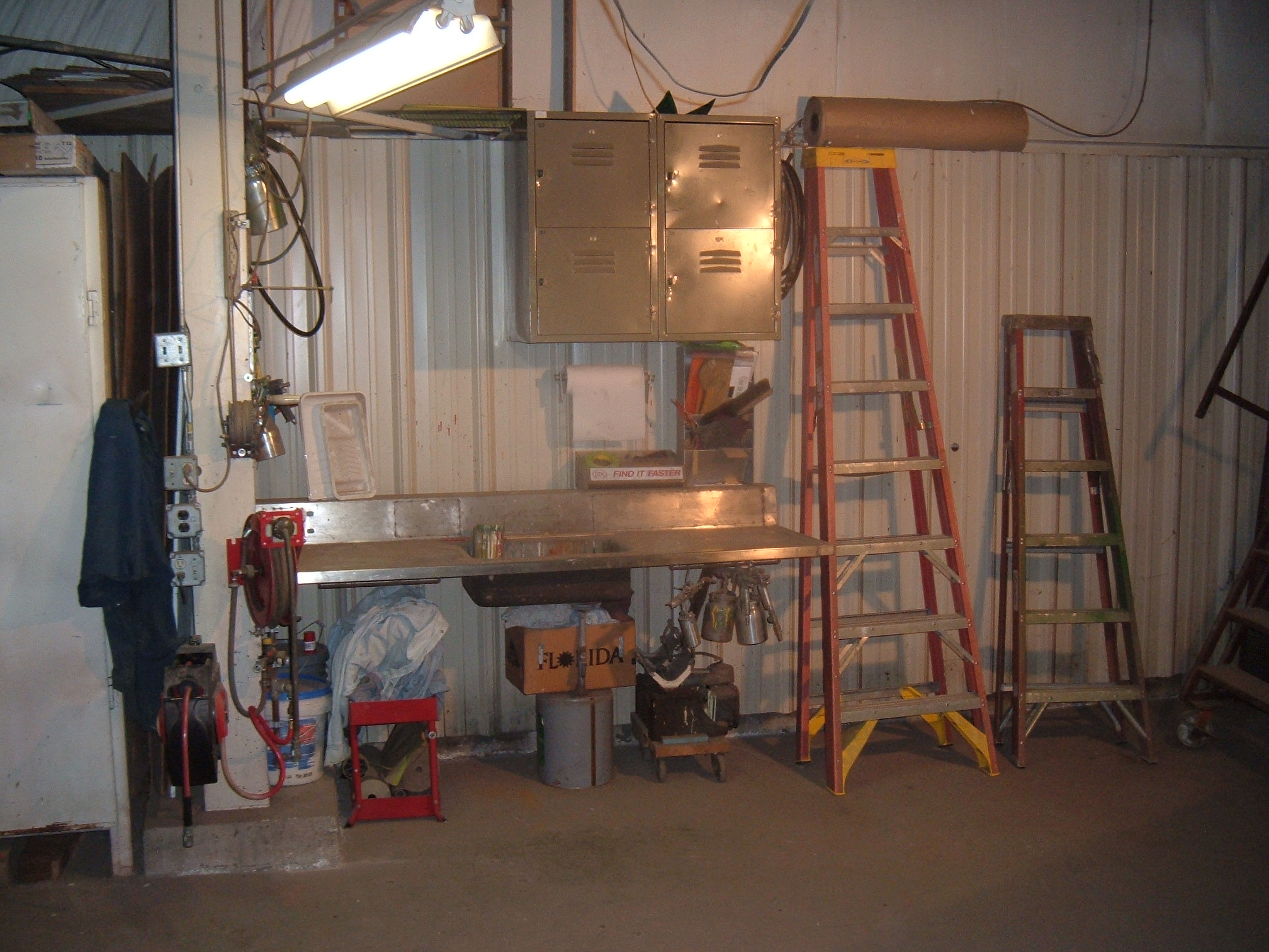

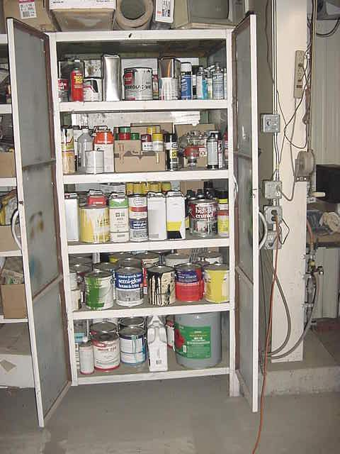

Those colors on that trailer above look good together. The blue is pretty. I like stock colors for equipment. If it came with it then thats what I like to use. As for paint,,, depends. If I am trying to get color fast will paint it with anything. If the cost is hi, the prep tedious, the service severe then it gets super paint, Industuial Imron or similar over epoxy primer. They last sooooooooooooooooooo much longer,,,, soooooooooo much better than old equipment enemal. The Dupont colors are perfect and I think better than the dealer stuff seems hit and miss.
I ended up with some left over but we got it at the right price and I do mostly use cheap common enamel now as its so much simpler and not so hazzardous and not part of expensive 2 part systems. Nothing beats the best to last but the other is so much user friendly.

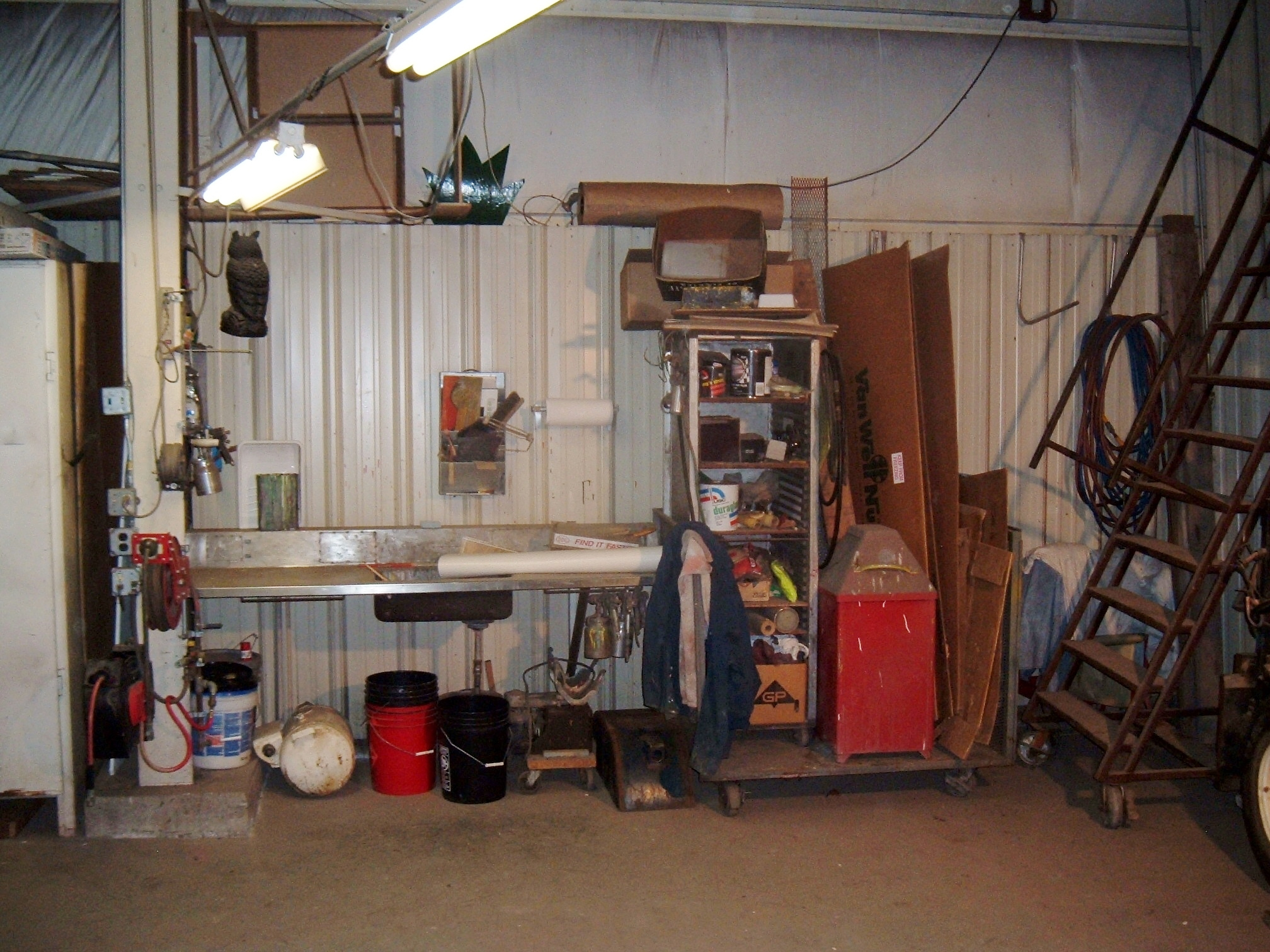

   / paint job - tips & tricks for beginners #7
First 2 pics above are before/afters. I since added a couple simple shelves to the left of the cab, its cluttered stuff back full again but its not things I hadnt used since they got parked there and I recycled them in to direct use again at the same time. It was like getting a 30 sq ft addition for free in a couple hrs.
I stock enough stuff for most trades to get a head start on something without needing to blaze to the store. We even buy a little cheap paint on occasion in the common colors. Yellow, red, black and white. Green cause we use it. Paint is usually something I want now and fast , want it done before I leave and dont tell anyone but use quite a few sponge brushes and spray cans.
I see a house paint stuck in there,,, since been removed, ha

How wide is that blue trailer? I am going to comment again that it looks really good and nice to see some color other than black. It just makes it look sharp.
