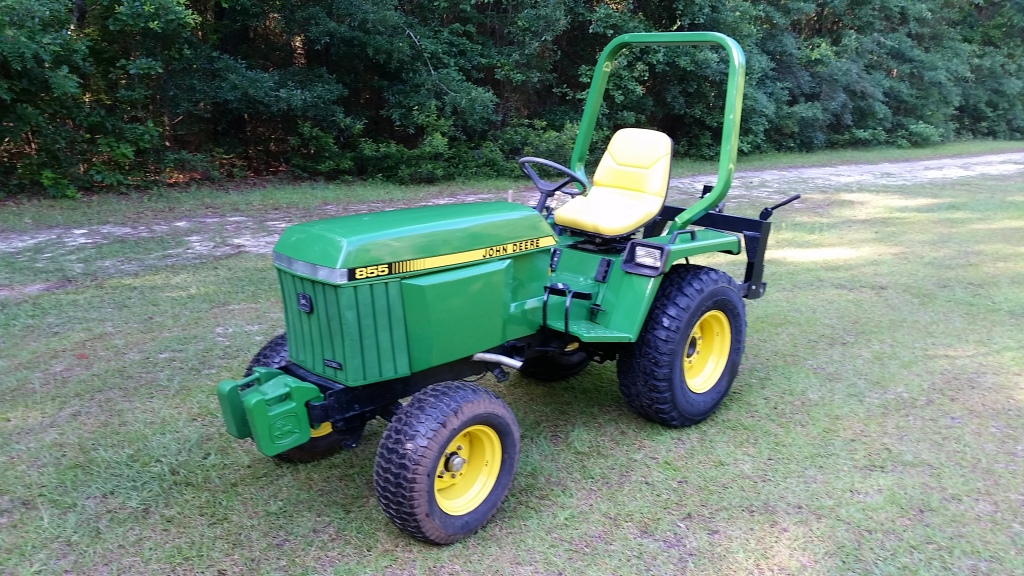

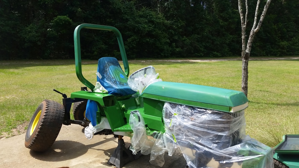

Never tried the Magic paint. Even Rustoleum will remain tacky and soft if applied at the wrong temperature and humidity. I did my 855 with rattle cans of Rustoleum farm equipment paint and it came out great.
Also you have to make sure the primer and paint are compatible. Even using the same brand products doesn't insure that. I was re doing my front door a while back and when I stripped it I saw it was galvanized. I had Rustoleum 2x paint and Rustoleum auto primer. I called Rustoleum and was told I needed their all metal primer. Back to the store to get two cans of that and all went pretty well. I had painted this door with oil base Rustoleum a few years back and the paint cracked and peeled. Paint wasn't compatible with the original finish.
