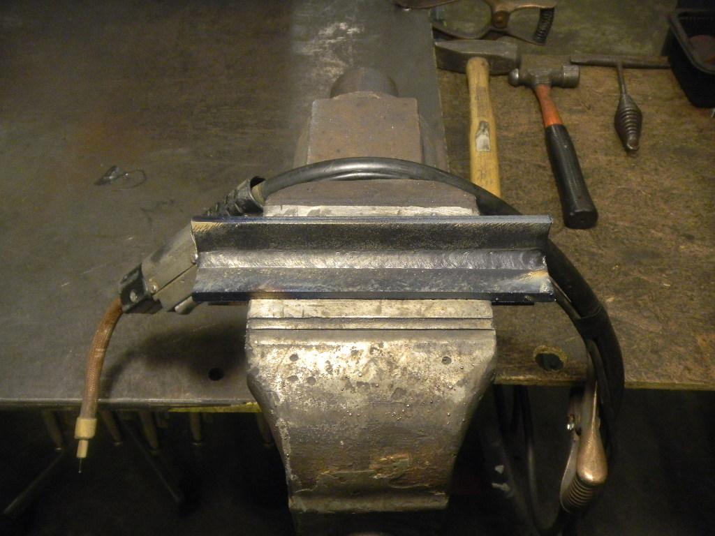

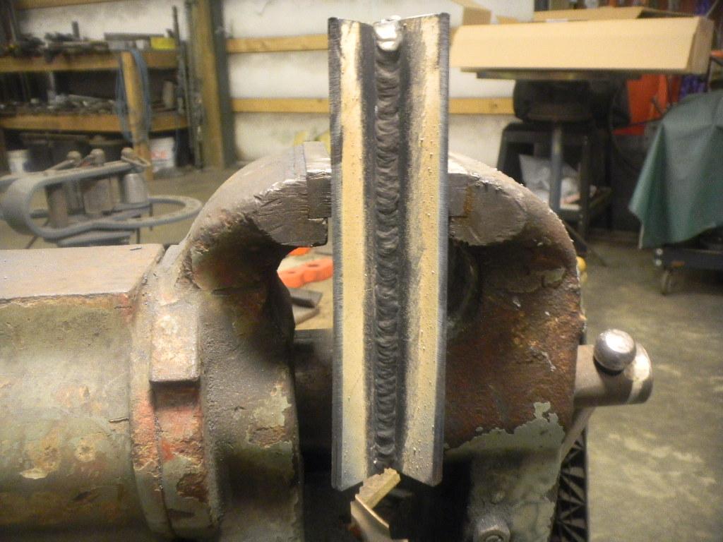

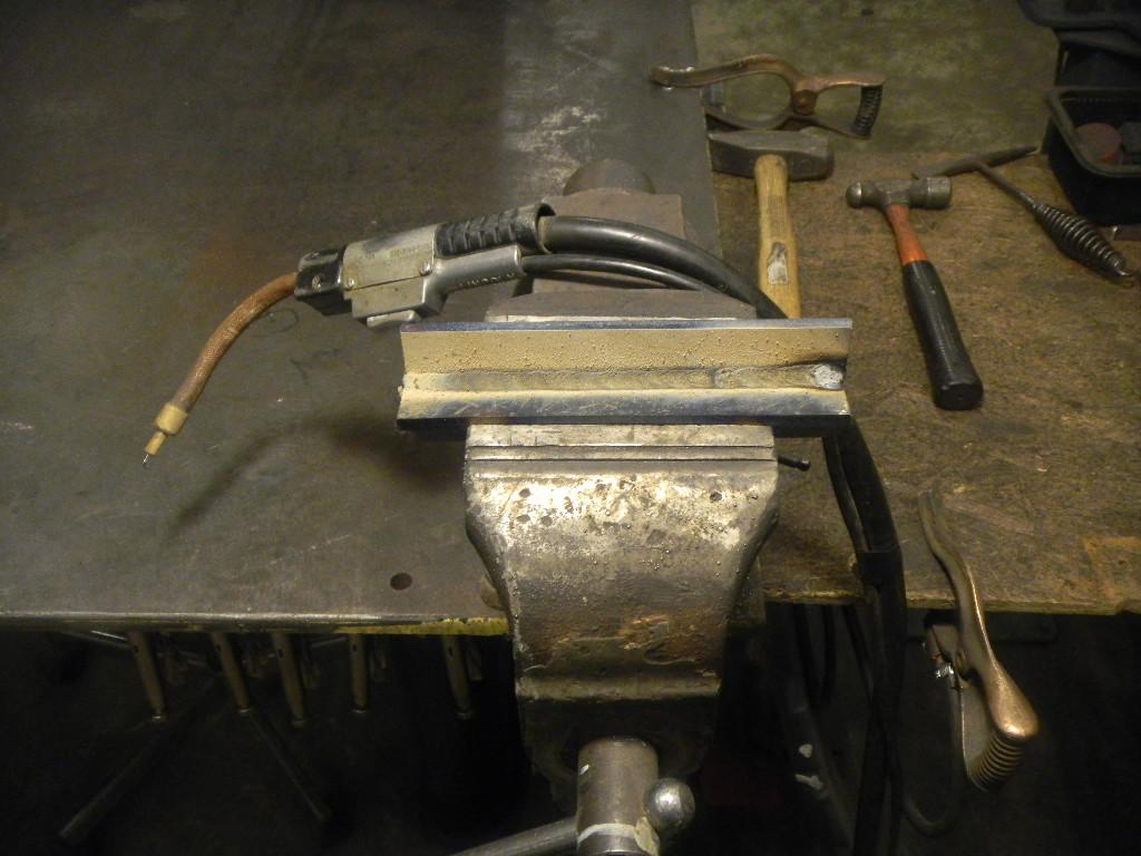

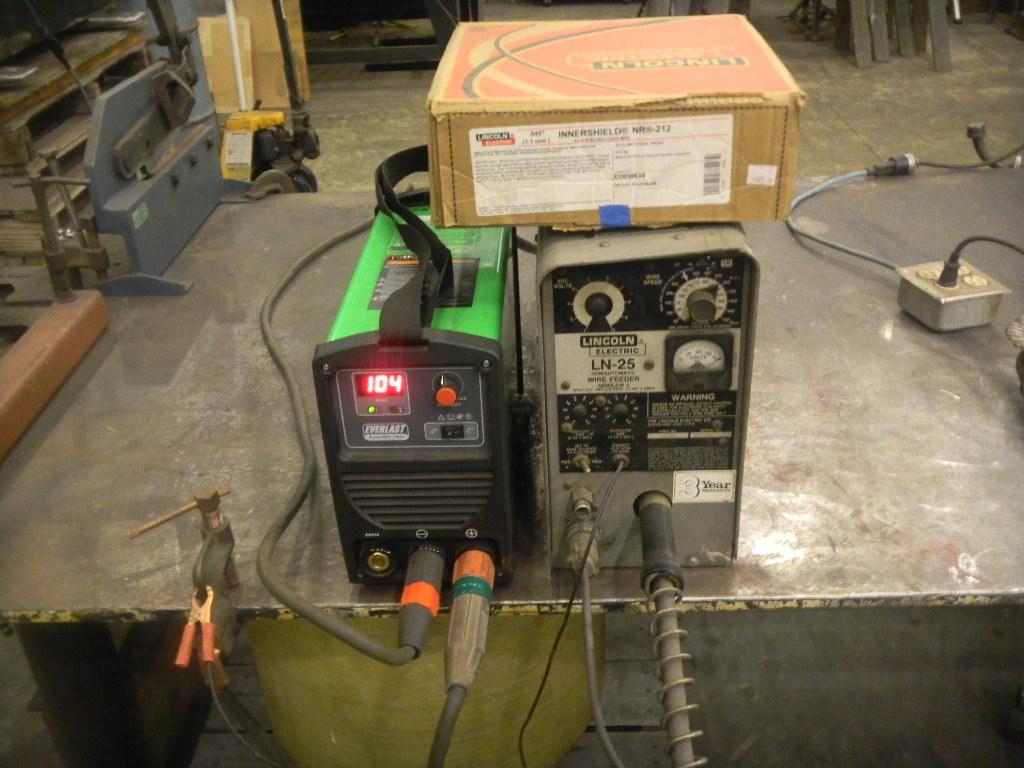

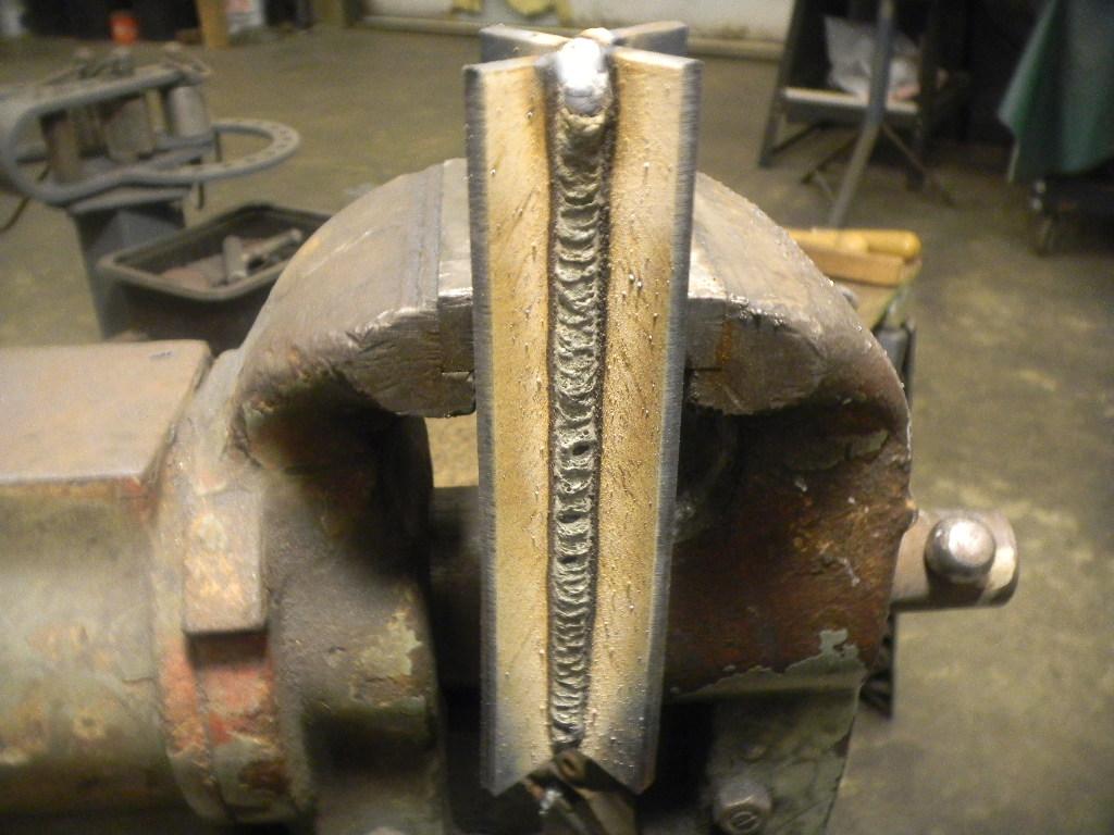

Got all the downed trees taken care of, from the storm that blew through. So I thought I'd see how my brother-n-law's PowerArc 200 ST would do running some .045" NR-212 self shielded flux core wire. This little machine sure runs hot! 104-AMPS for flat welding. 80-AMPS for vertical up hill. I don't think it did to bad my self!:cool:

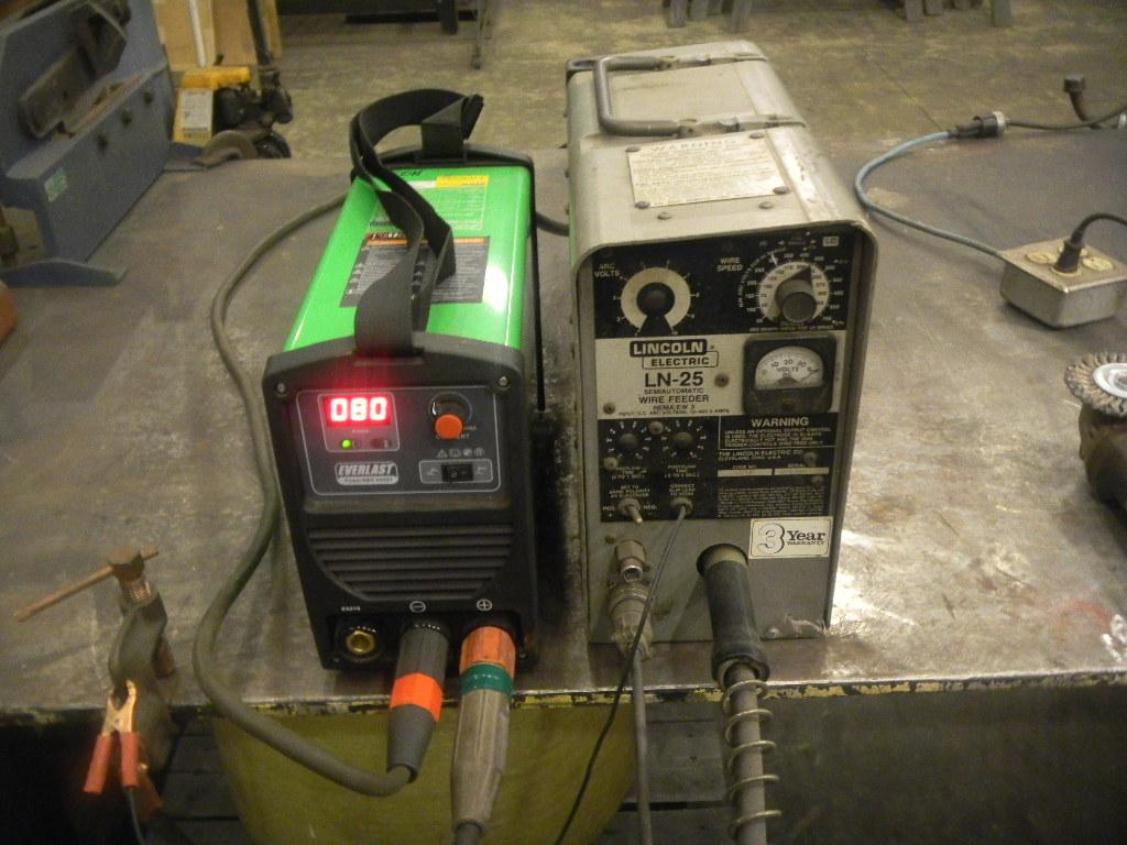

That's great news! Now if I see a VS wire feeder on CL for cheap money, I might pick it up.
I would have been afraid that the PA200ST (or any inverter) wouldn't play nice with a wire feeder. Does the wire feeder require 120 v AC, or does it get it's power from the weld current?
   / PA 200 ST & LN-25

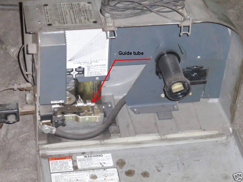

On the inside of the LN-25 there is a switch. CV / VV, (right above the drive rolls) on these welders you'll want VV. See the little red clamp on the ground clamp? (In the picture above). That's how the LN-25 gets its power.
Can't wait to get back down to California to my brother-n-law's and try my PowerArc 300 with the LN-25.:cool:

When running an LN-25 on a CV power source, I can't tell any difference from a dedicated Mig welder. On a CC power source there is very little difference. The LN-25 can handle some of the worst engine drive welders I've ever seen. The first generation LN-25s, some of Miller's engine drives we had to lower the RPMs because the welder put out too many volts. So there was no wire feed until you struck an arc. Far as I'm concerned the LN-25 is a fantastic wire feeder!:cool2:
Between the PowerArc 200, PowerArc 300, and the PowerArc 200ST. I'd say the PowerArc 200 is the weak link. Only reason I say that, is you have to hold a very close arc length when running 6010. But with 7018, it welds every bit as nice as my $5,500.00 Lincoln V350-Pro!:shocked:

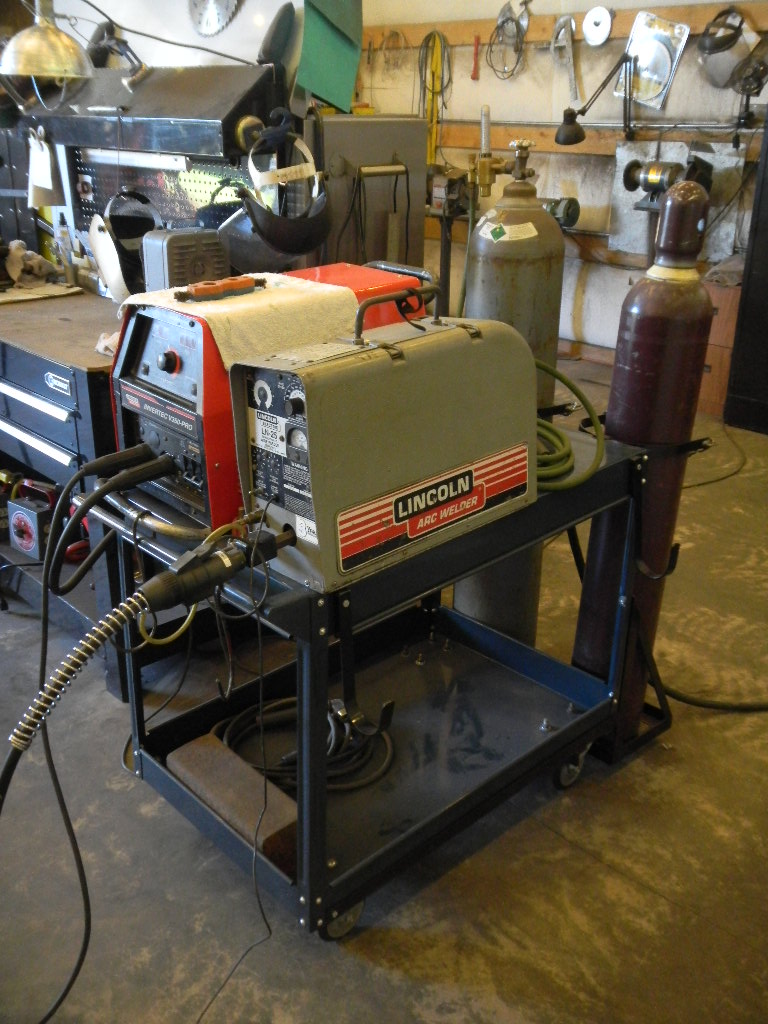

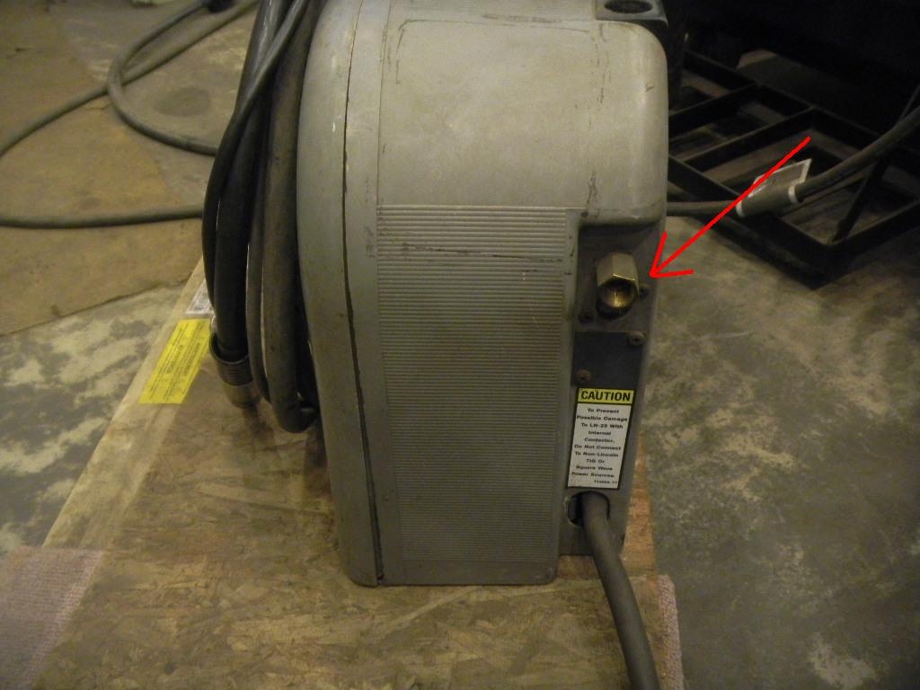

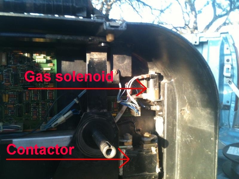

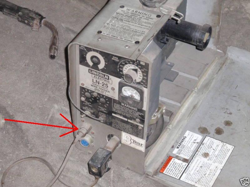

Sure just need a gas regulator / flow meter, and some hose. Be very careful if you buy a used LN-25! Some come without a gas solenoid, and without a contactor. Without a contactor the wire is hot at all times. The old LN-22s were that way. Amazing how many contact tips you go through when the wire is hot all the time.
