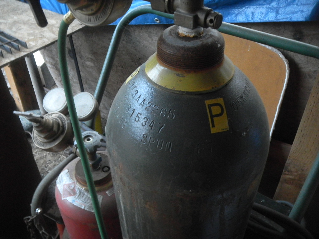

My welding supply told me if you rent for 2-years. You might as well buy the tanks. When I go in to get new tanks, the guys don't even come over to help. Just have to make sure the full tanks have a "P" on them. I just go inside and tell the counter guy what I loaded up. Been doing it this way for about 20-years.

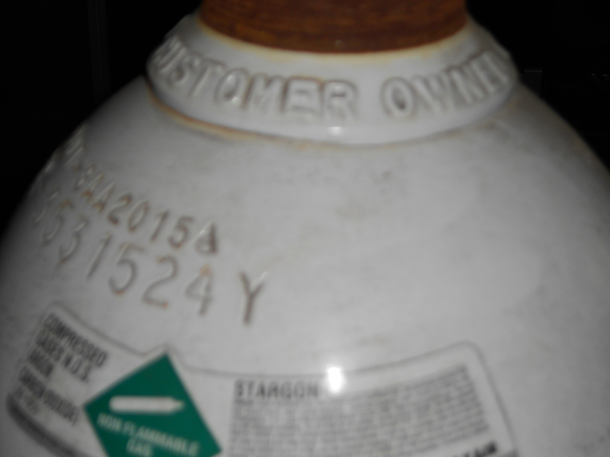

My bottles have this ring on top marking them as customer owned.
