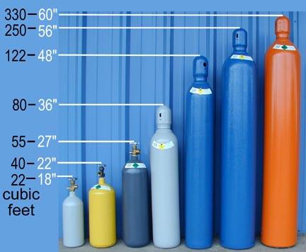

I've been wanting to get some tanks bigger than the ones that came with my portable set. Yesterday I picked up a 75cf acetelyne tank for $20 at a yard sale, what is the correct size oxygen tank to pair with it?

I have an 80 cubic foot acetylene bottle, along with a 250-cubic foot oxygen bottle.

I have a 75 acetylene and 150 oxygen. They usually run empty about the same time. I wouldn't want anything bigger. That thing is heavy and I got old somehow.
   / Oxygen/acetylene tank sizes #5
I have a size 5 acetylene (360 cubic feet) and a "T" oxygen (300 CF) - you need that size acetylene tank to use even a relatively small rosebud for heating, or you'll exceed the (old) 1/7 of the tank volume per hour draw, and even moreso the (newer) recommended 1/10 of the tank volume per hour. If you're only using O/A for cutting or with regular welding tips, you can safely use smaller acetylene tanks -

I inherited a 100 cubic foot acetylene and 250 cubic foot oxygen tank from my dad. Usually your oxygen is double the size your acetylene. Last year I had to get a new certificated acetylene tank. No problem with my local welding supply company but some have had issues with personally owned tanks.
