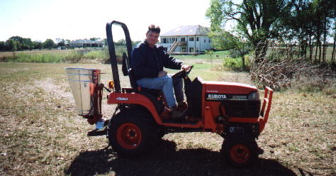

Despite exhaustive attempts on my part I have never found such a thing as you want--a small seed drill for overseeding. In fact the average tractor on this board is to small to operate the vast majority of overseeders. No rental place I have ever been to has diddly much less diddly for a BX. I finally gave up and bought a drag harrow and a Heard M-96 PTO spreader. This works well for seeding but a true seed drill in a small tractor size would be a vast improvement.
I drag up the ground, then I spread seed, then I drag a second time to work the seed in. This works best on sparse or bare ground, getting seed into an existing lawn it may not work so well.
Why something powered by the PTO, about 4 feet wide with rtotating blades like the push type you rent at garden centers does not exist is a mystery to me. J
