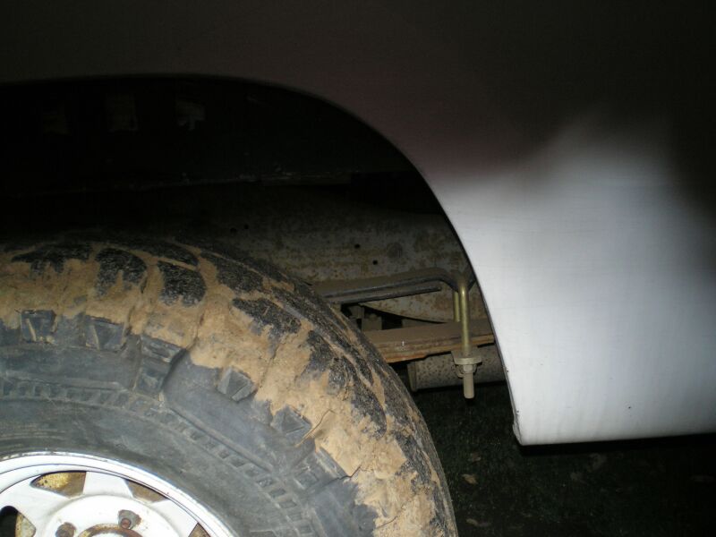

Ok, I have limited experience with O/L's. I'm not too impressed with them. I have air bags on my street tow vehicle. I like them a lot! (Not the airbags that the punks use.)
Attached is a pic of the O/L's on my ranch '80 Dog Ramcharger. The factory springs were crap out of the factory just like they are on most everything today. "Preload" is the big deal w/ O/L's ... note the lack of threads on the Ubolts in my pic. I jacked it up and gave it all the preload I could. They're "progressive" O/L's but you have to get a decent start ... I'm not sure they make any that will work right with the mushy springs we get nowdays. Try Helwig for your specicif application. Cheers :)
