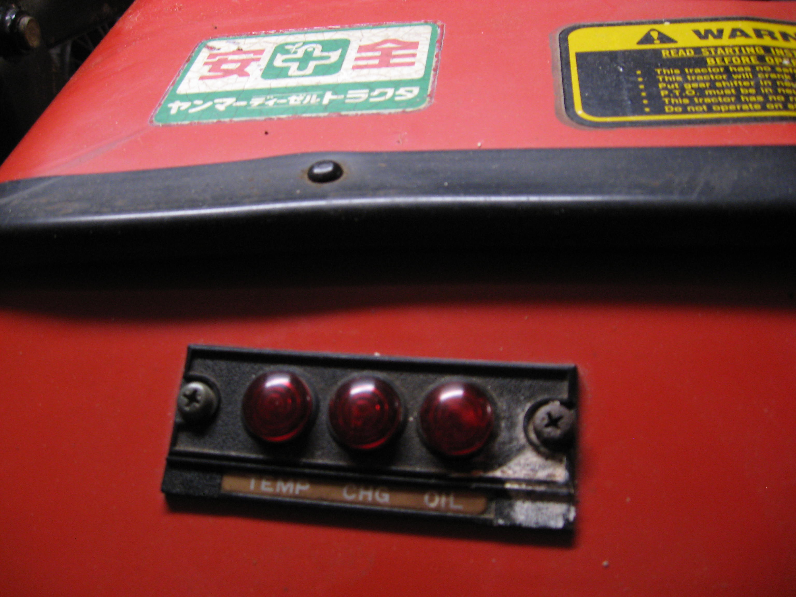

Who'd a thought the Japanese word for TEMP was TEMP;)? If you fill the rad completely, and fill the overflow bottle to the cold mark, when it reaches op temp the bottle should be 1-2" fuller, then recede back to cold mark after cool down. It takes a little ingenuity, but you can test those senders in boiling water, at least to assure it does not turn on at or below 212*.
   / Overheating #36
I dont think it is? That is strange though, just like the oil one says oil under it, i dont think thats oil either as well as charge or alt, whatever is written under that light. :laughing: These tractors seem a little old to use english as a universal language as i dont think it was as big in the 70s and 80s.
The strange thing is the original stickers have jap caracters on them but the lights are english? This is original cause everyone has them not just the VN owners. I guess it has something to do with the fact that they are sold all over?

Who'd a thought the Japanese word for TEMP was TEMP?
Well darn. Something is screwed up at flickr and they've made it so I can no longer post my pictures from there. Took s picture just for you guys. Humph.
My guess is the English labels were added by Corriher (Newton, NC) when they sold them. The casting for the shift has English numbers.

Okey dokey. (Well that's cool. I wondered how you did that.)
This is to illustrate my English TEMP label on my Japanese tractor. ;)
And my Japanese labels.
Just for fun.
(They stuck the appropriate English labels here and there.)
