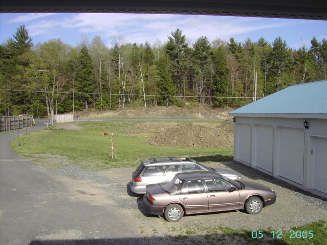

Does anybody know if a pond can be expanded to where it would run under the power line? I am thinking of doing this but haven't called the power co. yet and would like to get some input from some of you. Thanks. G

I know that my power comes across a pond before it gets here. It was done that way in the early 1950's. I don't know how it was done, and they have since added telephone and cable lines crossing the pond along with the power. I don't believe that it is much of a problem as long as the wires are in the air and you aren't in the water if they should ever fall. /forums/images/graemlins/grin.gif /forums/images/graemlins/grin.gif /forums/images/graemlins/grin.gif
   / Overhead power lines and pond... #3
are you talking about high tension lines or just like the service to your home or something like that. we have a set of high tension lines running thru our property, the power company has a right of way thru there, we own the land but they have the right to come in and work on the lines whenever they need to etc. there is restrictions as to what can be done on the right of way, no permanant structures, they must be able to get thru there access road and that sorta stuff. you would have to call them to find out what the deal is for a pond on the right of way, i would imagine it would be ok as long as it wasnt too close to the poles and they could still access the lines. one other thing to keep in mind is that very often there are ground wires running thru the ground under the lines to ground the top wire and other apparatus, these are not very deep usualy, i have snagged a few with the dozer taking out tree stumps and brush, and my father even hooked one with the brushog once so before you dig double check about that too
   / Overhead power lines and pond... #4
You generally can't put anything above ground level inside the jib line. The jib line being the distance from the tower or pole that the insulator stack can pivot over. Now I'd think a pond wouldn't get much above ground, unless there was a real hard freeze. /forums/images/graemlins/wink.gif
Thanks for the responses guys.
As for the lines, they are service lines and access to them is not a problem. I think it will be okay if I proceed. G

Decided to do it.

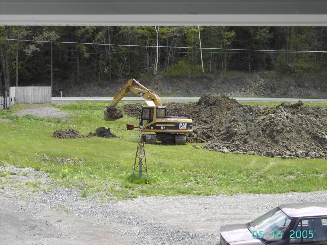

2
