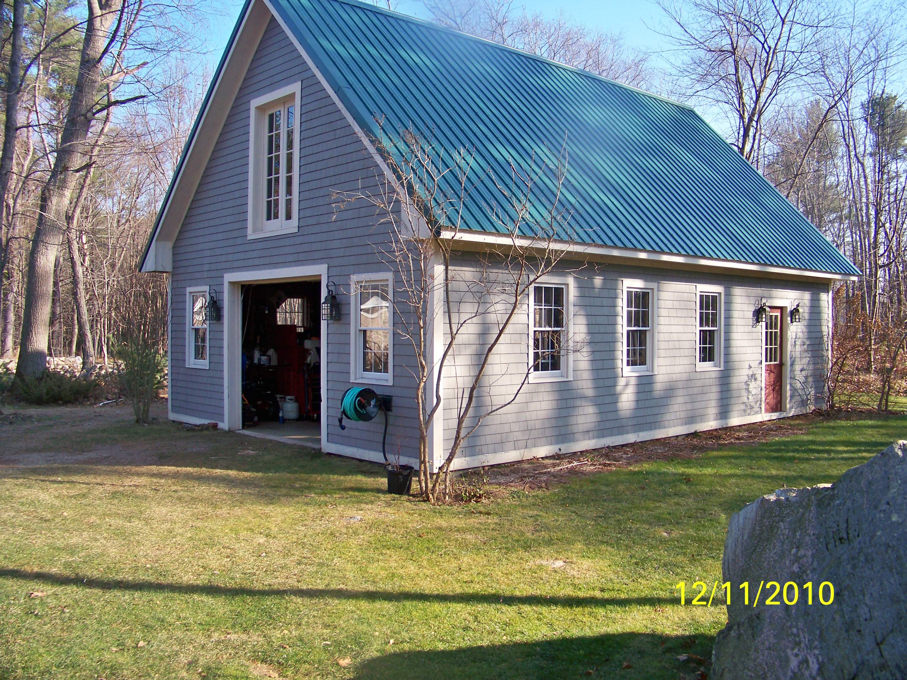

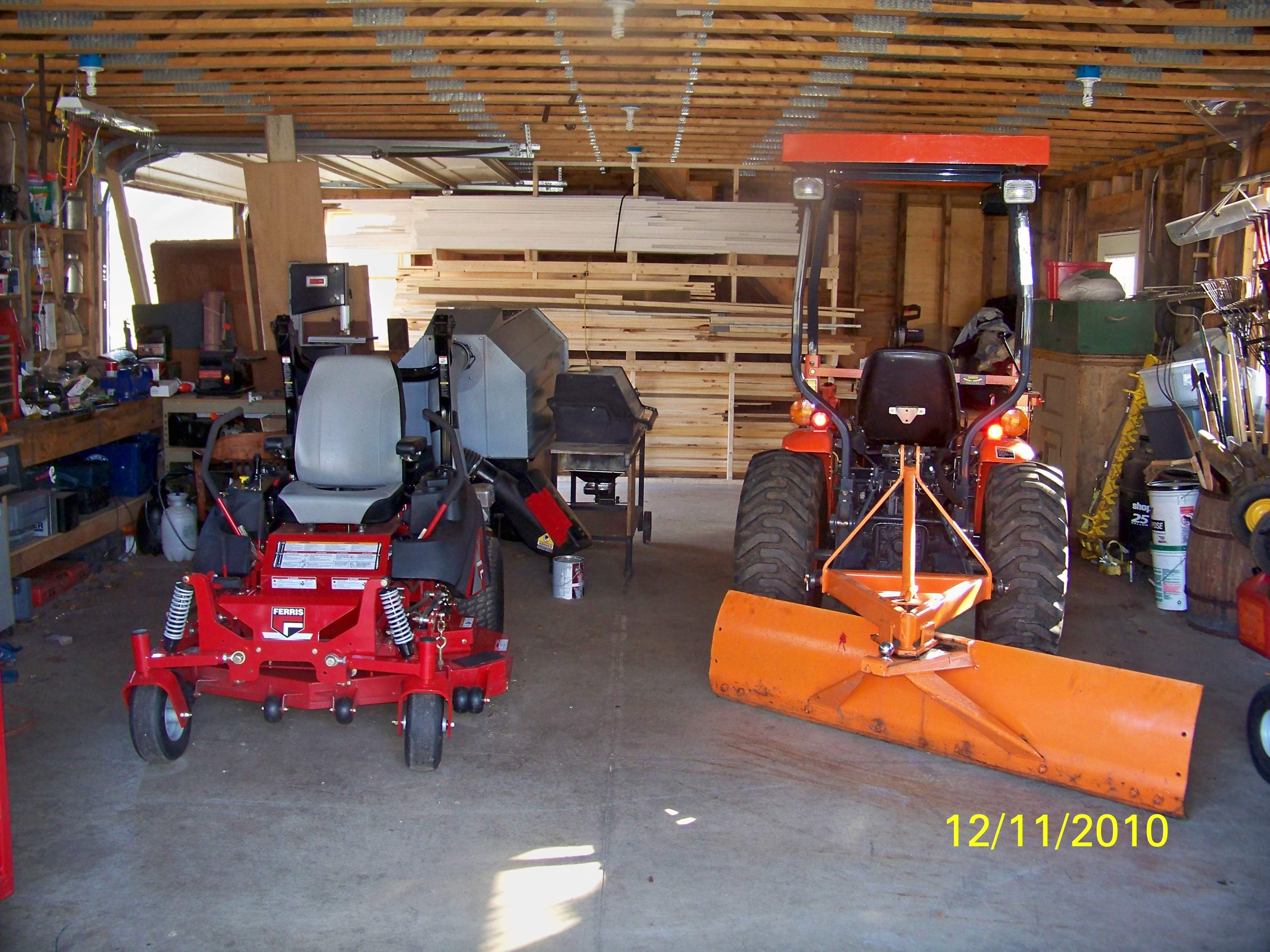

Put the 10' W door in the center of the gable - it will not look good other wise. Then put a 6' double door (in the side wall where you park the car) can pull your 425 or lo boy out thru those doors then park your car.
Or put the 16' door in the center so you have room for both truck pull in and tractor out (this would be my preference).
I have 24x36 barn with one 8' door in the gable end then another 8' door in the opposite side wall end. You are right the area directly in front of the center door is my "work area" since the tractor and other implements are left and right.
This works for me as this forces me to clean up each project as its done, and pick up all the nails and wood and put it away.
