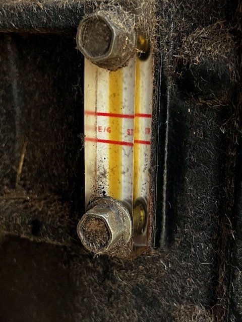

The attached photo is of my transmission sight gauge and I'm trying to determine if it's overfilled or is low. I don't remember if there's an interior tube within the square acrylic outer tube (or case) or if the golden trans fluid is supposed to fill the entire square case. I had a cylinder leak in a Bush Hog cylinder and knew I needed to add hydraulic fluid to the tractor to make up for it. I did so in very low light and never saw what I expected to see as fluid in the gauge. I stopped after adding 4 gals as I doubt that much leaked from the mower. The 100 hp tractor takes 21 gals so I have somewhat of a buffer. The low hydraulic level light never came on and the tractor didn't seem unhappy whether under or overfilled. Thanks for the help.

fluid level should be between red marks. It appears way over-full to me.
Use a clean drain pan, loosen drain plug, allow level to fall to top red mark, re-tighten drain plug.

Yup, there's a lag-time between adding oil and when the true level shows in the sight-glass.
I did that with 80W90 oil in wet hubs. Had to drain out about half the next day.

You can buy lubricant dye from John Deere or on Amazon to alleviate the issue. Problem with gross overfilling is it can compromise the seals and cause them to fail or begin leaking.

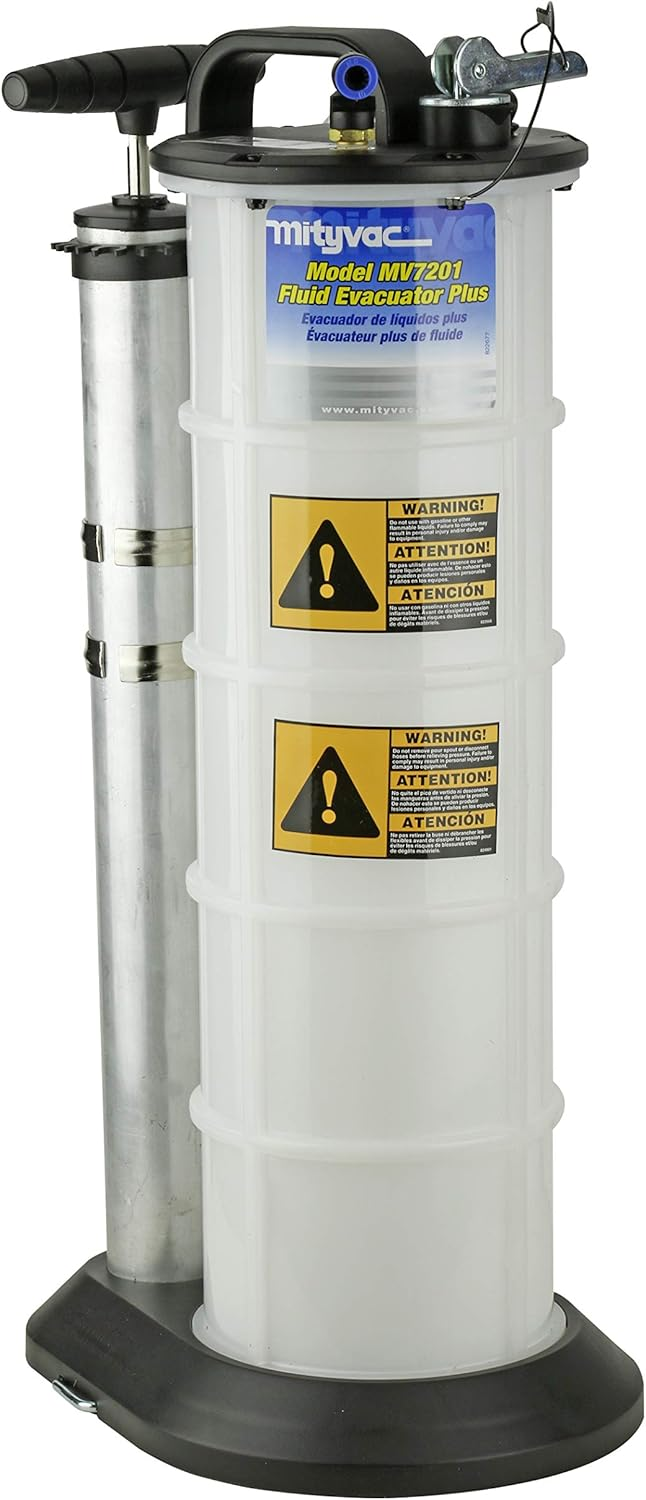

I use this oil extractor / dispenser to adjust the hyd. fluid level:
Just put the tube in the oil fill port and you can add or extract oil without using the drain plug. Makes it a snap to get the right oil level.
I also use it to change the hyd. oil. No worries about over filling a drain pan.

For tractor transmission sumps, there is very little down side to "overfilling".
All one needs do is pull a top plate sometime, look down at the bull gears, and observe that there is lots of room for fluid or air. As long as fluid is not spewing from fill or vent ports, I don't worry a bit about "too much". I try to be good, but I just don't care any more.
Now LOW fluid levels get me hopping!
