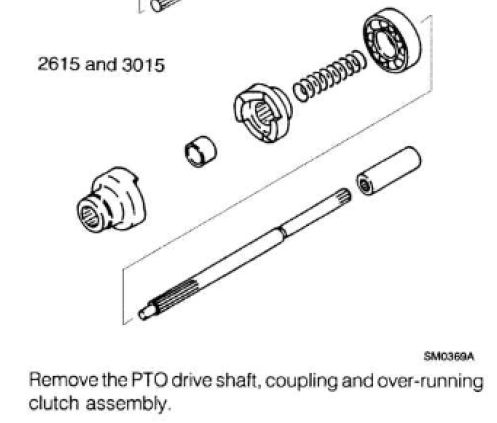

I use my Mahindra 3015 (30 HP wi hydrostat) quite a bit for roto-tilling and normally use the tractor clutch when engaging the mechanical PTO. I don't use the clutch for dis-engaging the PTO, however, but rather just move the PTO lever to the off position. The other day, for some reason, I pushed in the clutch to stop the tiller, and noticed a weird clunking noise in the transmission that sounded like some kind of over-running clutch as the tiller was coasting to a stop.
So did some testing by turning the roto-tiller manually with the engine off but the PTO engaged and was able to duplicate the noise.
So I ordered a PDF of the service manual for the tractor and sure enough, after some searching, found the section showing an over-running clutch inside the Mahindra transmission.
I've heard of over-running clutches in the external PTO driveline used on rotary mowers, for example, so that tractors with non-live PTO's would not be over driven while the PTO is coasting to a stop. An internal over-running clutch in the tractor, however, is a first for me and wondering what you guys might know about this and whether it is common especially in a hydrostat tractor.

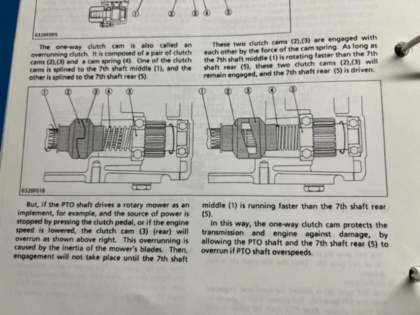

Very common in modern tractors. That would be the "dog ear" style, which is noisier but more durable.

Without an over running clutch, any PTO driven attachment with inertia will DRIVE the tractor even if the clutch is pressed or the transmission is in neutral. Snow blowers might be a useful example. I can tell you, when you are hoping to slow and stop forward progress by declutching around building and such, and the tractor just keeps driving forward , it's an unsettling sensation.
My old E27n Fordson is like that. Scary .. I put an over running clutch on the PTO stub after the first scare.
The Kubota B7200 has an internal over run clutch. That's a pretty old design. The Hurlimann has a two stage clutch, so no issues there. It also has a ground speed gearing for the PTO output which would send power to the wheels from any spinning implement.
If fitted with a hydrostatic transmission, I can see a BIG surprise to the operator if the tractor is driven along by inertia with the go pedal in neutral ... Whee Haa!
Not on any modern tractor with independent PTO.

With curiosity aroused, I checked the WSM for my Kubota B9200 HST and found this:
