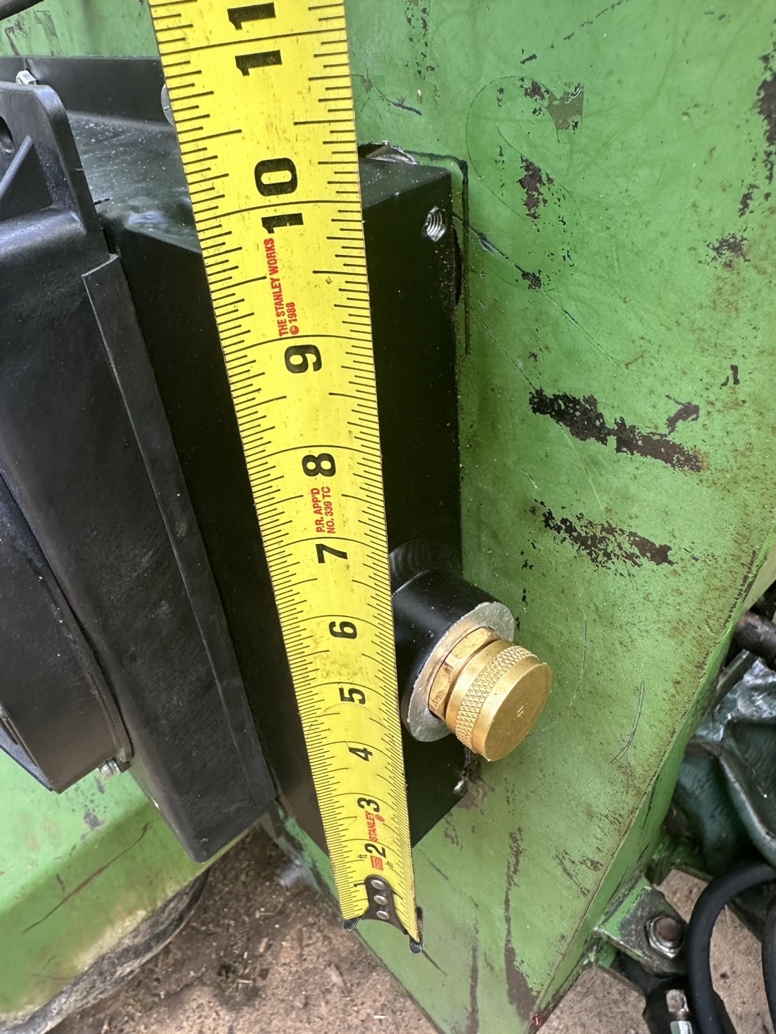

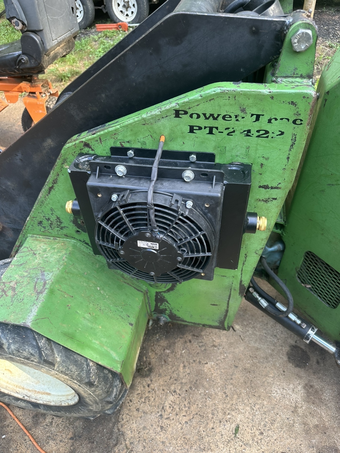

I just upgraded my oil coolerwith this one i bought on ebay. The difference is day and night, it made a BIG difference, my stump grinder isnt enemic anymore.
With putting the foam padding in and around the cowling of the engine my oil temp is running around 230 i will send pics of how i did the foam later.

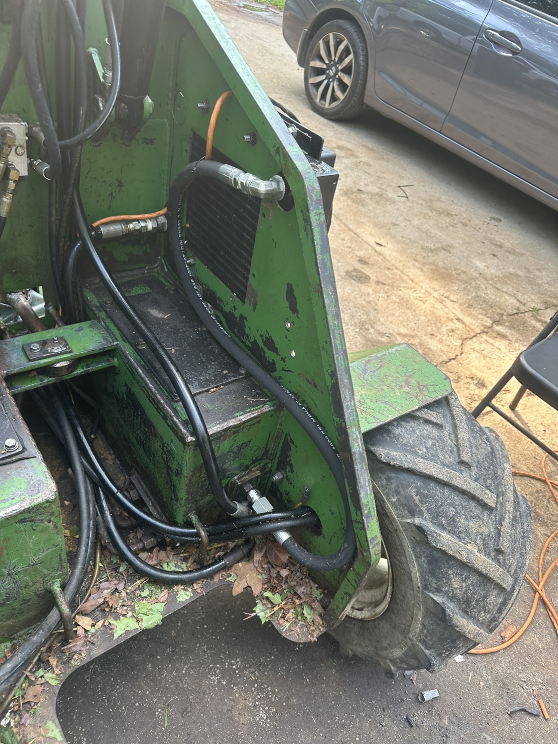

Here’s the pics of how i did the padding around my engineView attachment 873740View attachment 873741View attachment 873742View attachment 873743
Note where i blocked the air from flowing under the engine mount assembly that i am pointing out, also the last two pics are showing how I redirected the air flow from my oil cooler to the rear of motor. It was originally flowing upward and blowing across my fuel lines causing the vapor locking condition. I put the foam around the two sides of oil cooler to direct the hot air to the rear of the engine, eliminating the vapor locking.i am running walmart brand 15-40 in my hydraulics and synthetic 10-30 in my engine.

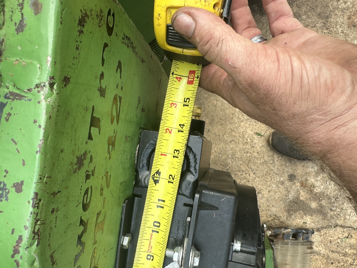

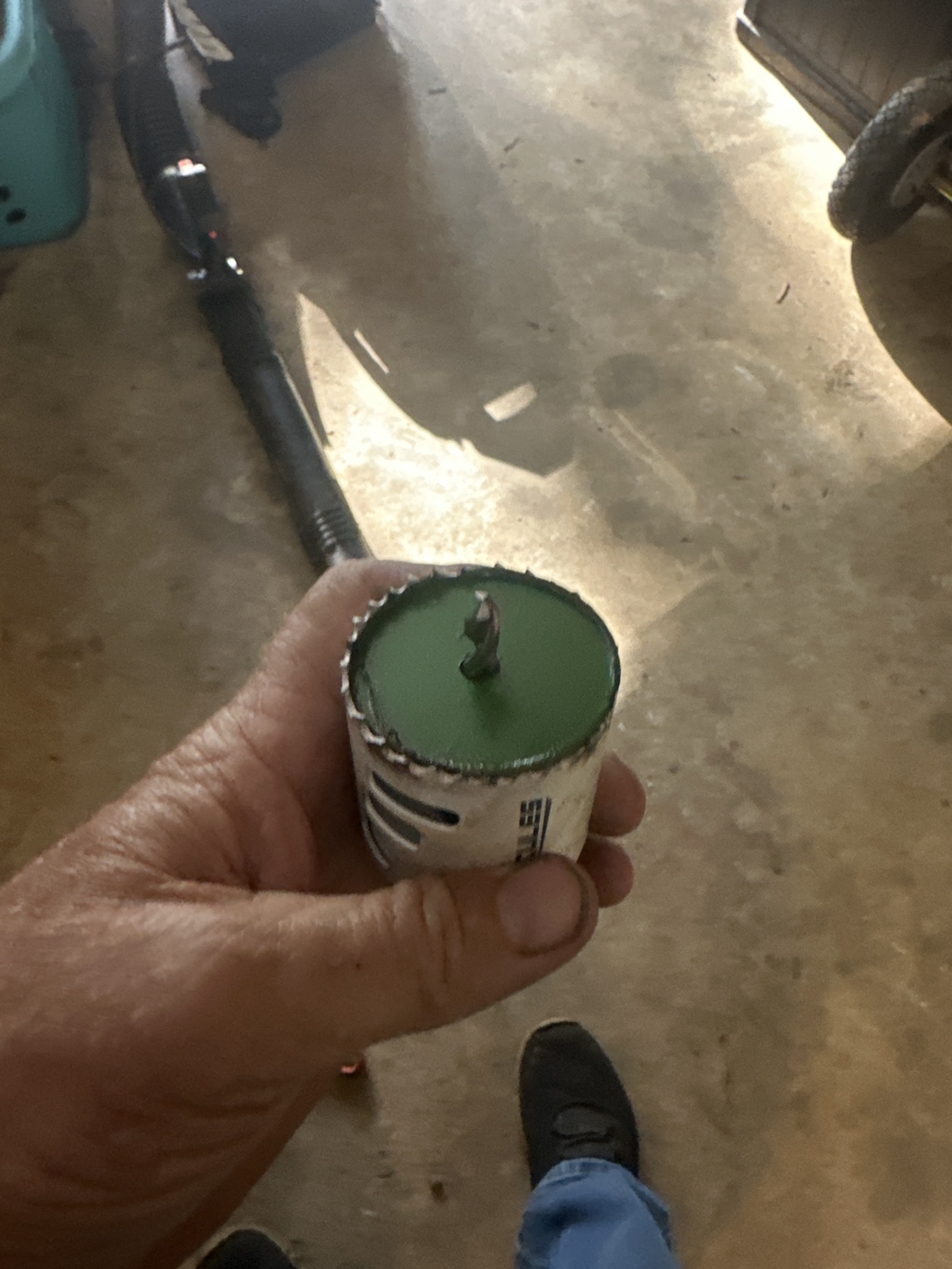

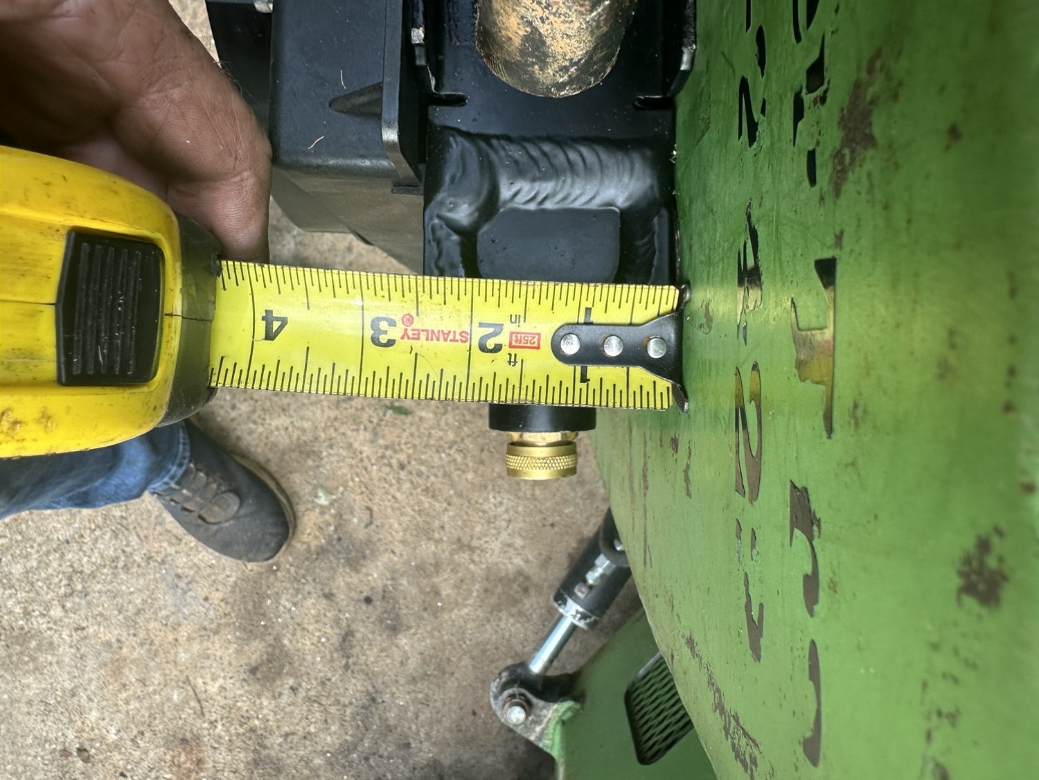

Tchamp, how did you cut the hole for the new cooler so neatly?
   / Over heating and vapor locking
#9
Pictures open for me.
I used a 2 inch hole saw to cut through the metal from harbor freight
