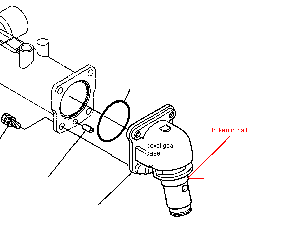

Will overfilling font axle on B-7500 blow the seal ? Dealer replaced front seal and charged for 2 gals gear oil. Manual calls for 3.4 qts. Ran for two hours, wheel locked up. Checked front axle and all oil had run out.

How about releasing the vent/ overfill bolts and then you will know that you are exactly full? Does your machine not have them? I release mine and fill with oil until it comes out of vent holes. Should be 1 one on each side of axle, and make sure it comes out both holes cause the oil may take longer to get to one side as the fill port is usually on the drivers side of axle. Hope it helps.

Turns out that the bottom section of the bevel gear case on the front left was broken in half. Dealer had never seen this before... Had to replace gear, seals , bearings. 600 bucks. Anyone ever seen this ?

Mine. They replaced the housing, shaft, bearings, seal.

No, It's a 2002 with 720 hrs. Dealer said Kubota rep came in and took pics of the broken housing, as he had never seen one broken in that place before.
   / Over filling front axle #10
Could have been a bad cast, rare but happens. I think Kubota should have maybe helped you out with this! A cast iron part on an axle should not snap in half. Do you maybe drop the front end hard sometimes when using the loader?
