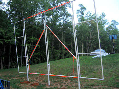

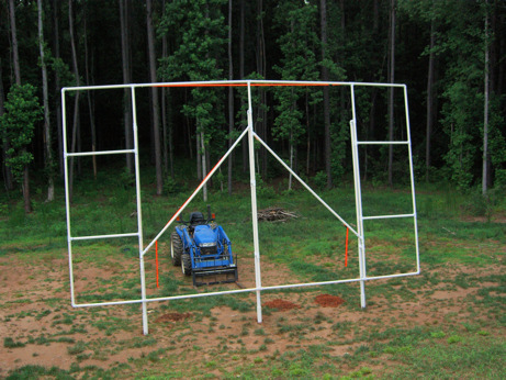

Thought I'd share a couple of photos of a little project I have going - an outdoor movie theater. The pics are "progress" photos of where things stand as of tonight. I have constructed the frame of the screen with PVC pipe. I've set it in the holes - now waiting to get some Quickrete to set the pipes in the ground. This is a modular screen frame. The orange ratchet straps kind of hold it together. The two end sections (with the horizontal braces) are glued together. The top and bottom horizontal pieces and the 2 diagonal braces connect the end sections to the center post. When disassembled, the whole thing comes out of the ground and the ingrond posts will be covered with valve box enclosures.
We still have to sew up the screen fabric. It will have grommets around the border abd will be attached to the frame with bungee cords.
I have an lcd projector that's been sitting around for awhile (my wife uses it 4-5 times a year) that I'll hook up a dvd player to. Add sound from an old unused stereo and "viola!" instant drive in movie.
BTW, the screen is 24' wide by 14' high - big monster. Also, the tractor in the picture was not used in the frame construction.

Pretty cool idea!! I like that part that you can remove it when not in use.
If this idea doesn't work out for you, maybe something like a tennis net design. Two strong poles with wires going off the tops and anchoring on the sides. Then all you have is the poles to deal with for storage.
I bet this will be one of those things that your kids will remember forever!!!

Eddie - What do you mean "If this design doesn't work out..."? It Has to work out!!! Now, as it is a design "by-the-seat-of-my-pants" project, there may be a few modifications along the way. And, if by chance the final product resembles a tennis net, then that will be purely coincidental.:D
I'm sure the kids (and I) will enjoy it once we get it finished. I'm just hoping that no one gets hurt in the process. This thing is huge and heavy.
