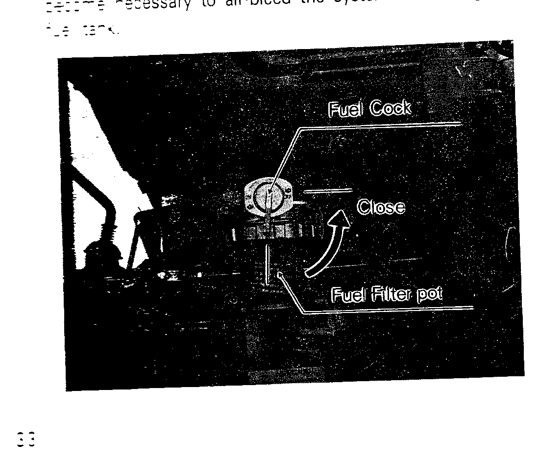

   / Out of fuel DK45s #8
OK another picture attached - poor quality but you can see it. Like Chip said, the petcock needs to be bled first. It is right above the fuel filter bowl and it will be marked with positions for Off, On & Air. Follow the instructions on my previous posting.
If that doesn't work, follow the next recommended procedure (also in my previous posting) which involves opening the vent cock above the round fuel pump (pix in my other posting is clear). Still no luck? proceed to the dreaded cracking open of all the lines - not all that difficult but messy and a PITA.
