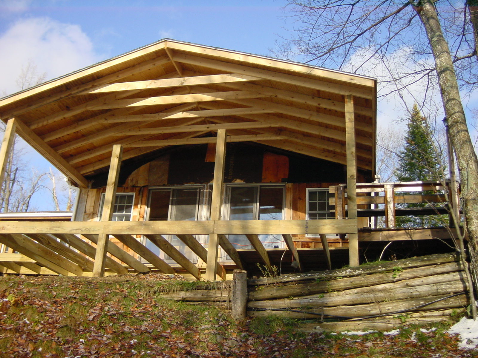

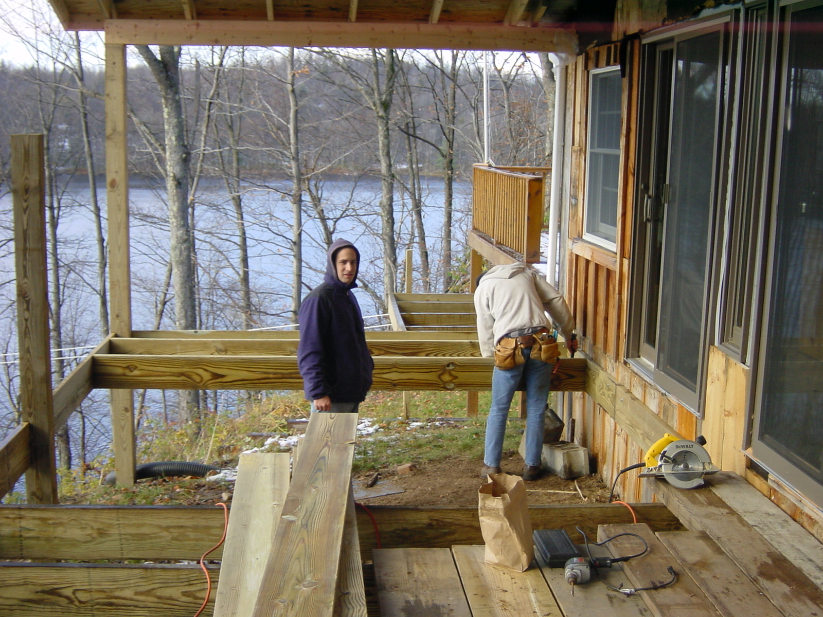

When we started our new porch at camp we went ahead and used 2x10 (16 on center). Support post were 6x6x16 and 6x6x12's a bear to handle. We sunk the 6x6 post 4 feet into the ground.
When we did the roof we selected 2x8x14 and the collar ties are 2x8x12, cut to fit! The location of the deck / porch faces north / northwest and we do get some pretty heavy winds and most of the storms come in from the northwest so we went a bit heavy on the structure.
We did the work this past fall right up into December and then it was just too cold and we were worried about the snow coming so we put the finish off until spring. Going up in two weeks to check thinks out and start working.
Prepare your BOM and do it with different lumber 2x8's and then with 2x10" so you can get a feel for what the over-all cost will be to increase the lumber size. The deck will be there a long time so it is worth putting in the extra lumber.
Just my thoughts

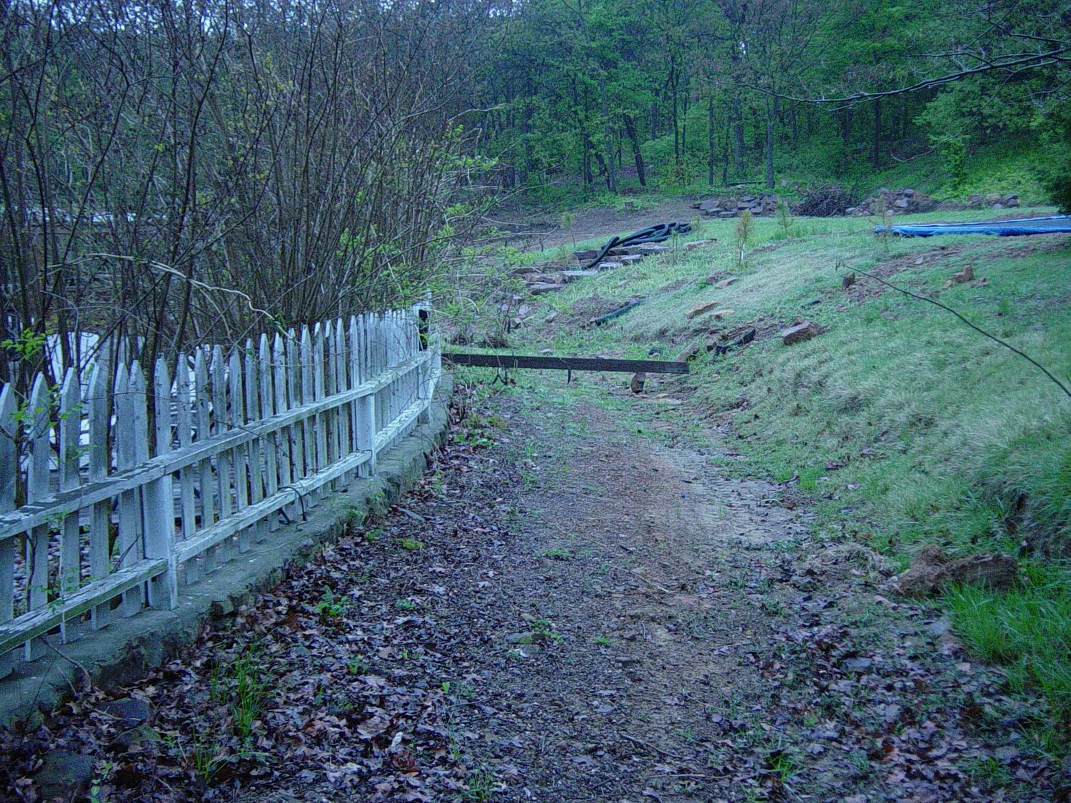

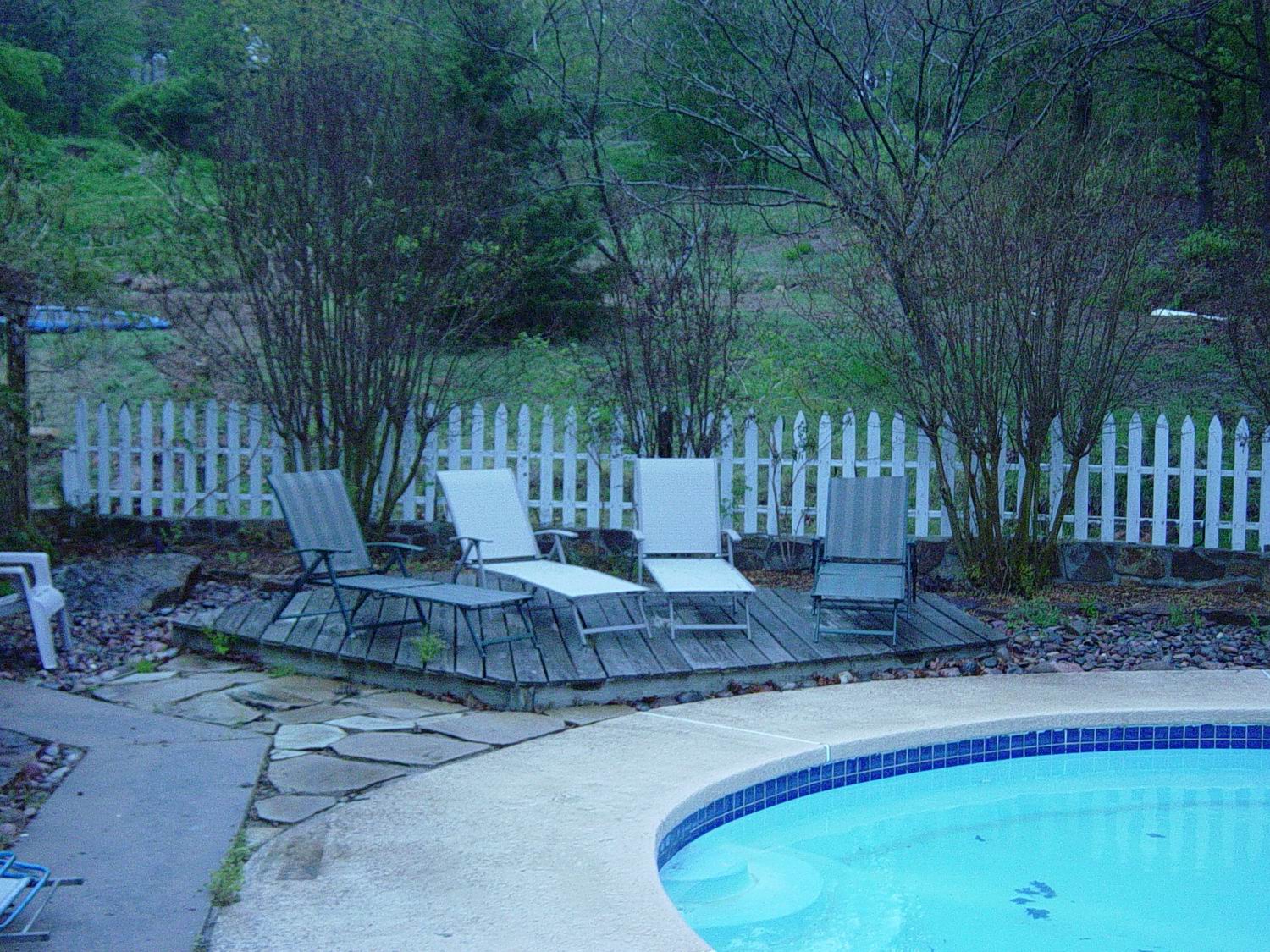

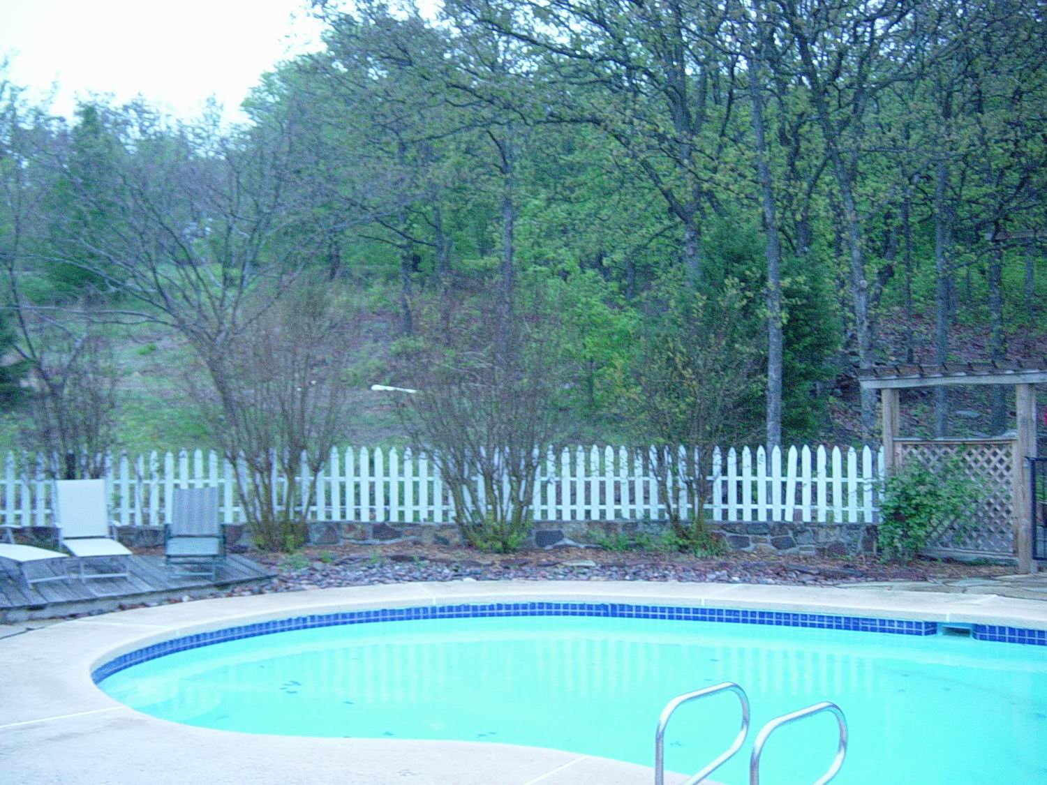

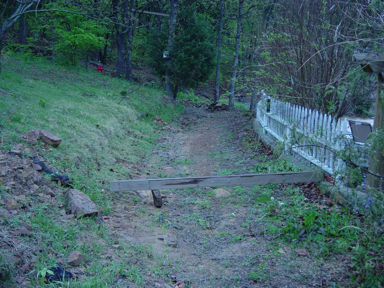

ok guys here is the spot
the fence and the deck thats there i did not build!!!!!!o!
the deck will look like it is setting on top of the unsightly wall and the fence will be gone
as you can see from the pics the spot is kind of awkward, there is exactly 12 feet from the front of the wall to the hill
i could actually set my post where they would hardly ever be in the water by moving them out twords the ends. if i can canterleaver 2 feet then that leaves the largest span between post at 8 feet, that seems like a big span to me.
did i also mention the wall has a curve to it and so does the hill, thats why i was going to run the decking the 12' way instead of the 43 foot way plus the far end is longer than 12' due to the wall turns in alot

Thanks for the pictures, they help allot. I'm still a little confused on what you're goal is. Is this deck for entertaining around the pool? Sort of a nice place to set up tables, and relax?
When I looked at your pictures, I imediatly saw a perfect location for concrete patio pavers. The wood deck sort of seemed forced and out of place to me, but pavers really jumped out at me. I saw them coming off of the edge of the concrete around the pool, through the existing wood deck and out past the trees/shrub that you have there now. I'd either remove them, or take one out and build around the other.
Pavers are very simple to install and when you are done, they will be there forever. They cut real easy with a masonary bit in any power saw and you can do as little or as much as you want. Nothing wrong with doing a small area this year, then adding to it next year.
Anyway, that's just an idea that hit me.
With your drainage and water issues, the sono tubes should be mandatory. I wouldn't even mess with wood posts with as short a rise as you have, just pour the concrete up to the point your joists need to be and attach them directly to the concrete. You can also drill your holes in the ground and put rebar in them so it extends up past the hole to just below the height you need them to be. Then slide cinder blocks over the rebar and fill the cavities with concrete. You will have permeanent posts that will never rot and be imune to the water. Just be sure you measure your height first so the cinder blocks line up at the right point. There is no need to morter the blocks when you fill them with concrete for this.

the deck that is there will be gone along with the fence and crepe myrtle things. i hate all 3 !!! the old man that lived here built the deck using nails, so you can imagine im out there every 2 weeks knocking them back in so someones toe does get ripped open.
as for the concrete pavers good idea but no, i have used natural stone everywhere i can around here, i have a friend who owns several rock quarries and where i can get smooth stone for walks. my yard is full of sandstone that work great for building walls.
sonna tube yup think im going that route or something close to it.
