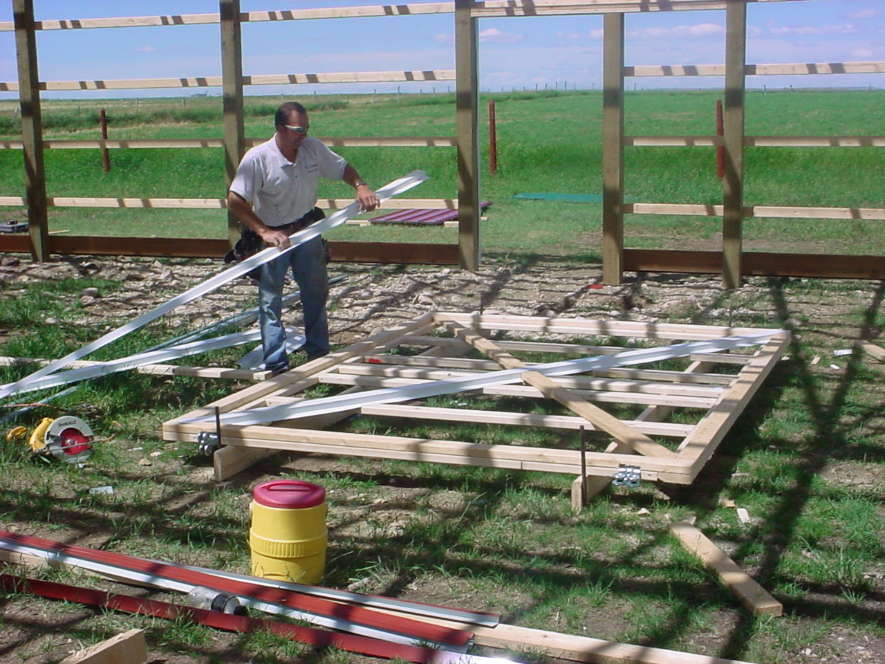

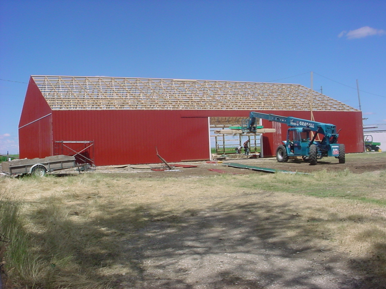

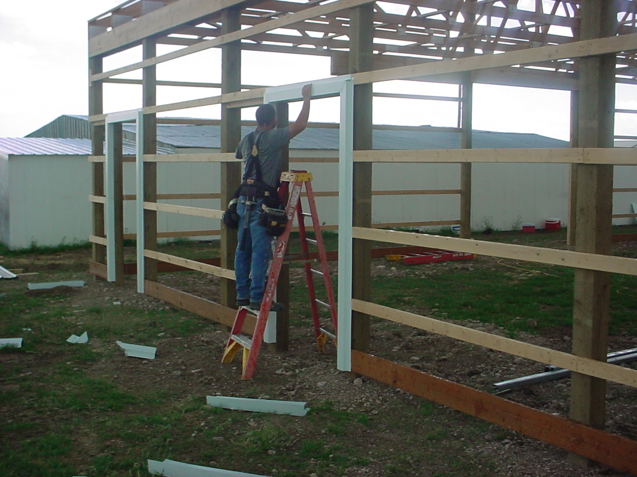

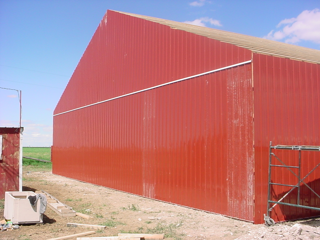

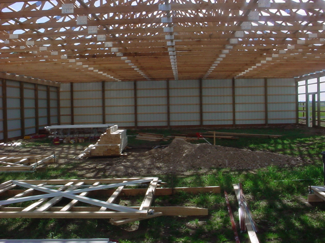

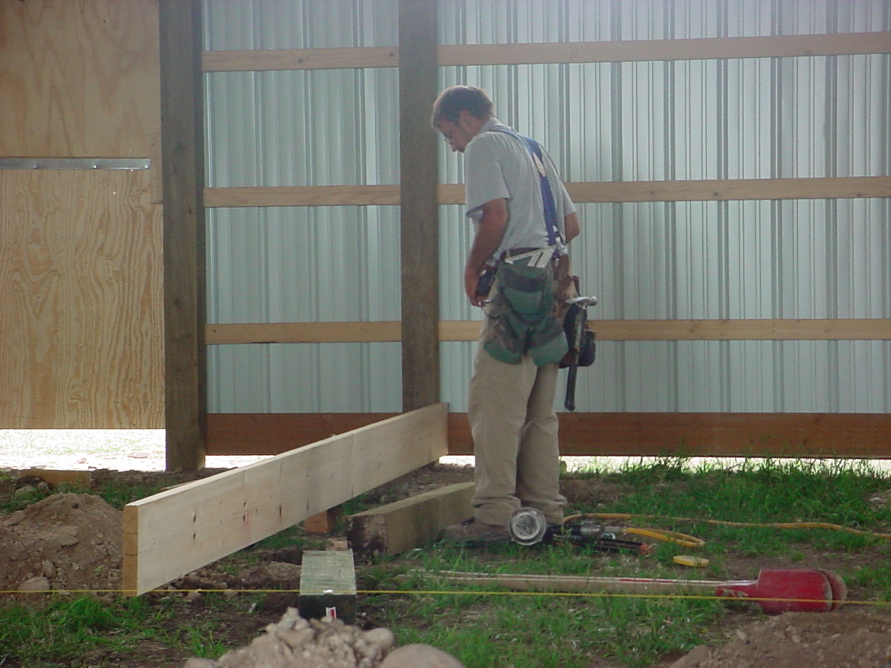

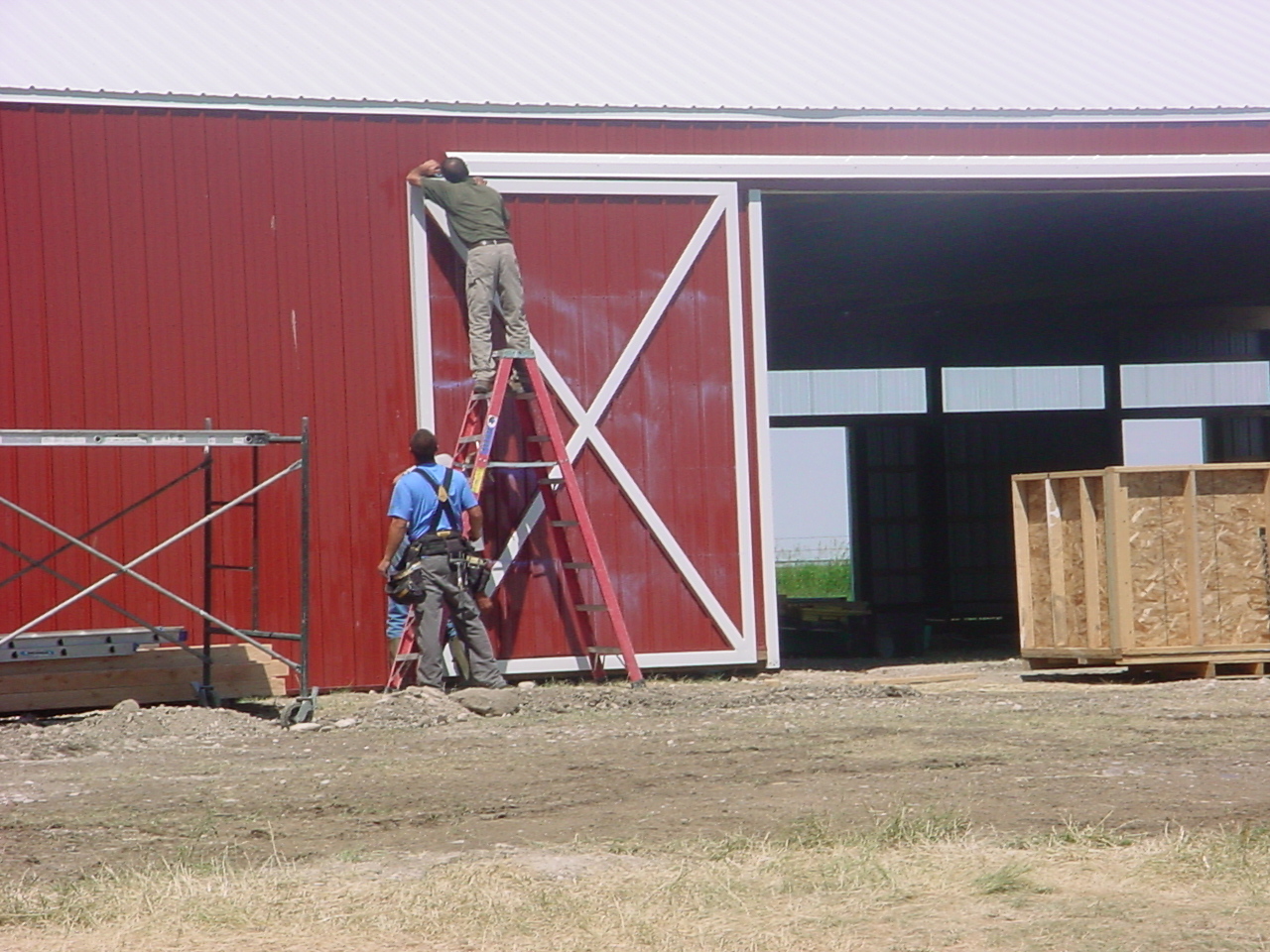

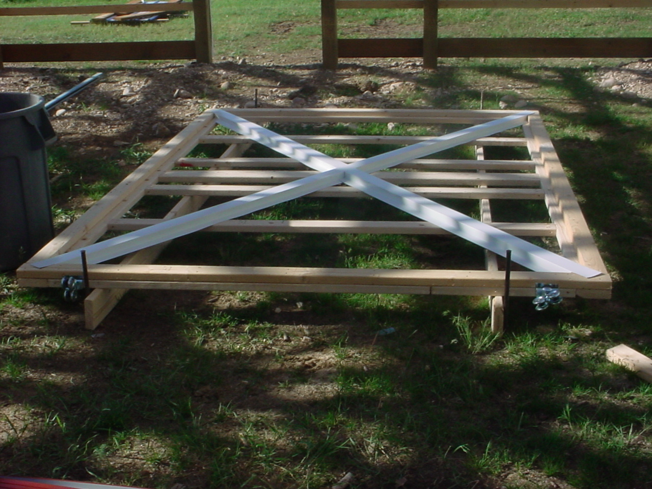

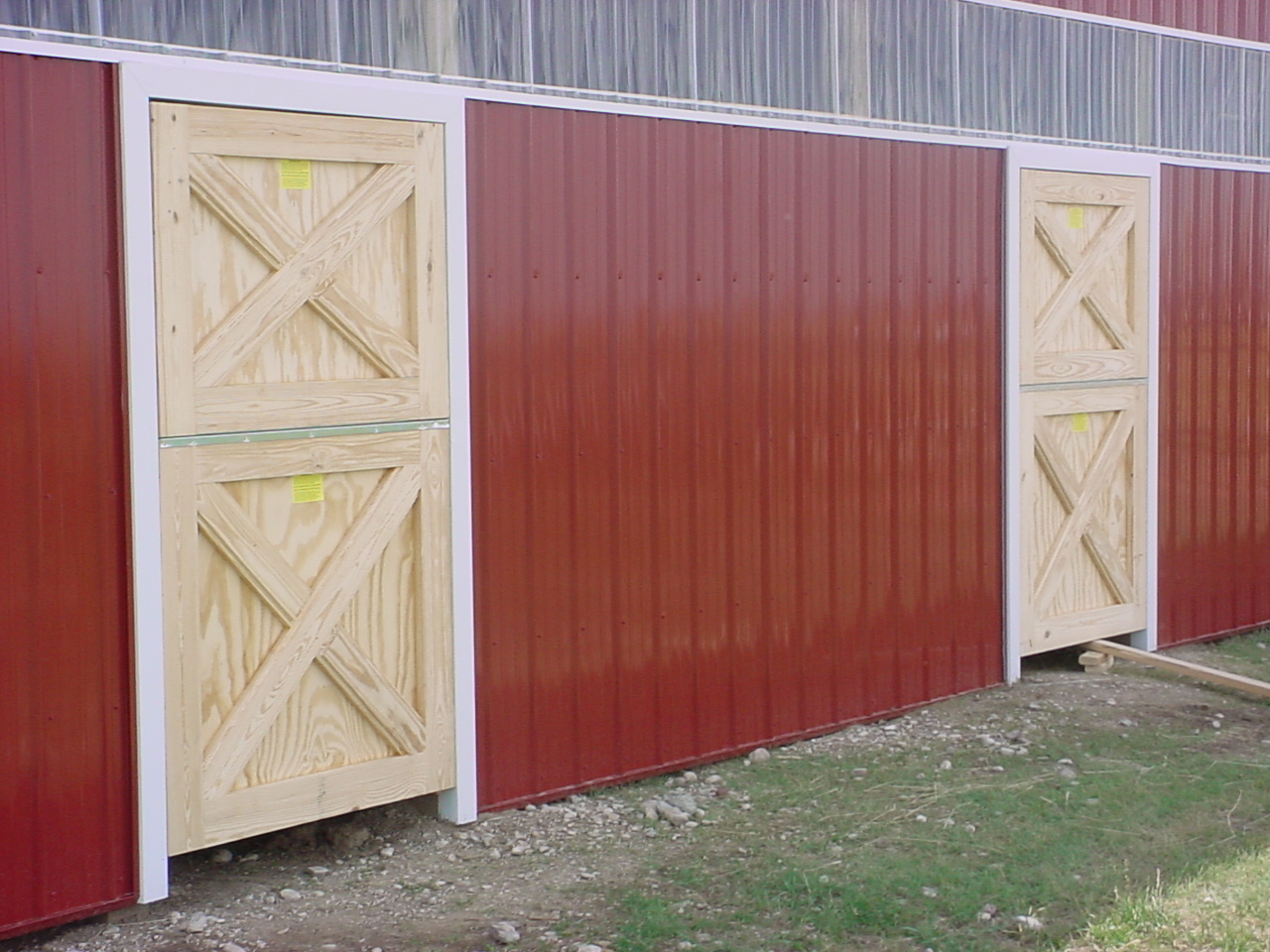

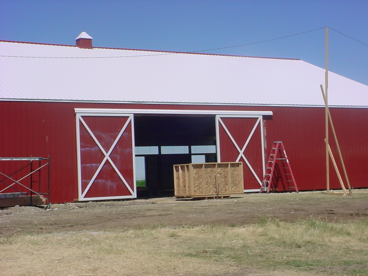

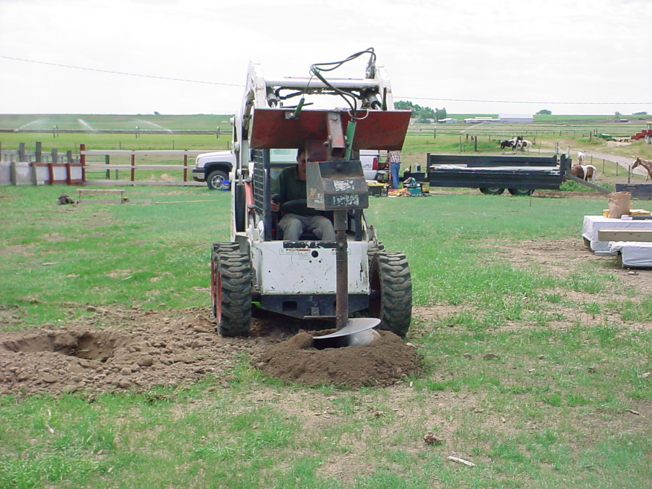

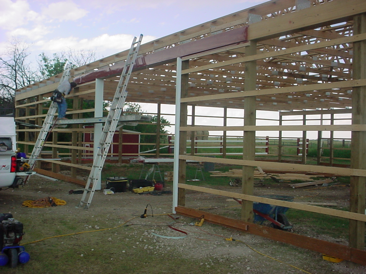

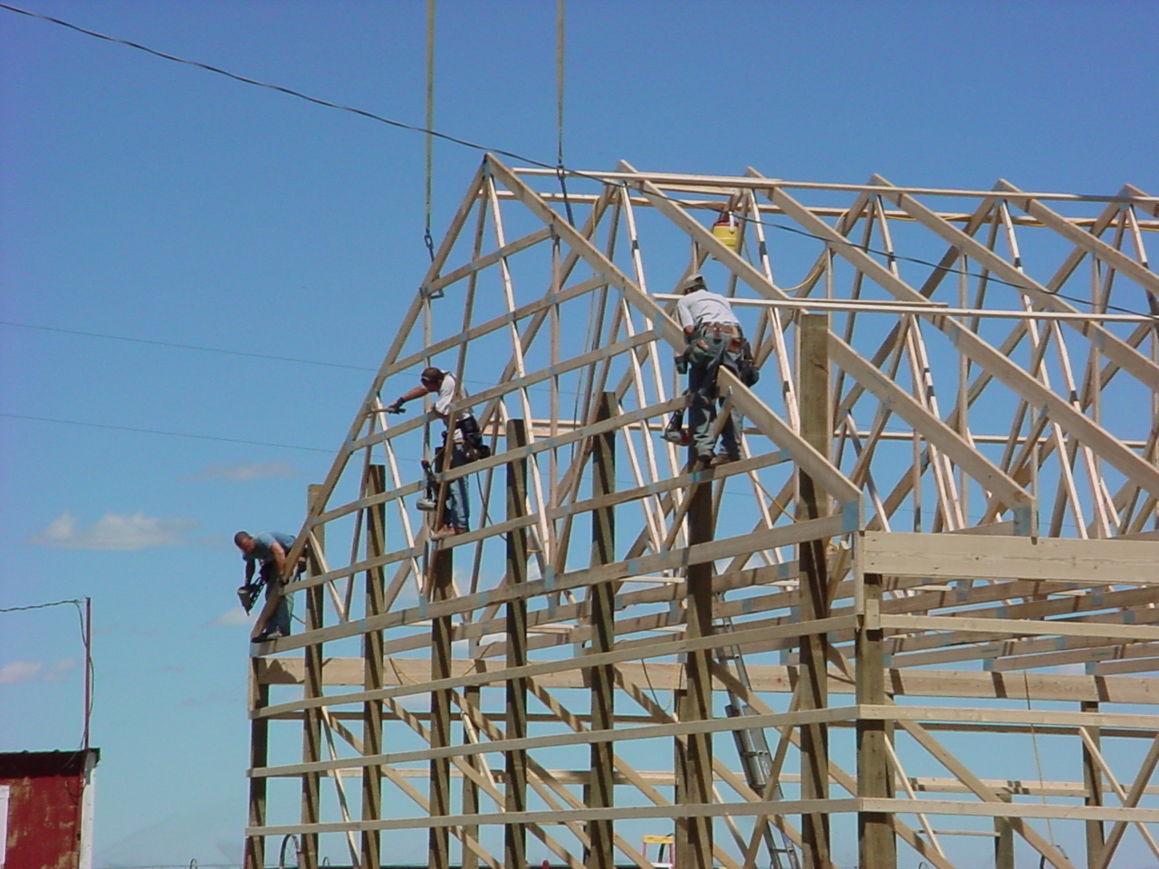

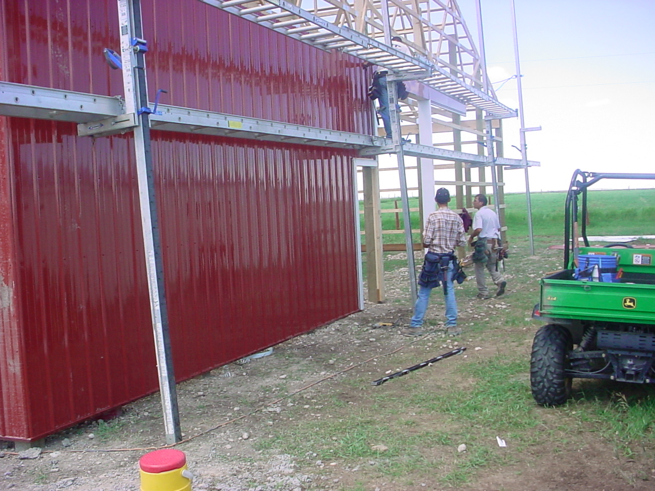

This is our new barn. Almost done now. It is 90' X 65' and it will have 5 stalls, tack room & lots of hay storage. I have many pics to share so I am going do this in parts. So here's part 1, Enjoy Guys! :thumbsup:

The skies really are bluer in MT. Barn is great, like the classic red color. Surprised you used hinged stall doors there, I'd think the snow would make them non-functional in the winter. We don't get as much as you do and we can never get the doors open until I plow.

I really like the daylight siding on the one side. That should really make your activities easier to see. If I ever need to redo ours, I'm thinking that would be a great addition.

i built a 40x8-0 almost entirely by myself and wife..liittle help from my brother with the trusses and the crane..but
anyways what i could never get right was the tinwork...no matter what it was never straight..square with the building...even the siding with a level and lasered it still didnt line up even at the top and btm..like it was hanging slightly sideways
its close enough so no one notices but..ya know..i know its crooked

Actually, with barn metal it is wider on one end than the other. So it will go crooked if you don't cheat it. We usually put the first sheet up and from then on we will measure where each and every sheet will go to ensure it is straight. It is not easy though.
