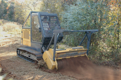

That is why I am trying every machine that I can. I have changed my demo on the Barko to the 190hp Prentice. I do not think that I need 305hp for what I am grinding out here. If I can cut as much or more with 140hp than I can with 300hp and save almost $200k up front and $160 per day in fuel. Even my little brain knows what to do here. I am very confident that for my work out here 2 machines will grind 3 acres per hour. I am also looking at a Kodiak 160hp machine. This seems to be a good happy medium, it runs a 160hp Cummins through a PTO drive. As we all know a PTO is about 20% more efficient than hydraulic so it should run like a 200hp hydraulic machine...we'll see I guess.

They do not seem to be interested in keeping the web site up to date. It is a new machine...hopefully I will get some literature and get it posted. I do not have any pictures of the ST running since I was the only one running it. I will try to remember to get some of the dead teeth.
   / Our Lesson For Today is Overkill
Pictures of the 160hp Kodiak.

I like the thought of that Kodiak. When I sell ASV #2, I will be looking for a larger machine to replace it, but nothing as big as that SK300. I like the looks of that FTX148, but I don't like Fecon.
